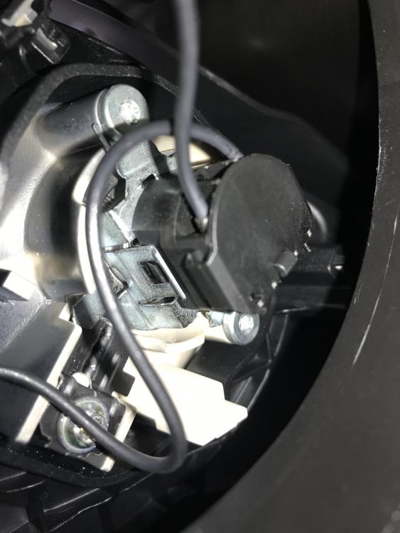

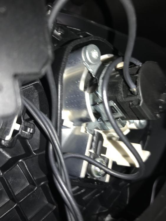

Hi need a bit of help. Trying to replace my driver side dipped beam bulb. Handbook says turn anti clockwise. However it just won’t budge. Any tips. Photos added of the holder.

Hi never come across one like that but half a brain would suggest it won't twist out, looking at the pictures my plan of attack would be loosen the top torx screw above the bulb holder and remove the bottom torx screw and it looks like the whole unit pulls out with the bulb attached I think on the bulb side its just push fit, no drama, you will need a good quality 1/4 socket set with torx bits, just be gentle with it.
