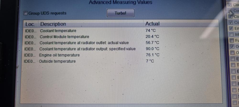

I have also tested the sensor using VCDS and after a 30 min journey the temp is sat at 74c at the sensor and 56c at the radiator.
Can anybody suggest what else I can try please? Fuel economy has dropped and I fear a lack of heat may interrupt the regen process.

I've not heard of a cylinder head temp sensor before. I assume this is different from the sensor I'm testing on the VCDS screenshot? The new thermostat and housing didn't have a sensor on it. Can you elaborate more on this sensor and I'll have a look on VCDS.

Hi, if the ECT is not on the thermostat housing it will be nearby the thermostat somewhere I am not familiar with that particular engine but the principles are the same, yes that is the right coolant sensor you are reading on VCDS and the clue lies in the sensor reading VS the realtime radiator temp reading the sensor reads higher but not high enough so the PCM thinks the engine is cold all the time and will step up the fueling to try and warm up but if the coolant sensor will only go as far as 74c the engine will think its cold all the time, they work on the principle of the temp of the water gets higher the resistance in the sensor will lower itself until it reaches the prescribed temp, also some of the engines are fitted with dual thermostats, if you pm me your vin I will look on my parts system.
