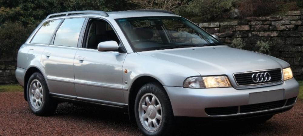

Hi steve thanks for reply.i was there when my mecanic did the job  he,s done my cars for yrs .no we changed the filter.andScreenshot_20220304-140557_Gallery.thumb.jpg.c9ba6acf7eaf62bef5a5707b3000e51d.jpg we emptyed oil out let it drip overnight then refiled new oil and filter run till hot run through all gears while up on ramp then re dropped the oil after a hr o so re filled with oil and another new filter. Hive loaded pic of car taken a few week ago try to show pic of oil that came out but it wont load it.
