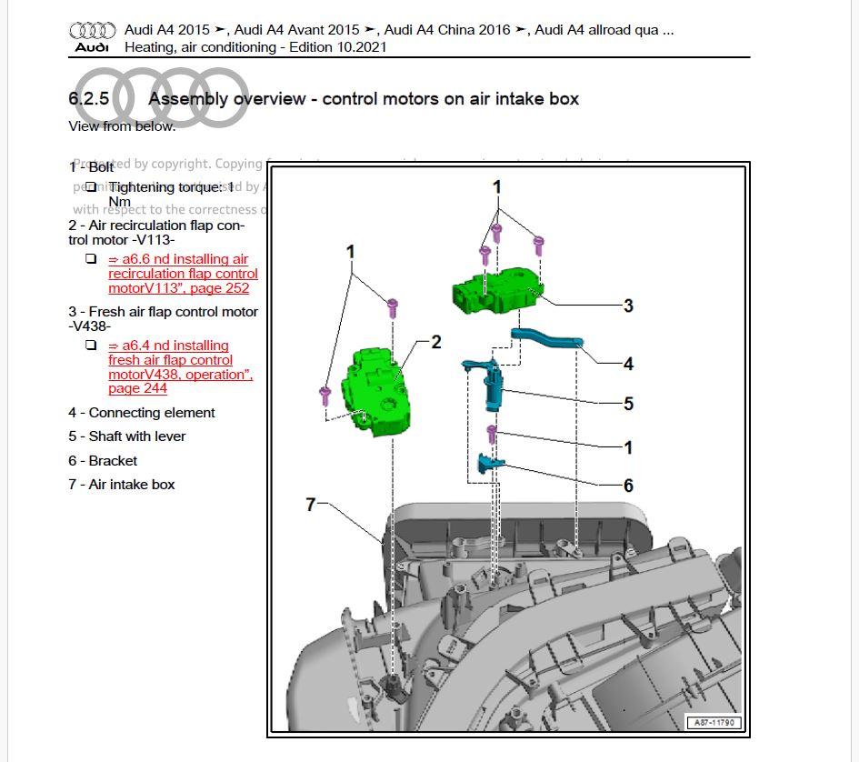

Mark9918 Posted August 4, 2022 Posted August 4, 2022 Got an issue with the recirculation flap motor which seems to have failed. Does anyone have a link to the manual for the locations in the b9? Possibly behind the glove box. For future reference for others the air conditioning works when max AC is on but fails when moved to come through front vents. Where it can be heard circulating behind the dash.
jdragon Posted August 16, 2022 Posted August 16, 2022 This could help. I'd say it's in exactly the same place as the attached manual extract

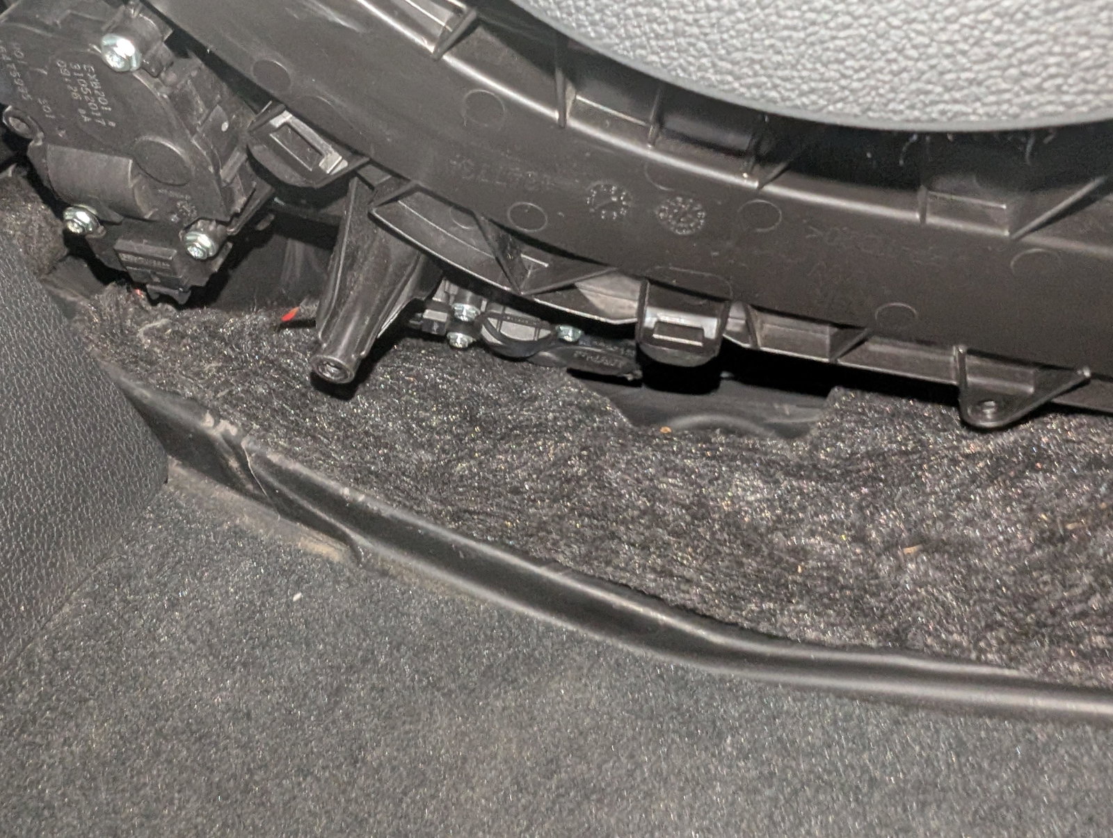

jdragon Posted August 25, 2024 Posted August 25, 2024 (edited) @wanleg They are under your glovebox. The recirculation flap motor (2) is on the left, the fresh air flap motor (3) is at the back; you can see some arms connected to this one. In my case, at least, it was (2). After removing the cover under the glovebox, the motor is fastened with 3x torx screws. You will however need someone with VCDS to run the basic settings after fitting the new motor. Unfortunately, the distance from Hartlepool to me probably doesn't make it very economical for my help with this 🙂 Edited August 25, 2024 by jdragon added wanleg 2 1

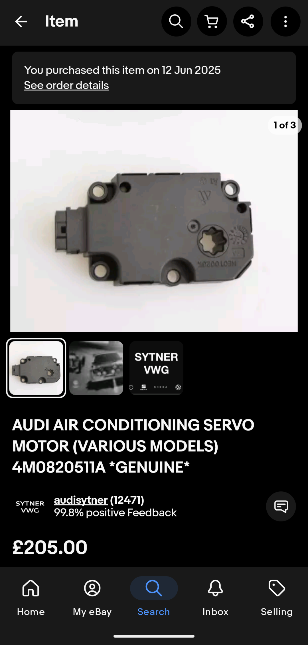

figo_rulz11 Posted June 11 Posted June 11 On 8/25/2024 at 9:54 PM, jdragon said: @wanleg They are under your glovebox. The recirculation flap motor (2) is on the left, the fresh air flap motor (3) is at the back; you can see some arms connected to this one. In my case, at least, it was (2). After removing the cover under the glovebox, the motor is fastened with 3x torx screws. You will however need someone with VCDS to run the basic settings after fitting the new motor. Unfortunately, the distance from Hartlepool to me probably doesn't make it very economical for my help with this 🙂 I think the same thing has happened on my Audi A4 b9 2017. It looks easy enough to replace but not sure if it's recirculation or fresh air control motor. I need to find someone with VDCS who can do it for me, don't suppose you're near Northampton way by any chance? Do you know the part number?

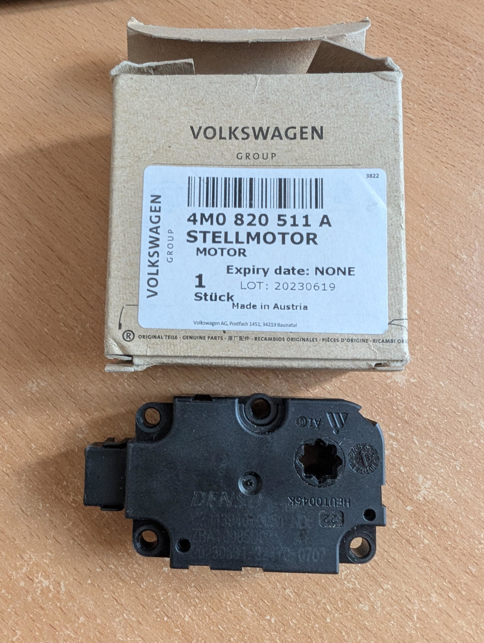

figo_rulz11 Posted 9 hours ago Posted 9 hours ago On 6/11/2025 at 8:18 PM, figo_rulz11 said: I think the same thing has happened on my Audi A4 b9 2017. It looks easy enough to replace but not sure if it's recirculation or fresh air control motor. I need to find someone with VDCS who can do it for me, don't suppose you're near Northampton way by any chance? Do you know the part number? Update: ordered the part £208 and found garage who has VDCS and they programmed the new motor module, just in time for the hot weather! Ice cold AC in all directions 👍🏽 1
wanleg Posted 8 hours ago Posted 8 hours ago 46 minutes ago, figo_rulz11 said: Update: ordered the part £208 and found garage who has VDCS and they programmed the new motor module, just in time for the hot weather! Ice cold AC in all directions 👍🏽 Did you fit the the part yourself? If so, was it easy?
figo_rulz11 Posted 7 hours ago Posted 7 hours ago (edited) 51 minutes ago, wanleg said: Did you fit the the part yourself? If so, was it easy? Not sure if YouTube link works above but this will help, it's literally under the glovebox behind the pollen filter towards left, like three screws and pull the connector and replace. I did that myself and just got the garage to program it like in the YouTube video. Edited 7 hours ago by figo_rulz11
