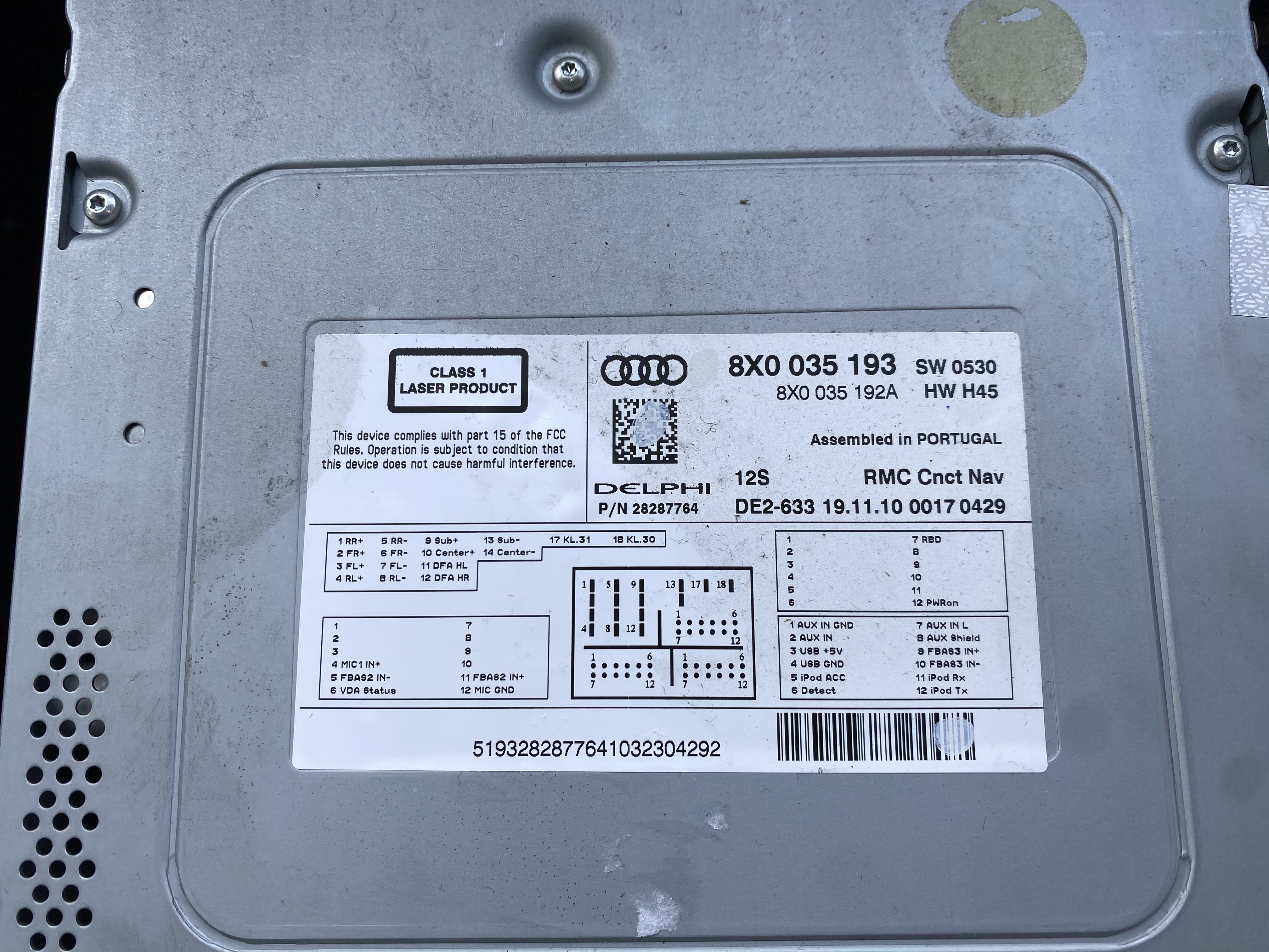

This happened a couple of times trying to get the thing to power up,  now it refuses to turn on at all.   In all other respects the car starts and drives normally, but the radio panel and dash display are now blank and won't turn on at all.   I have noticed what sounds like a fan running on the right hand side of the RMC unit so I assume it has power.   Picture of the unit it attached - I believe it is the basic RMC Cnct Nav unit.

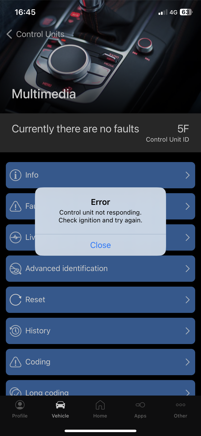

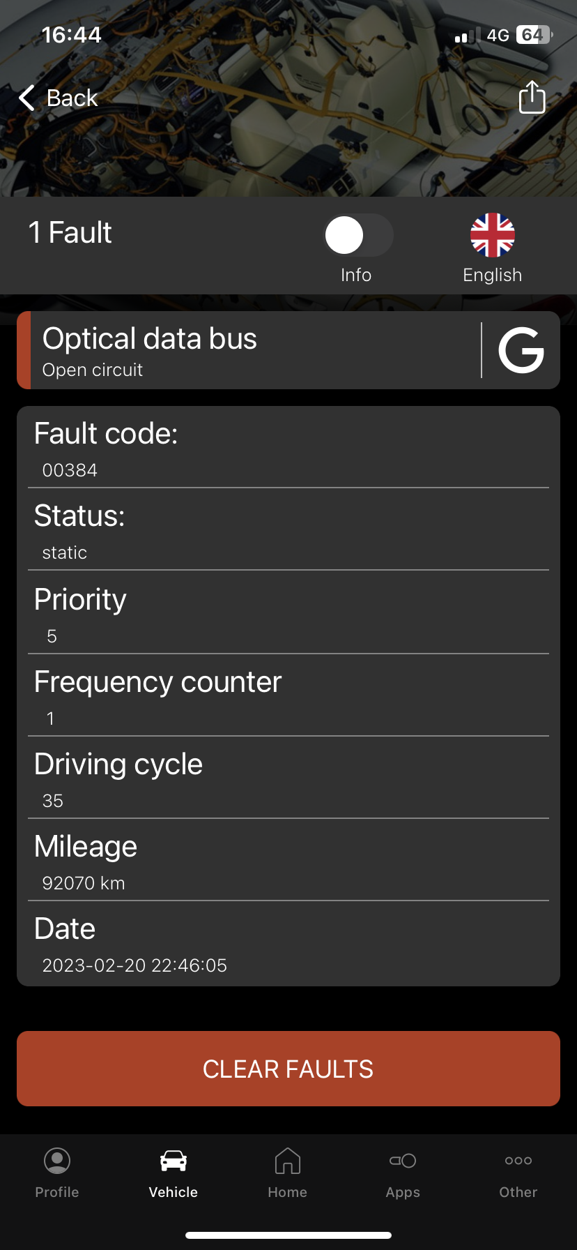

So I coded the battery and cleared all the 'low battery voltage' plus other errors from the control modules.  Now when I re-scan I am left with one error on the Gateway module - Fault Code 00384 - Optical Data Bus - open circuit.  The radio will still not turn on and the 'Multimedia' control module says "Error - control unit not responding" when trying to display any faults, though none are actually logged.
The car has a basic MMC radio and screen with no boot mounted amplifier.
I'm guessing that the either the radio or the display has given up the ghost ?
