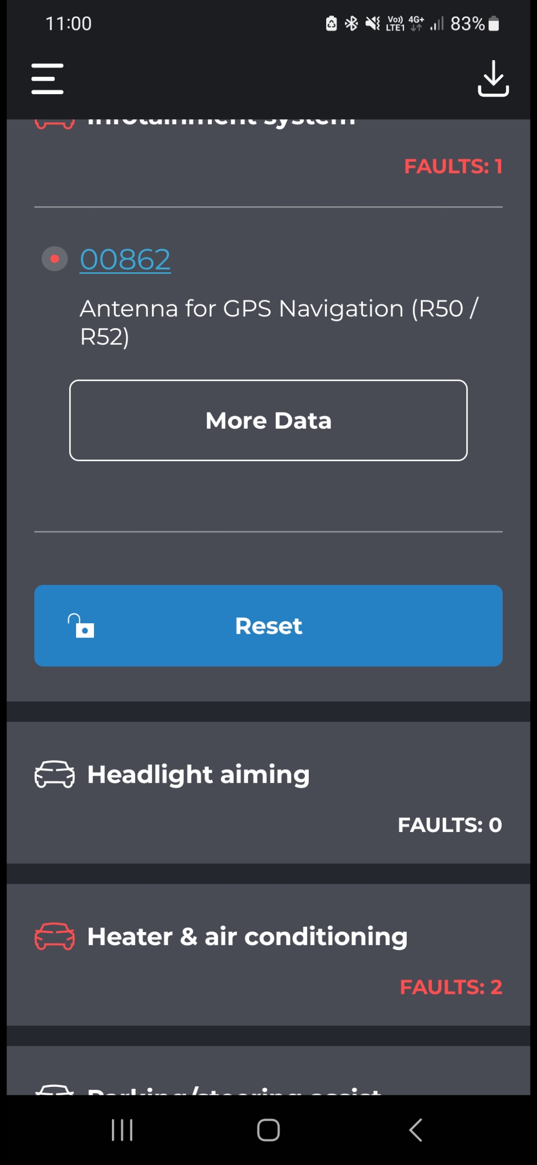

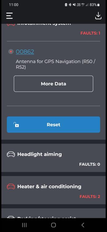

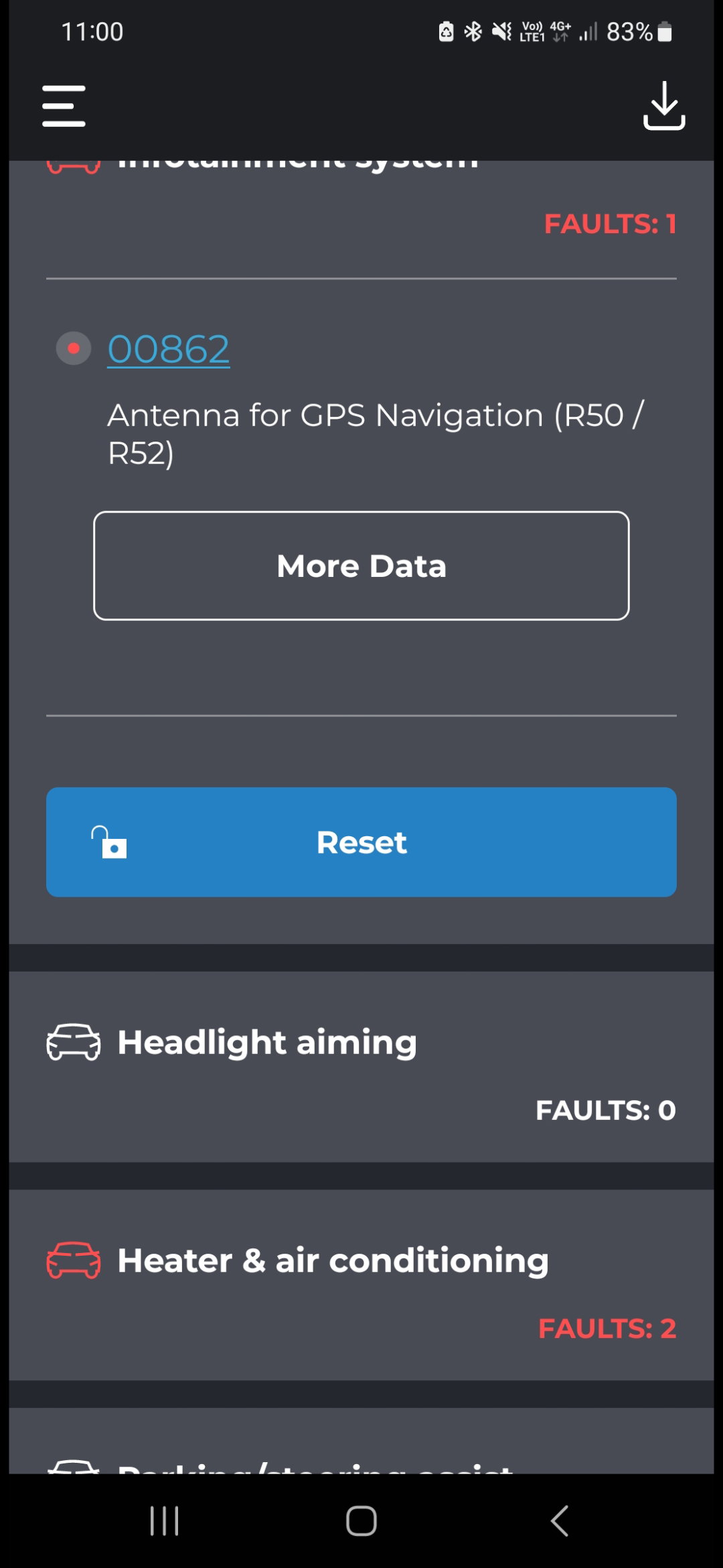

a6blacked007 Posted April 2 Author Share Posted April 2 (edited) On 4/1/2023 at 3:08 PM, Steve Q said: I'd recommend a diagnostic check to see if any fault codes flag up Did scan it with carista and navigation fault came up Edited April 2 by a6blacked007 Quote Link to comment Share on other sites More sharing options...

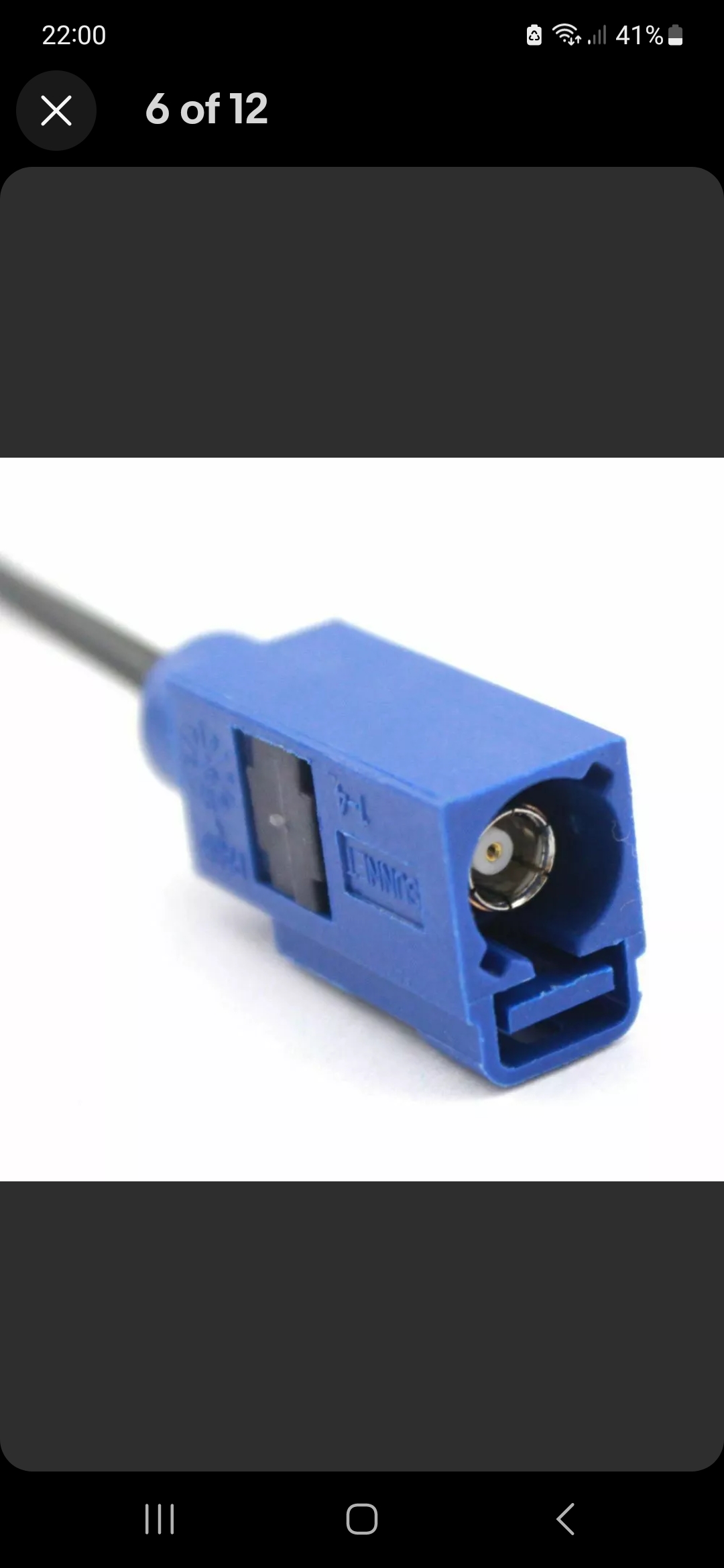

Solution a6blacked007 Posted April 28 Author Solution Share Posted April 28 Replaced gps antenna today with cheapo off eBay just stuck under dash now all is well nav works perfectly too with 9 satellites Below is gps unit may help others ... https://www.ebay.co.uk/itm/185551737107?mkcid=16&mkevt=1&mkrid=711-127632-2357-0&ssspo=r_uccv0-tkm&sssrc=2349624&ssuid=fkCuma5CT1u&var=&widget_ver=artemis&media=COPY Quote Link to comment Share on other sites More sharing options...
