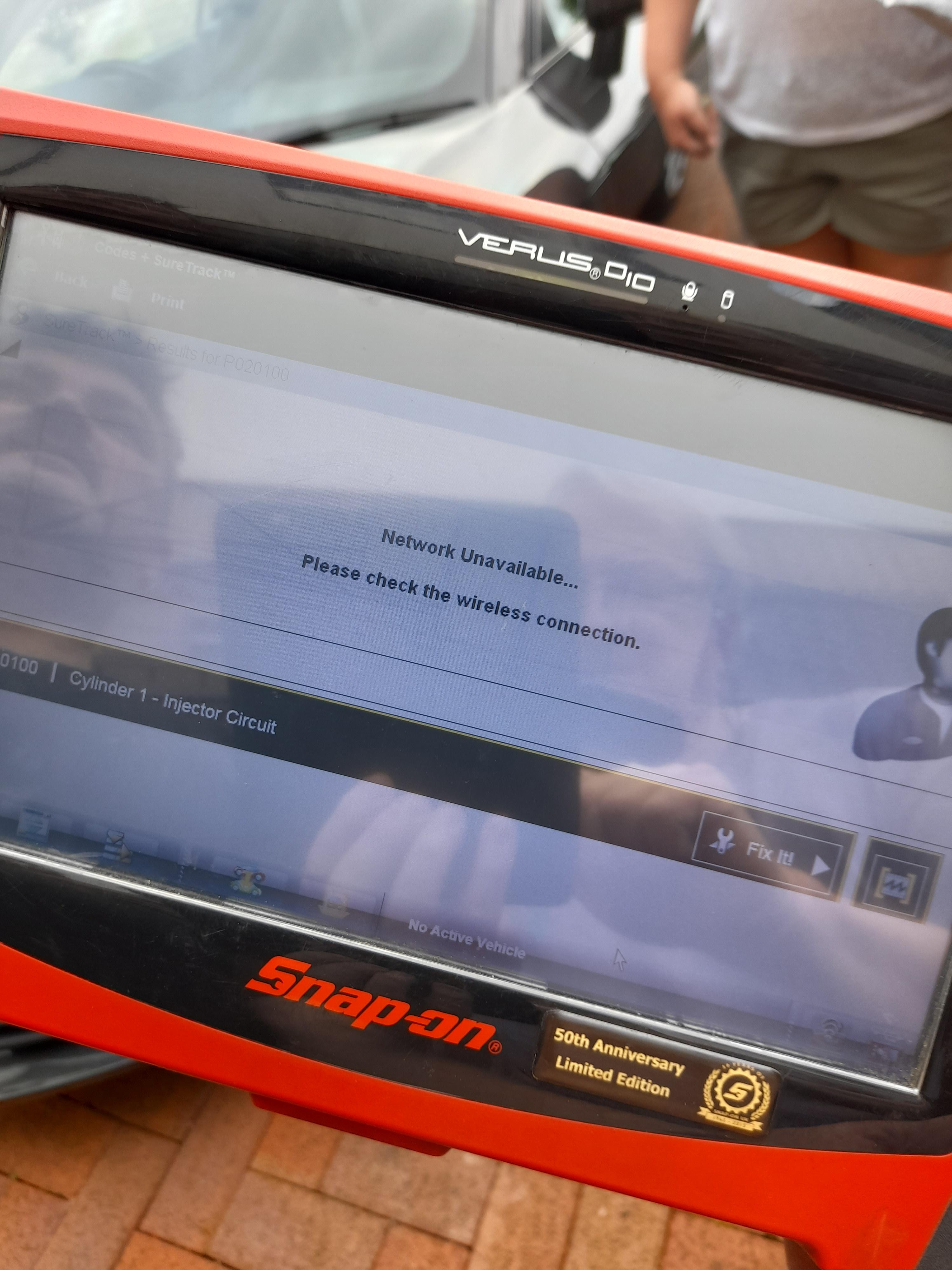

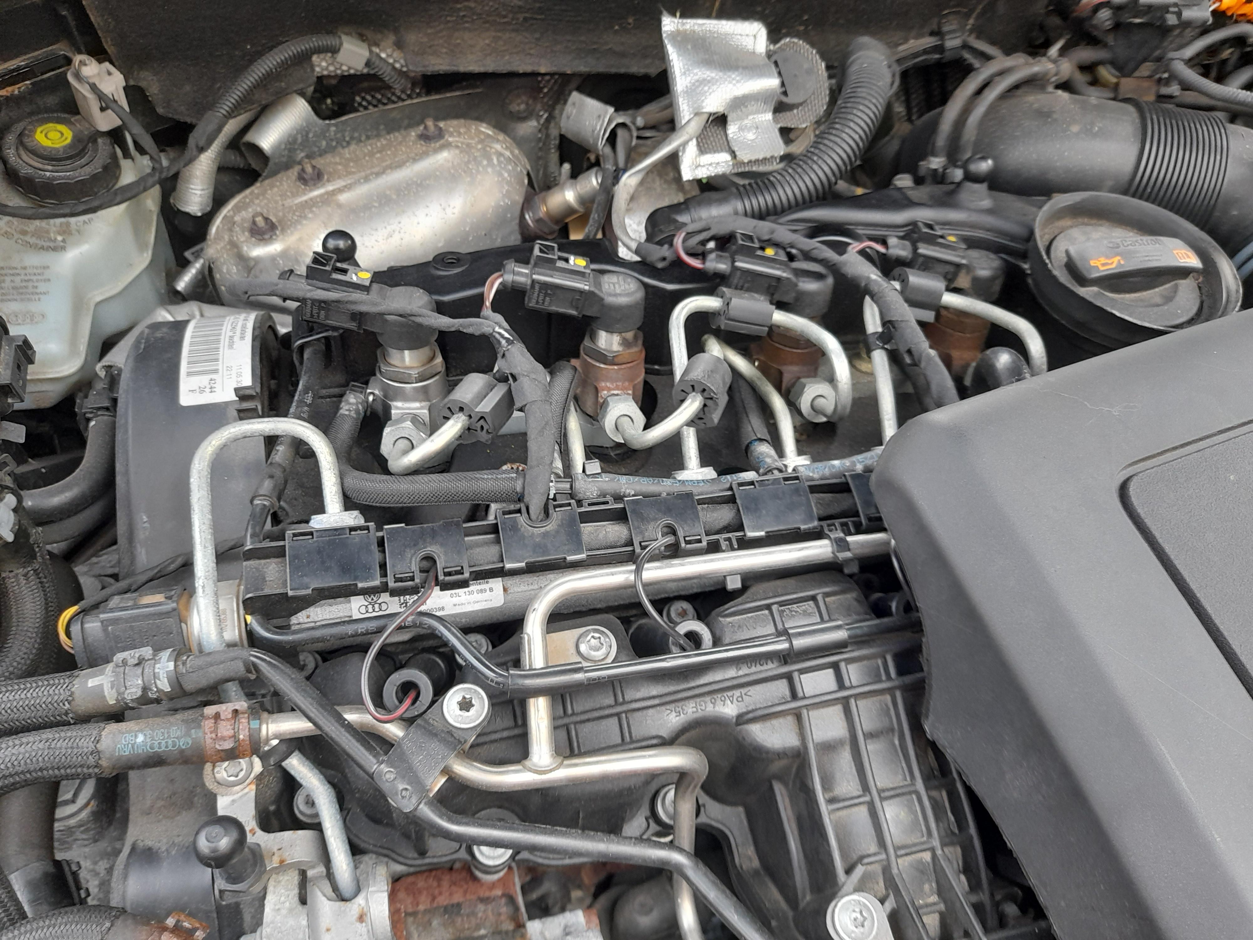

Richard09 Posted September 10 Share Posted September 10 I had Engine management and glow plug light appear A3 50000 miles 1.6 TDi it when into limp mode got it home. Had the fault diagnosed faulty Injector cylinder one so ordered a remanufactured eBay from a company called dieselfixneuss for £195 seemed a good buy as it had 98 % positive feed back. Placed the order, they started the delivery process and then I had a further request for £30 deposit as I had to send the old one back so to get the item sent had to pay the deposit, then the delivery started I received the order about a week later this is just the start of and extremely BAD costly experience, which will now change the way I source Car spare parts. History I fitted the the injector and got it coded for £75 all seemed OK ,this is my comment on eBay about the purchase Which I cannot seem to be able to find anymore. Well the item arrived the visual appearance of the injector as illustrated there was some greasy deposits in the hole for the flexible pipe, inline securing clip, also the plastic head for electrical connections was a bit battered and worn showing or indicating the age of the refurbished component to such an extent that it was difficult to see the code required to set up the unit see photograph. But later found out that it had been recoded. So after cleaning the unit trying to get all of this greasy deposits out of the injector inlet. A fine start which I should have had an inkling that all was not as good as I EXPECTED !!! This proved to be only the tip of the Iceberg , this is not in use as a main car A3 Cabriolet use on high days and holidays, we were out driving and the car suddenly when into limp mode with the engine management light on we managed to get home. I got a company who specialise in at your home diagnostics would you believe injector fault in cylinder 1 this cost me £150 see photographs the shinney new one in cylinder 1 so now starts the very protracted dealings with the supplier so what's this cost me so far injector £195 coding £75 fault-finding £150 Total of £450 that's without the deposit which I have had back. This now starts to get a bit messy they asked me to send it back to them so THAT THEY COULD CHECK IT AT MY COST, I asked eBay to step in eventually they supplied a Returns postage label UPS, I sent it back it's now sitting in UPS warehouse in Germany and has not moved in two weeks I have had to chase the supplier as well as UPS to tray and move things on, even eBay got there wires crossed and really did not know what was actually going on. I could not see any other way out of this situation which I could see going on for many weeks, so I had to buy a new injector in the UK managed to get one for £374 inc Vat and another £75 for the coding so what all this cost me to date which includes the original purchase and setting up as well as diagnostics the cost is £899 in total. It looks as if I might get back only the cost of the injector that if it ever delivered by UPS. I posted this as a statement of my issues, and realise that this might just be a blip, but I googled the supplier and was shocked to find quite a lot of reviews of one star on Trustpilot 25% of them, these are similar to my own experiences with them. Quote Link to comment Share on other sites More sharing options...
