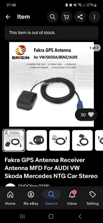

Screenshot_20231005_214816_eBay.thumb.jpg.8f114de100c704e9341b66ae5e015381.jpgYeah had same issue on my a6 bought 1 off ebay stuck under glove box been fine since.
Yeah I got one like that. Stuck it in the rear quarter panel and worked fine
