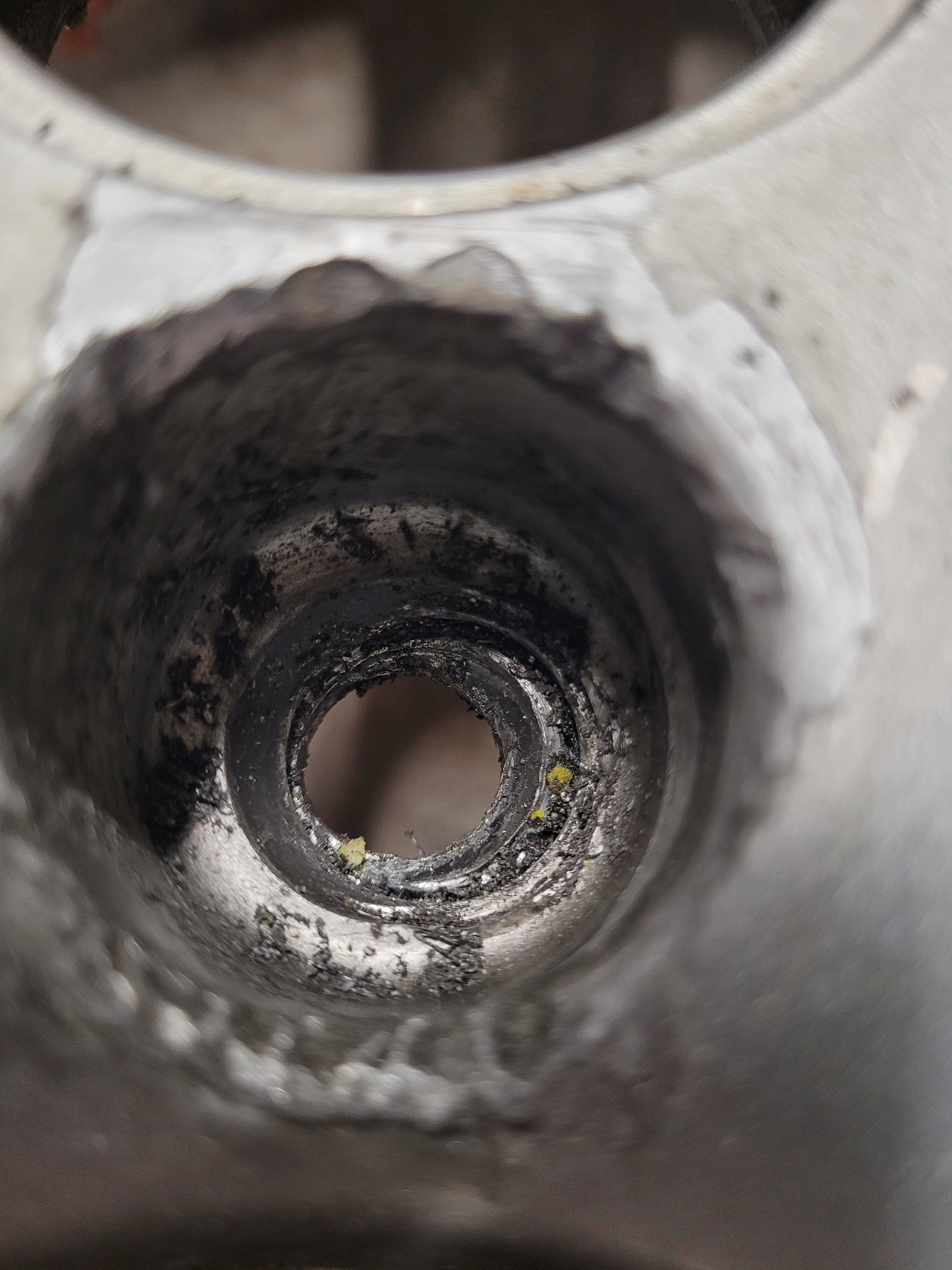

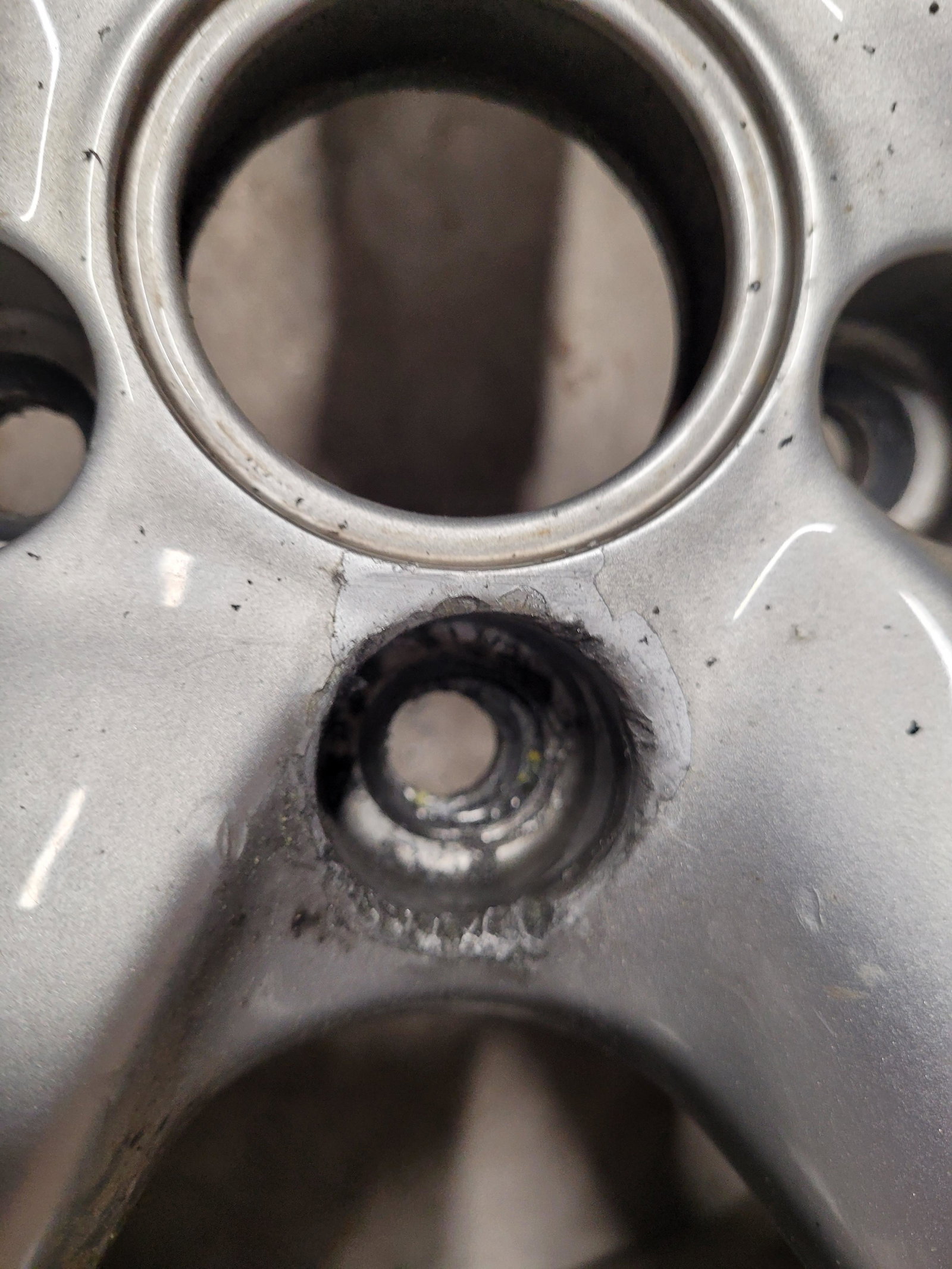

Hi.
Long story, but I had to use a core bit to get a wheel stud off. As a result I have damaged it. I know there are better ways of dealing a tight stud, but there you have it. I think most of the seat is intact. Would something like JB weld work OK?
Thanks
George
Hello George,
I guess you will have anticipated that the only safe way out of this is to now scrap the wheel and replace it with a sound one. Just no point in playing around with lives and your insurance.
