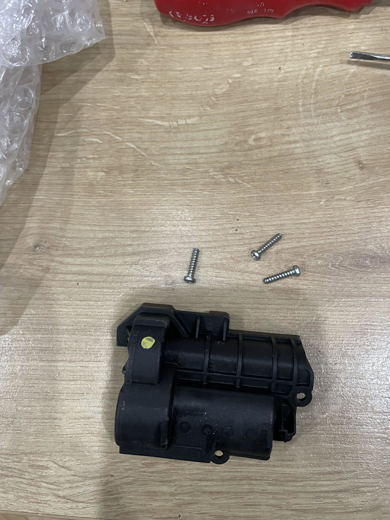

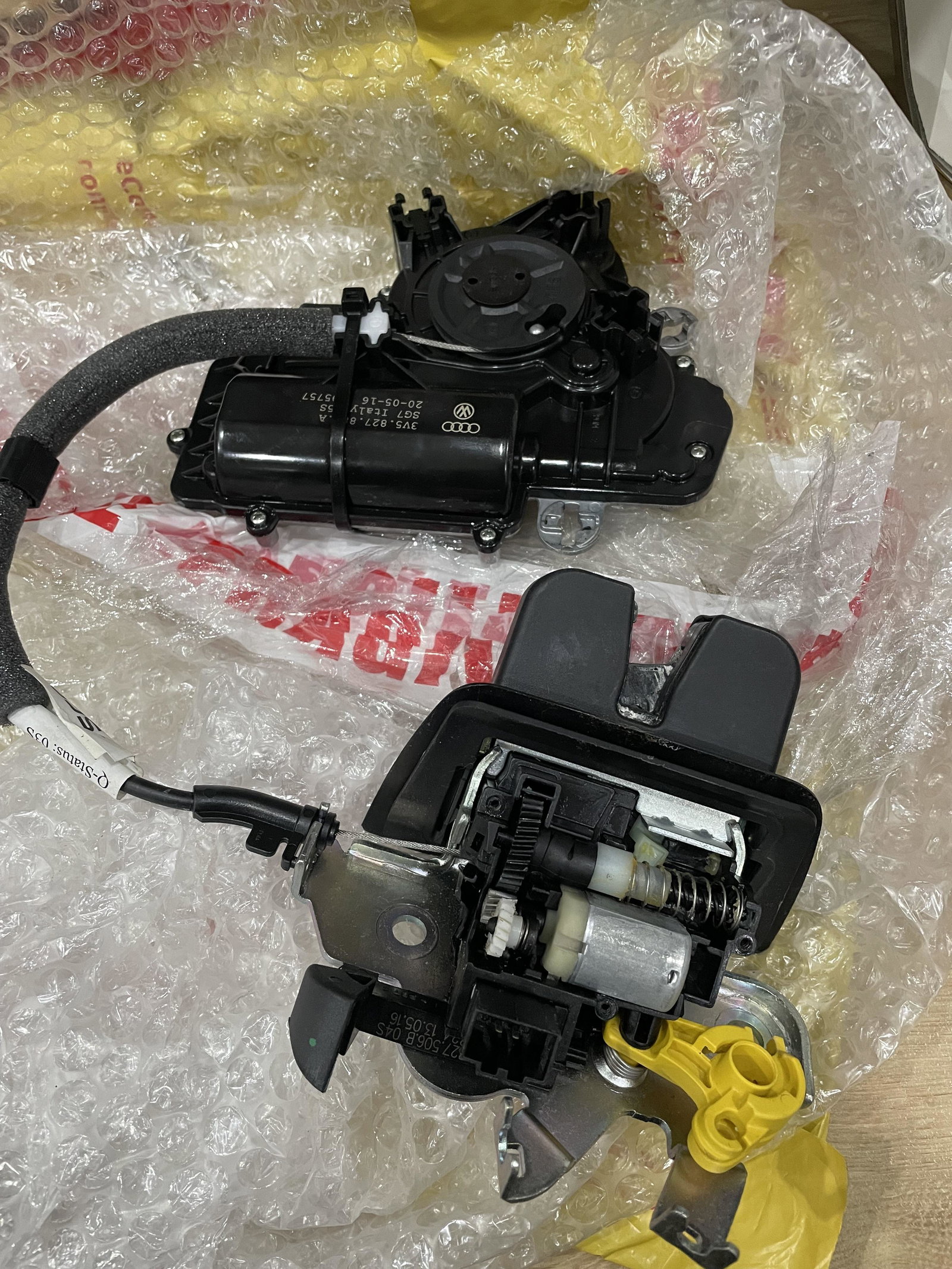

Couple of days ago the problem happened again and has remained, so I decided to strip it down. Found abit of a design flaw which while not permanently fixed it can be easily be reset to work again.
Remove the  plastic cover on catch secured by 3 Philips screws

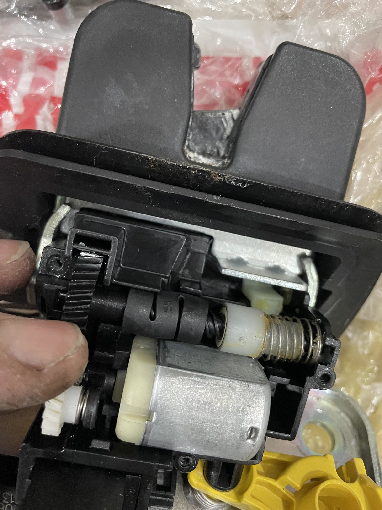

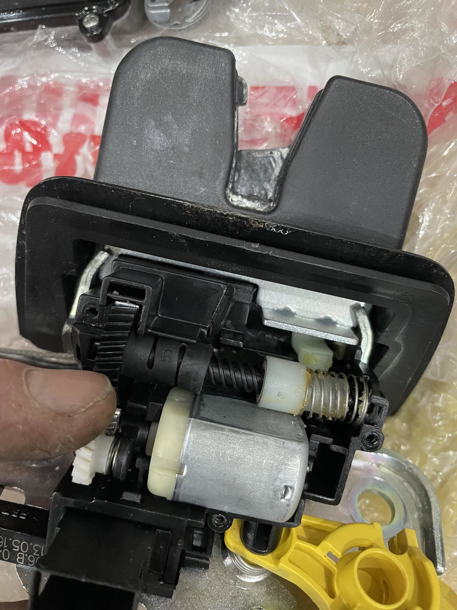

once open you will find a motor driving a long worm gear, on the there will be a rubber sleeve and a spring.
the rubber sleeve moves along the gear and gets jammed preventing the spring working and jamming the catch open.
just slide the rubber sleeve back away from the spring towards a section of the worm gear that is smooth
it should then work againIMG_2957.thumb.jpeg.fa2c9af7219019873305fd7d7a905f22.jpeg
