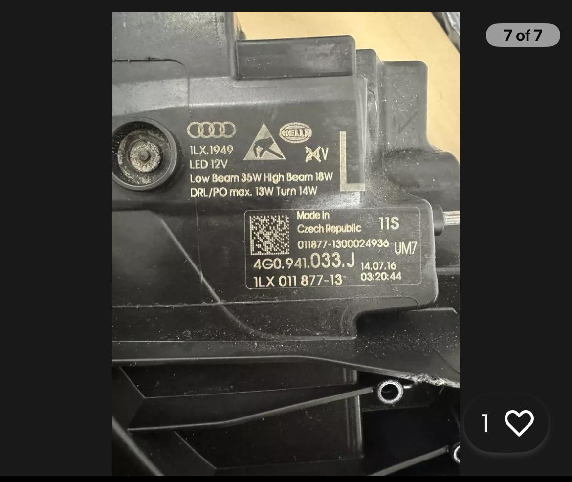

The incorrect coding is definitely worth investigating but would expect to see lots of fault codes if this was the case. Only thing changeable on LED headlamps is control units and some have a fan inside that can be changed but that’s all. Here is a stamp from the rear of a led c7 headlamp
Thanks for confirming. your photo is just like mine. 35w and 18w
