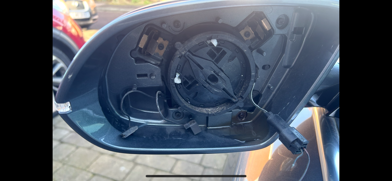

My passenger mirror glass fell to the road whilst driving for some unexplained reason. I could not recover it. I guess it just worked loose over time.
I am have ordered a replacement glass with all the gubbins attached to the rear.
I am having trouble identifying where the two wires in the bottom right corner of the picture go to.
The plugs for the heated side of the glass are present, but I cannot fathom the two bare ended wires.
Anybody had experience of this issue ?
  • 1 month later...
They are for the automatic dimming mirror function that turns the glass dark.
Oh that is fantastic information.
Many thanks
