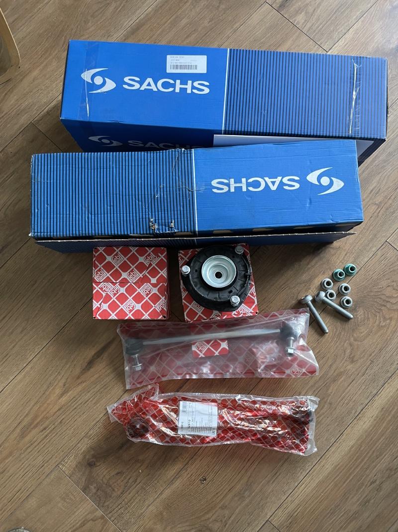

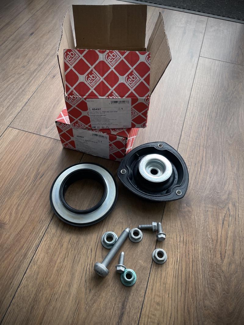

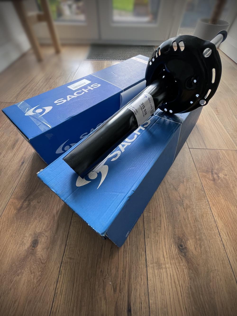

enc Posted May 6 Posted May 6 (edited) had same issue with mine. I suspected top mounts. had top mounts, dampers and drop links replaced. been fine for 12 months but now getting the odd creak again. i used Febi Bilstein top mounts and drop links and OEM spec Sachs dampers. Edited May 6 by enc 1

enc Posted May 17 Posted May 17 tahts pretty much the same sound as mine. as previously posted above, I had a few parts replaced and it was pretty much sorted but very ocasionally, it has started to do it again. im watching this thread with interest. fingers crossed your Audi specialist solves it for you. hope you post back here with their findings.
enc Posted May 17 Posted May 17 1 hour ago, Saj786 said: What was the fault on urs then, what was replaced?? as i posted ...above
Saj786 Posted May 17 Author Posted May 17 What was the outcome ?, what did they replace & did they say what was causing the noise?
enc Posted May 18 Posted May 18 (edited) 17 hours ago, Saj786 said: What was the outcome ?, what did they replace & did they say what was causing the noise? What was the outcome ? as i stated above , it has been fine for over 12 months but ive noticed the (very) occasional creak since the hotter weather what did they replace & did they say what was causing the noise? They changed the parts i supplied above...under my self diagnosis of the issue. Edited May 18 by enc
