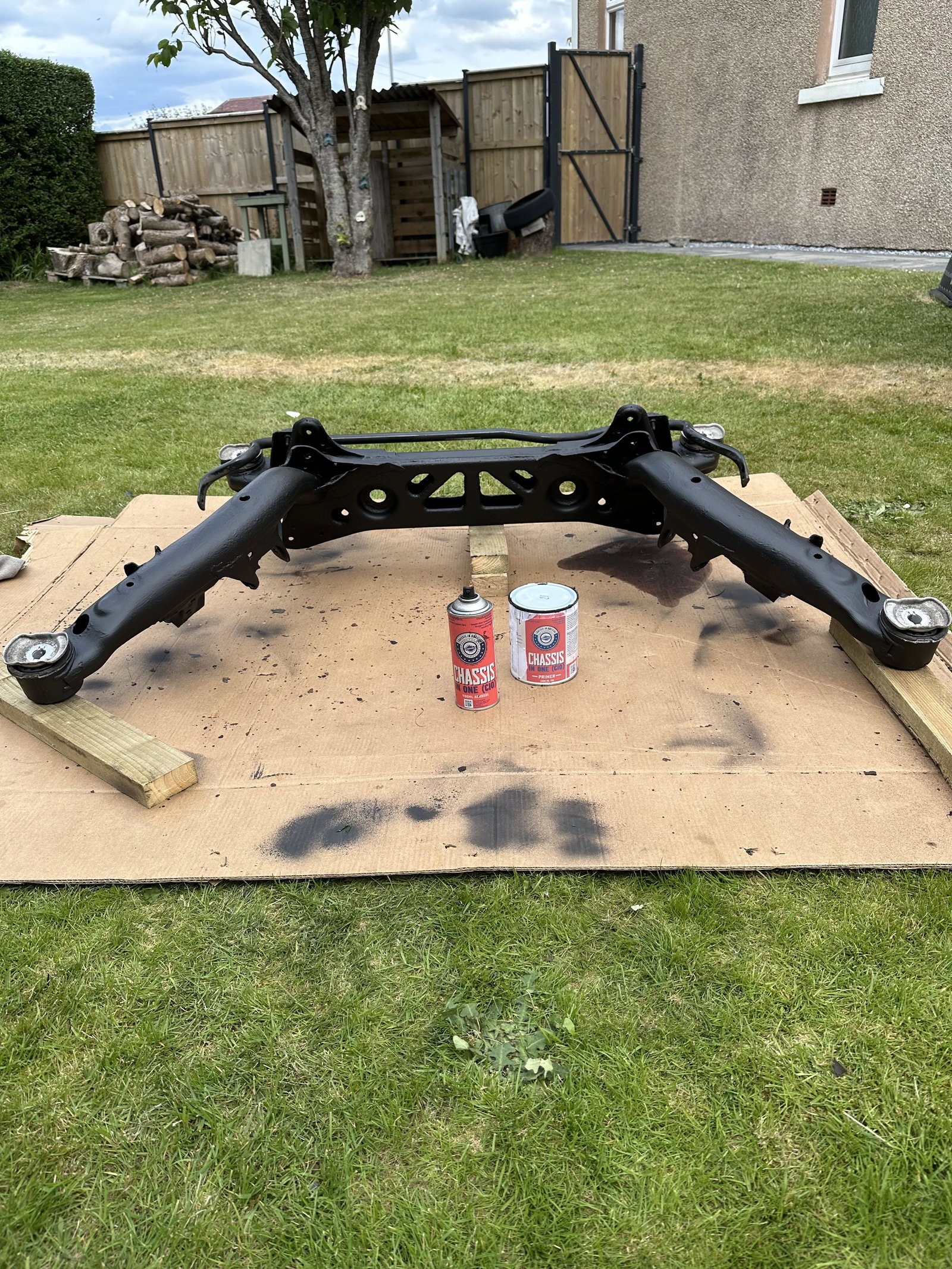

Davemca8 Posted May 19 Author Posted May 19 Work has been going on in the background with this mainly gathering parts. I have ordered all the fasteners I think I’ll need, new shocks and springs, various links etc. Annoyingly the replacement subframe that I got had quite a few bolts left in that the breakers yard had cut off. I have managed to remove them all and have repainted it after some surface rust removal. It’s came up quite well and I have also used liberal amounts of cavity wax. I’m now toying with replacing the subframe bushes but I cannot for the life of me find a tool for it. I have found a bush removal tool for just about every other car. There are some that say Audi vw rear subframe removal tool but give no dimensions or say what models it’s for. Quite frustrating. Has anyone used or know of a way of removing these bushes ? Thanks in advance 2

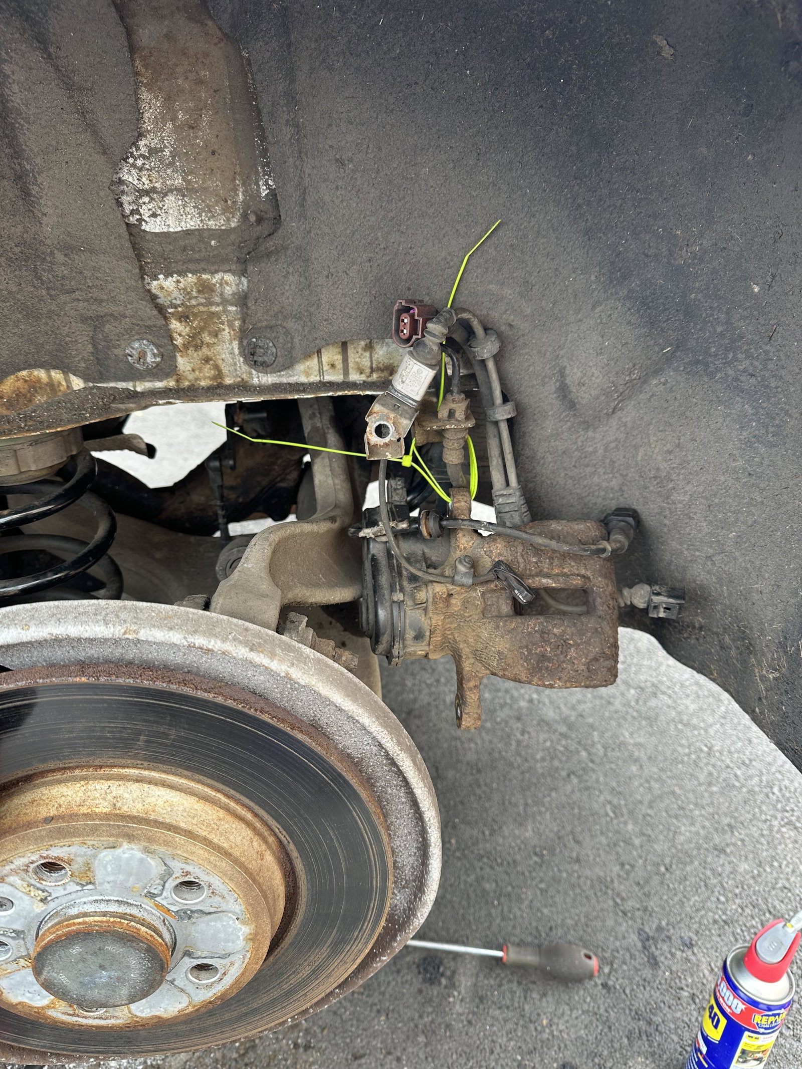

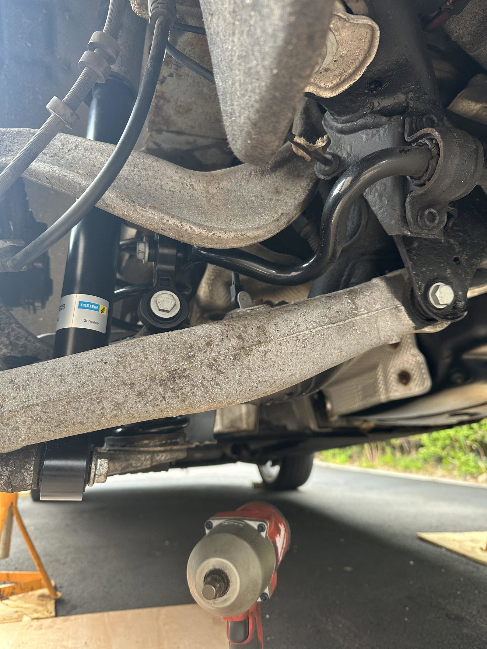

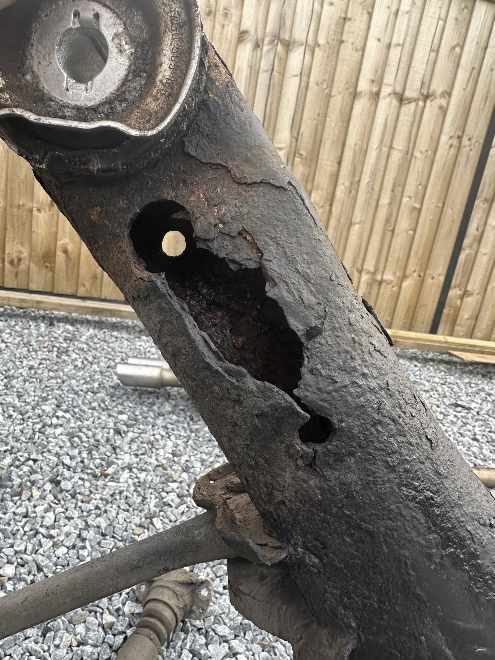

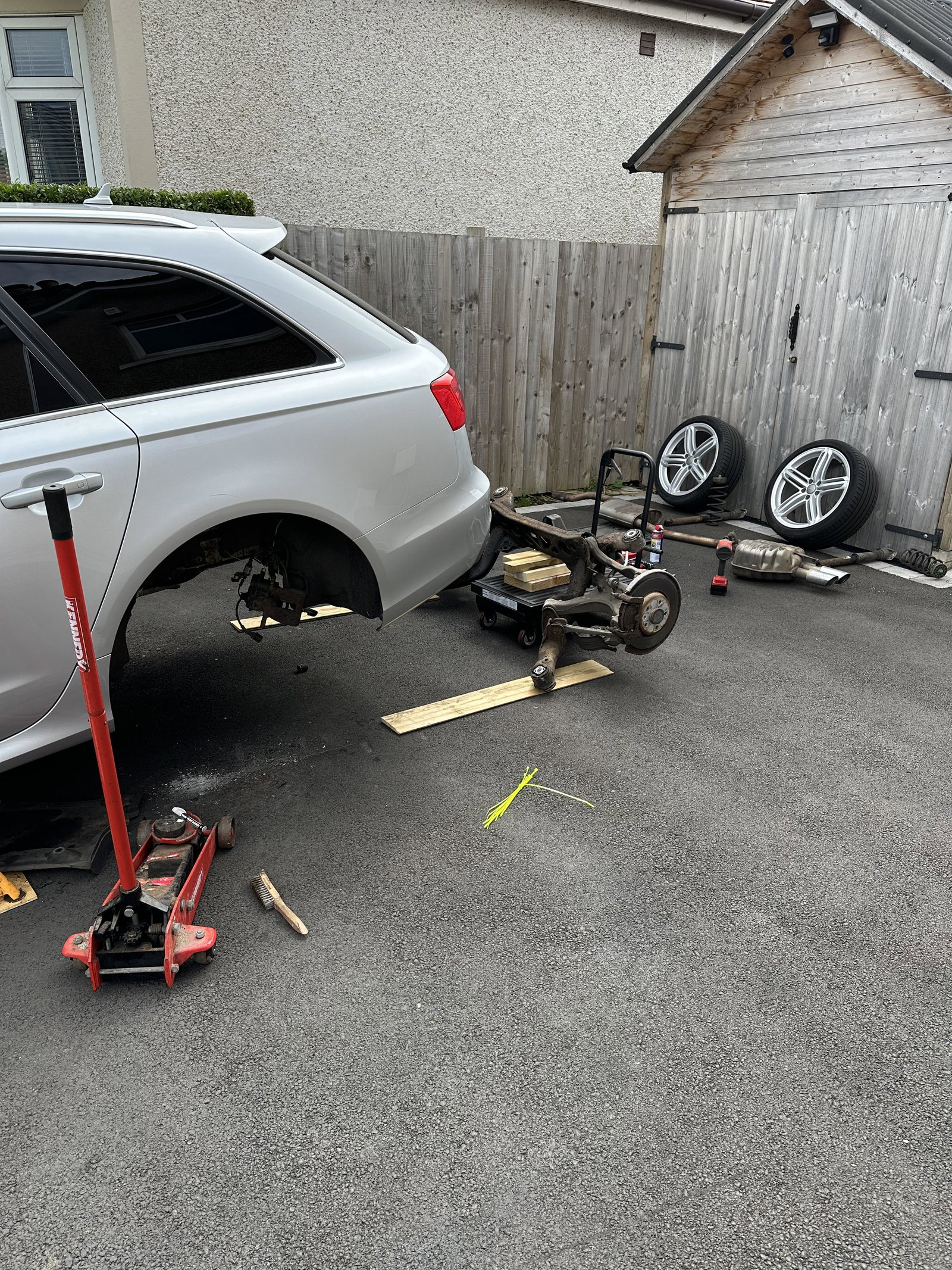

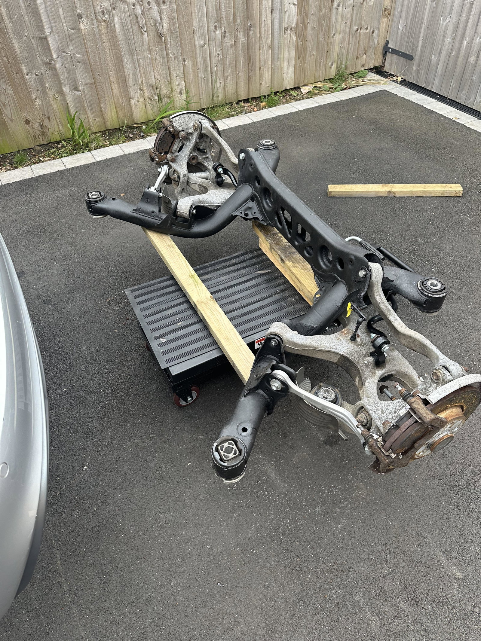

Davemca8 Posted June 5 Author Posted June 5 I’m about 90% complete with this job now I’m just waiting on a replacement spring as one of the ones I was sent was incorrect. Ordered on Monday but still not here frustratingly. It’s went a lot better than I was expecting a few tricky bolts etc and don’t get me started on the electric connector for the headlight levelling sensor! Here are some pics of the progress: I was able to keep the callipers connected by firstly removing the shock and passing it under the upper control arm which saved a bit of time. it’s been quite satisfying renewing the rear end with new components, bolts etc. Here is a better picture of why I replaced my subframe in the first place: It was actually the same both sides. Word of warning treat your subframe now before it’s too late! Also I couldn’t figure out how to remove the bushes and the ones on the replacement subframe were far better than mine were so I will be sending those back. I will update here if I run into any alignment issues. At the moment the subframe is only partially fitted to allow the spring replacement. 2
