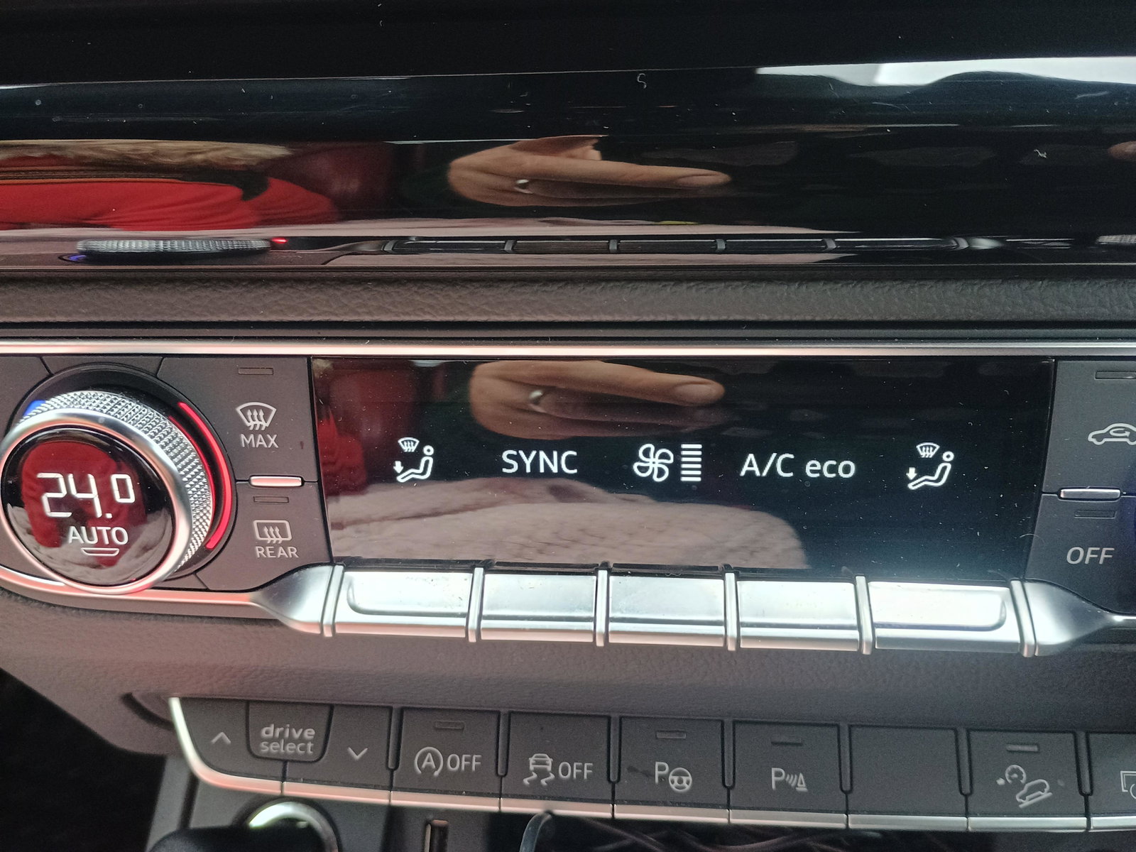

Hi. My digital display only goes up to no.6 for the fan speed, even on windscreen demist. Is this right? It doesn't seem enough. In my old Allroad (2015 plate) the air would take your hat off, but in the new incarnation its like a mild breeze, and takes ages to clear the screen.

Can I ask , does it blow powerful via the face vents, when set purely in that direction ?
Things to possibly check.  It's not set to auto or recirculating air .
I'll count my dashes later this morning. 2024 sq5.

It seems to blow reasonably well through the side vents, but pressing the windscreen demist button makes very little difference, and only for a short while before the fan audibly fades back. Still a max setting of 6, on any configuration.
Ok. My fan doesn't fade out at all when on demist .  It might dwell slightly for maybe 10 seconds untill it sorts out the flaps , then it's blowing a gale tbh.  I remember seeing the dashes on the display and it's around 6 , possibly 7.
