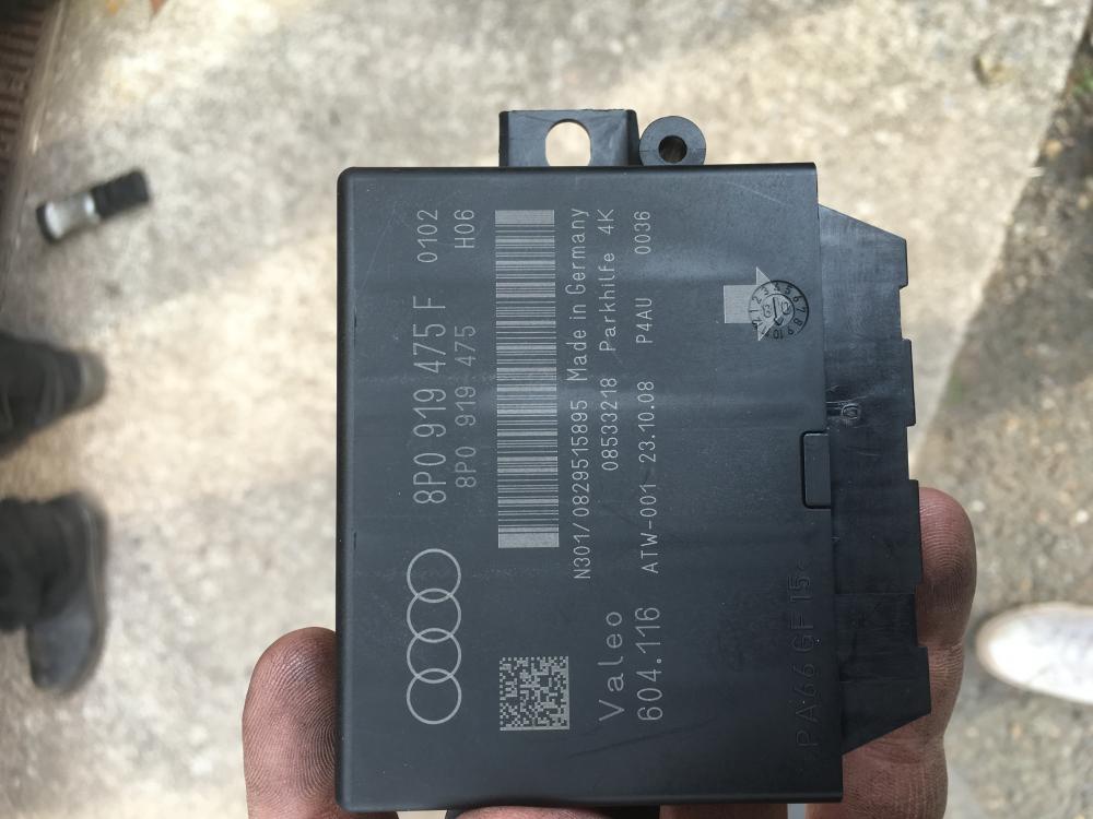

Hi, I've got an Audi A3 (8P) which is showing up as faulty control module on the parking sensors. I've removed it & I'm looking to get a new one but I'm strugging to find what I need. Anyone with any help would be greatly appreciated.

Danjobedl, I assume you have searched the part number of the part you've pictured

Thanks for the Welcome, I've searched the park number (8P0919475 F) of which I can't find one. There is tons of other ones that have slightly different part numbers  and also a few with same part number but a different letter at the end. I'm confused with what is going to work and what's not.. Thanks
Just make sure the part number including the last letter are the same, different letters indicate different features, some have extra pins some have less depending on the spec of the vehicle
