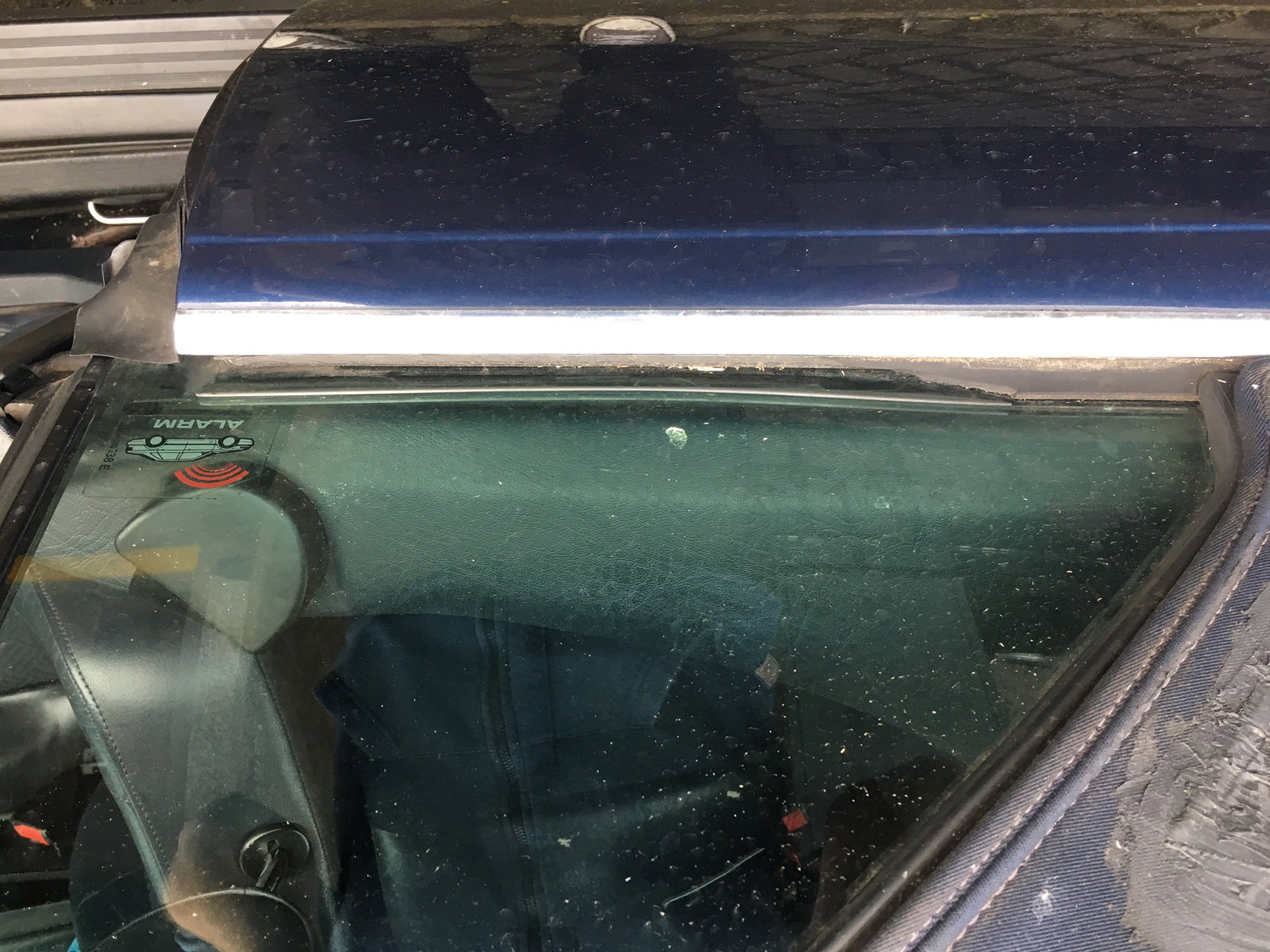

i bought a 96 Audi cab for a charity rally round Europe. £400 she cost me. Problem roof won't go down I've read so many different fixes and problems for the roof online. I don't care if it works auto just happy with manual if I can get it down and back up.

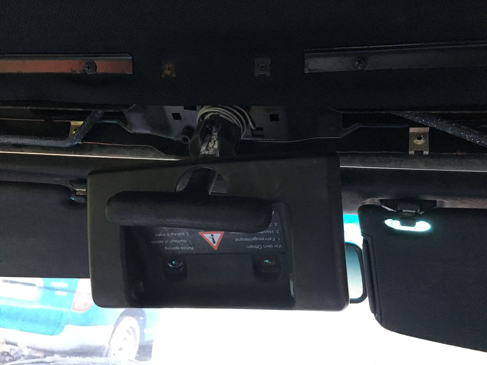

So The back drivers window won't go down and the roof latch only twists halfway. The centre button and the rear window button won't do anything but rest of windows are fine.  I have no owners manual and I'm not sure if I'm even trying to put it down correctly.
As you can see by the photo someone has cut the rubber seal at the window before.
Any help would be appreciated.

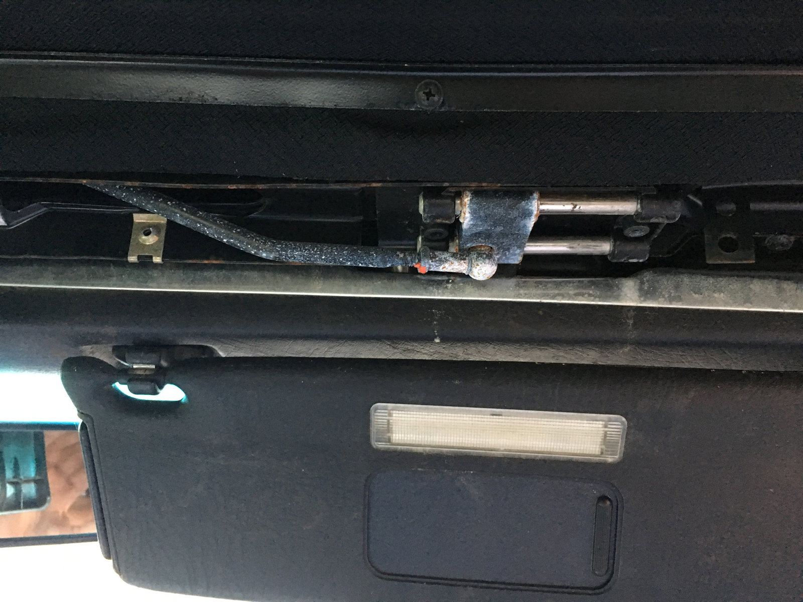

The first thing I would do is to soak everything liberally with WD40 as the linkages, etc look very dry and corroded in the photos.
I imagine the rear quarterlight needs to retract before the roof mechanism is allowed to function.

I soaked the links in oil but the mechanism still will not turn past half way. From reading online ppl talk about the boot lock mechanisms and the rear window needing to work. Others say it should manually open anyway but not great for the window seal to do this with it up. Does anyone know what the actual procedure for lowering the roof manually should be?  Or have a systematic approach to checking the various components to allow for the roof to drop?
