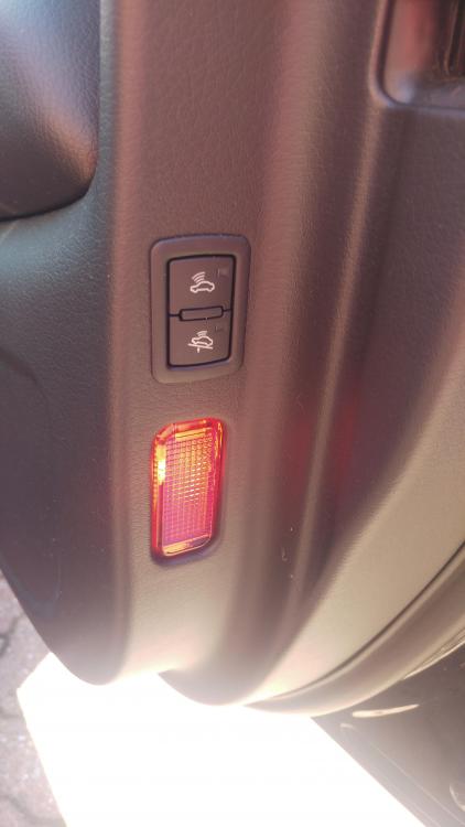

Mark Townsend Posted August 22, 2017 Share Posted August 22, 2017 Could anyone tell me how you disable the motion sensors on A8 59 plate as my dog sets off the alarm 馃槞 Thank you Quote Link to comment Share on other sites More sharing options...
WPAWS Posted August 22, 2017 Share Posted August 22, 2017 Hi Mark check your drivers door on the side panel when door is open and see if you have these buttons if so turn them off :) 聽 Quote Link to comment Share on other sites More sharing options...
Mark Townsend Posted August 22, 2017 Author Share Posted August 22, 2017 Thanks mate funny how you don't notice 2 buttons on the door but they are there after checking. thanks for the pic and your help 馃憤 Quote Link to comment Share on other sites More sharing options...
WPAWS Posted August 22, 2017 Share Posted August 22, 2017 Not a problem m8, only know the answer cos i found the buttons and asked what are they for lol Quote Link to comment Share on other sites More sharing options...
