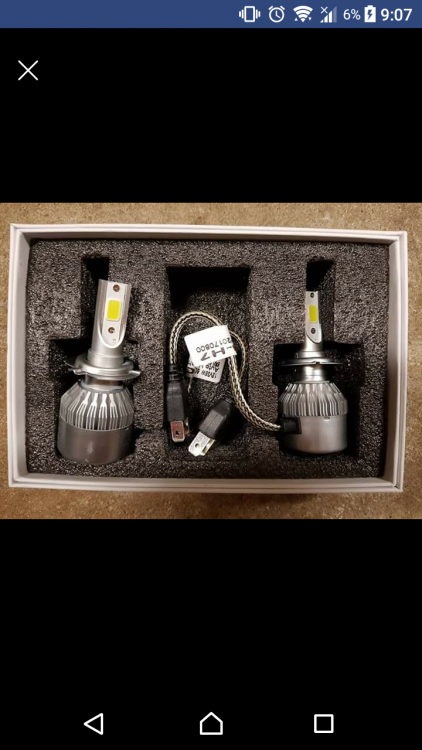

Hi I need some help. I bought these h7 led lights to replace the standard h7 I have on my 2008 A3 hatch.  trying to put these led lights but someone told me that its not gonna work with my car and need a conversion etc. Hope you can help me.  Thanks
The H7 is the correct fitment however the mass of the heatsink/driver unit wont allow the dust covers back on and I believe as they are a fitting that doesn't have a clip to secure it they will fall out due to vibration and weight.
But the big issue is CANBUS , unless they are CANBUS compatible they may fail to light up and throw bulb out warnings, it maybe able to get CANBUS interfaces but you would need to check legality and comptibility.
