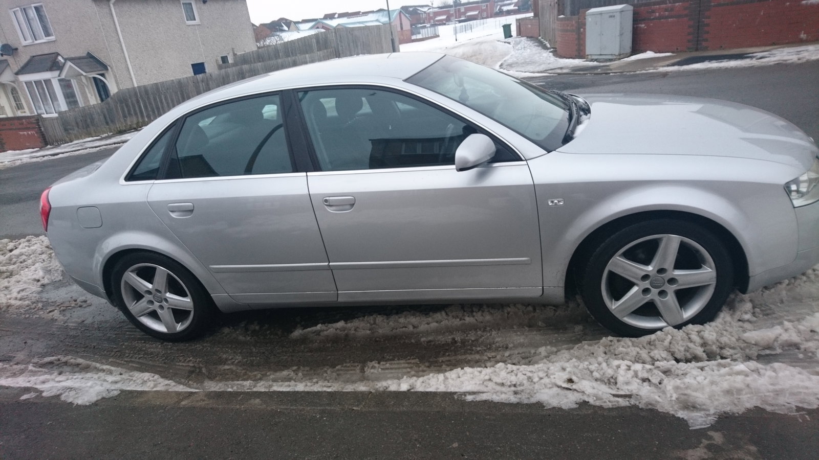

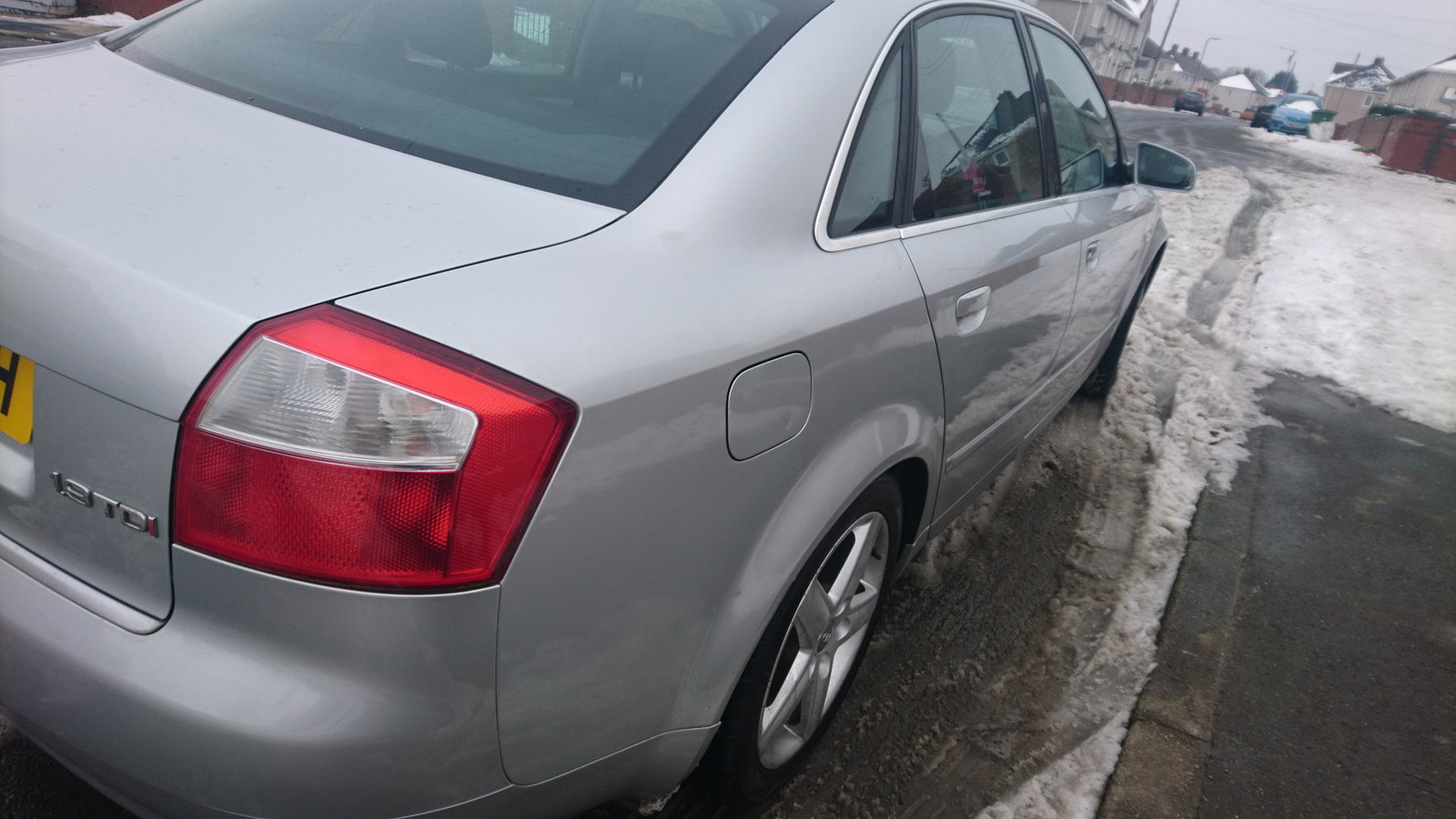

Hi I've just purchased a 2003 a4 1.9 tdi sport.it has covered 82k miles. No booklet and not much history. It does have previous MOT certificates.i am wanting  to get advice on the clutch as it seems to only release high up on the pedal. Is this normal? I've been told the belt/chain has been replaced(correct me) DSC_1276.thumb.JPG.406c0afb80e094888f95524234582315.JPG. But that was just by mouth.i have two wheels to refurb and two wings to be repaired and painted. Not really much rust just bubbling on the lacquer and paint . Seems a pretty solid car and the interior needs nothing. Everything works as it should. Is it worth carrying out the work as I tend to keep the car for quite some time. Thanks in advance.

Thanks Steve I will call or pop in to audi for history this weekend. Car is on 82 thousand. It goes through all gears fine and clutch works just seems quite high up.i read that putting foot to the floor whilst in low end of 5th gear should give me some indication as it would slip at that point? Paint on wheel arches I'm getting quotes for. Thanks

Rust on front wings is a common fault on vag cars from this era including a3, a4, a6, golf, Bora to name a few. It's due to foam inserts attached to the inside of the arch between the metal and arch liner. However the foam retains the moisture and thus causes the rust.
The only proper cure is to have the wings replaced which will cost you around £1000 all in. I paid this approx on my a6. Obviously you could botch it with filler but this is only a short term answer.
