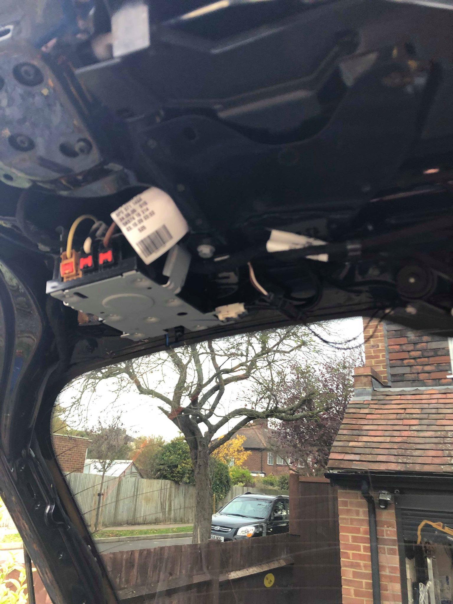

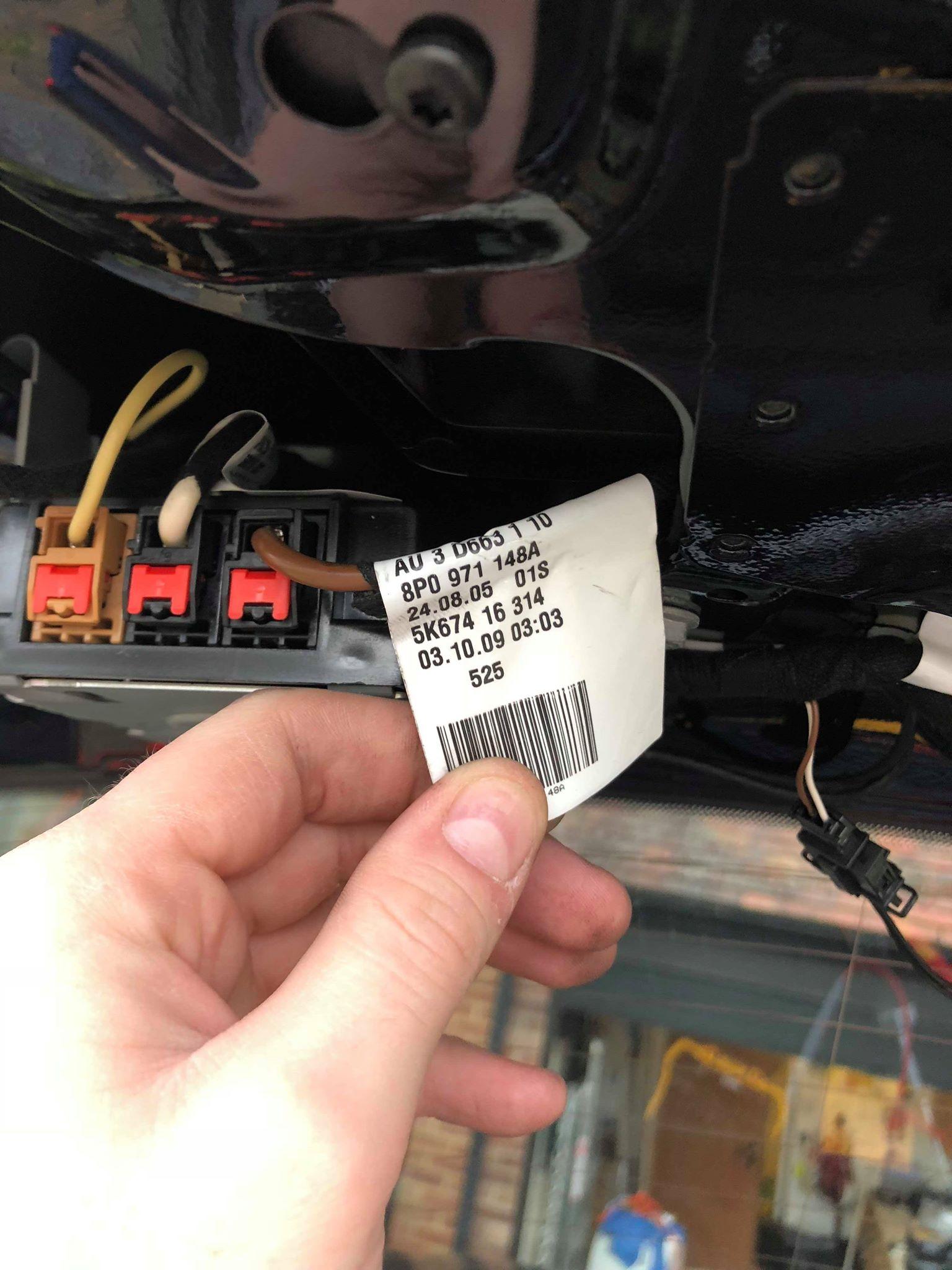

Going back to the rear screen I have had the boot lid cover out to try and fix the issue, no tabs are broken on the element wiring, the fuse is fine. So I am trying to rule  out if its the "antenna booster" module, pics below. It seems the heated screen power wires go into this unit, the 2 right black blocks seem to be left and right.
Can anyone shed some light on this for me? is it likely to be a failed unit, or do they rarely fail?

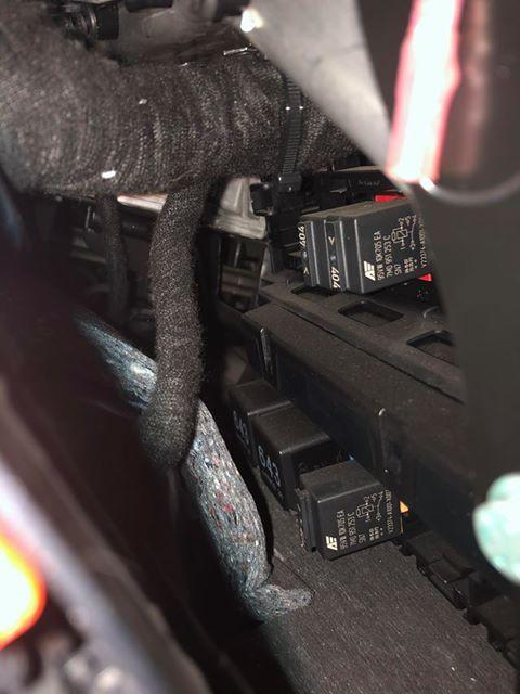

Could it be a relay issue? I see they are behind the interior fuse box and a pain to get to without unscrewing the fuse box?

Does anyone know if any of these (im guessing the 2 smaller if any) is the relay for the heated rear?

Thanks for the reply, this time before I went out I listened for a relay click, Im not sure if it was there before but I pushed all relays in a bit earlier, and there is definitely a click now...
And some success, not sure if its all working but definitely had warm working mirrors this time. I need to wait till it mists up or get a kettle out and check if its solved the rear screen.
