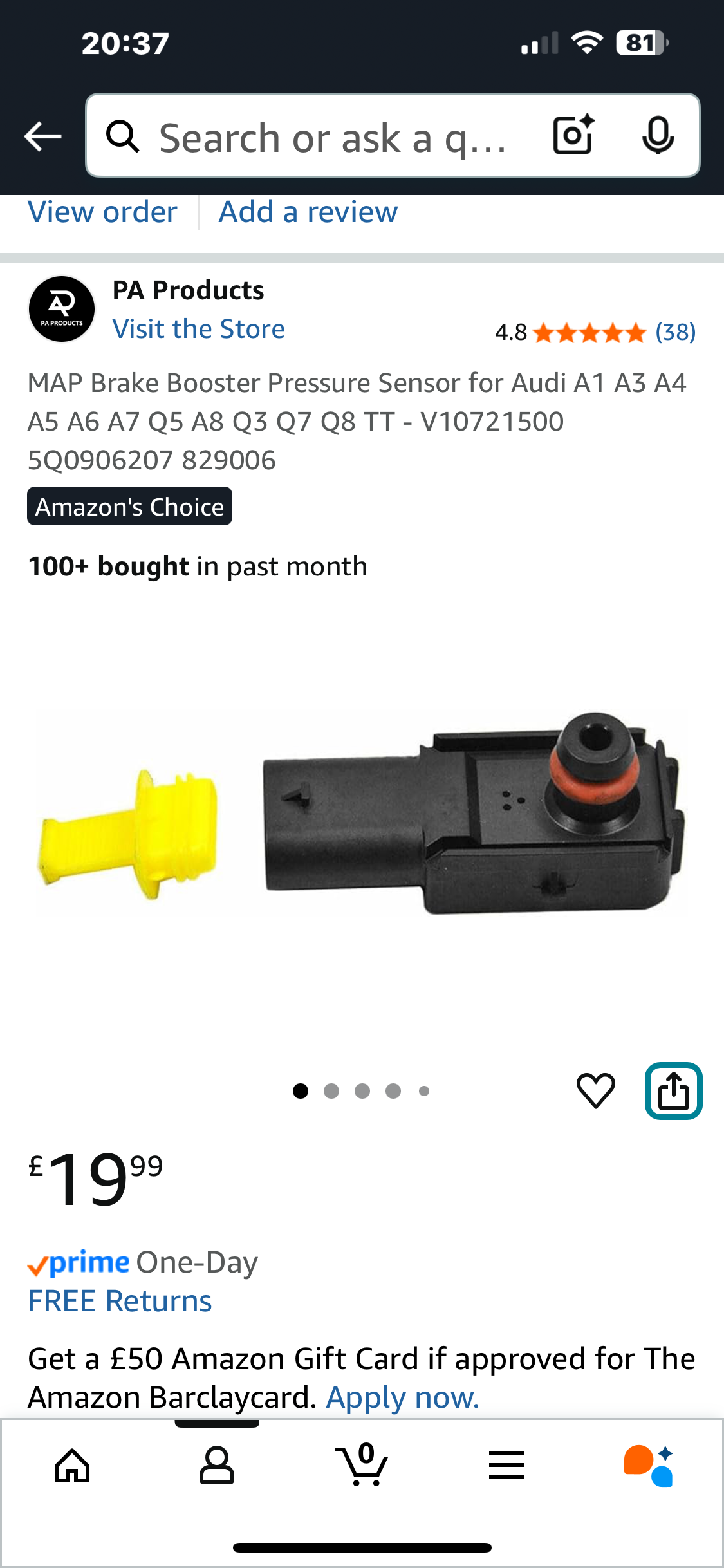

Jotenhiem Posted 4 hours ago Posted 4 hours ago 46 minutes ago, kh904 said: Ignore the message that says it's 'OK to drive'!!!!! The message is incorrect!!! DO NOT DRIVE ANY FURTHER (try not to brake too hard and park up as as soon as possible where safe to do so). Buy the required sensor and replace it asap. It’s ok bro I’ve changed it now and the brakes are working fine now no issues since 1
