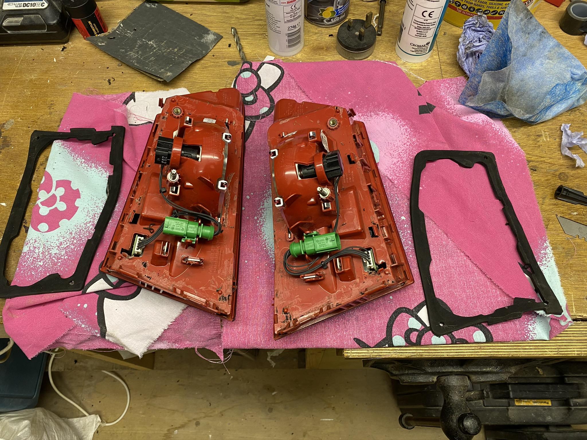

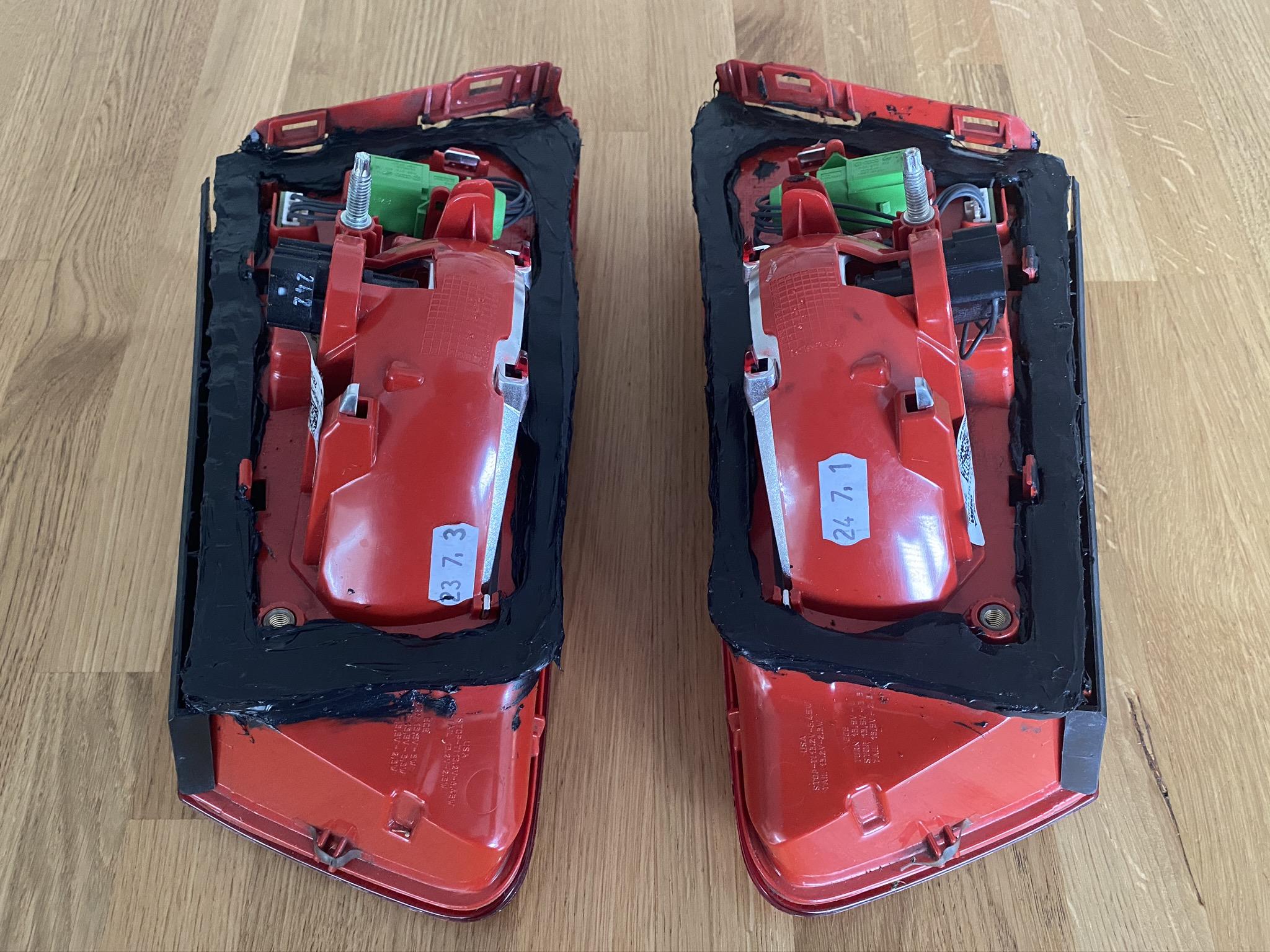

woto Posted August 6, 2020 Share Posted August 6, 2020 Hey Guys Wondered if anyone has had this problem ? I'm getting water in the boot lid, its going into the cavity section of the lid not coming through into the boot, so when I lift the lid water comes out the access holes where you would change the bulb - I removed the lights then put silicone around the seal put it all back but that didn't work - then the next time I removed the seal from the light then used CT1 to stick the seal to the light then put it all around the seal, I thought the water might be coming through the seal. I left the lights for a few days for the CT1 to set, once it had gone off I applied silicone to bed the lights back on. This seemed to work but after a couple of months I have had water coming into the cavity again, I just can't believe that it's coming through the seals the amount of sealant I have used. The car is a A6 S-Line 2012 Quote Link to comment Share on other sites More sharing options...

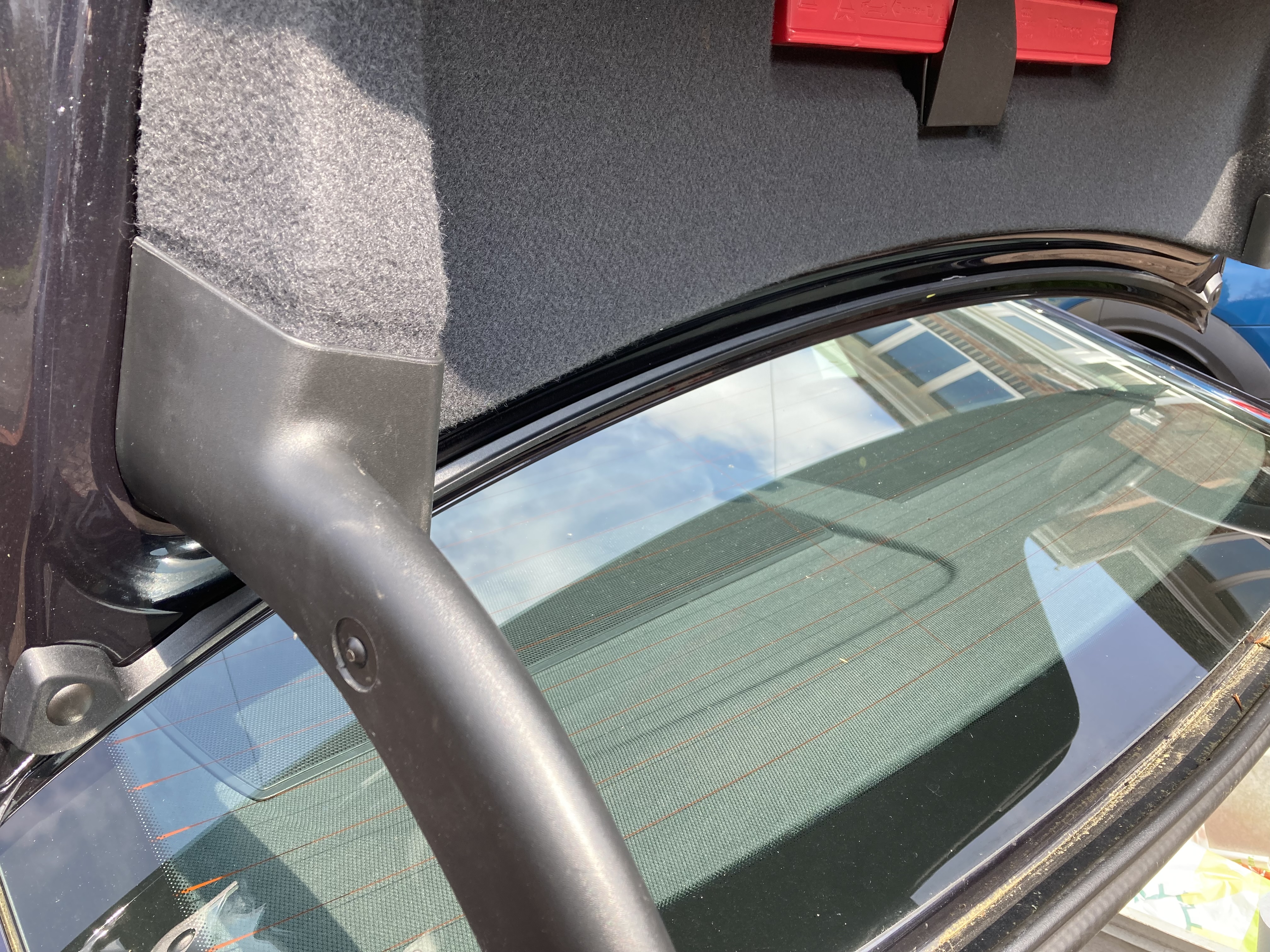

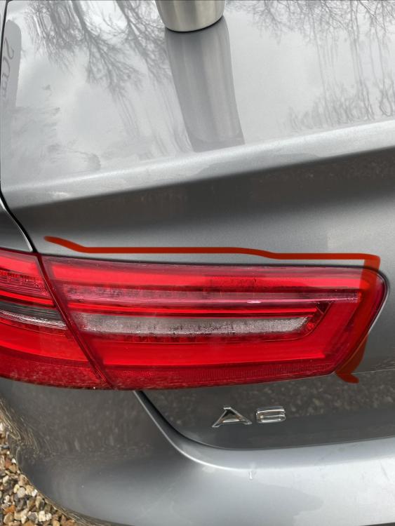

IWalt Posted January 3 Share Posted January 3 Hi I've been getting the same problem, when I open the boot after its been raining, water pours out of both sides where the boot hinges and the liner. Fitted new seals to both lights about a year ago, still getting water in betwen liner and boot, so put black tape over the small gap between light cluster and body to see if this would help.. Seemed to solve the problem for the last six months. However started again about four weeks ago. But the tape is still in place. Don't understand how this is happening. Quote Link to comment Share on other sites More sharing options...

IWalt Posted March 23 Share Posted March 23 Hi Mark, Yes tried finding the leak by getting into the boot with a torch and my wife hosed the boot area along the edges. I could not find the leak, but when I got out and opened the boot up a little water came out of the liner by the hinge. just to add to this saga, we had a lot of rain the other night and when I opened the boot in the morning about half a pint of water came out from both sides of the boot. I have tried putting extra rubber seal on the boot lid to see if the water is getting past the boot seal, replaced the gaskets on the rear light cluster and put tape over the gap between the lights and the car body, also put duct tape over the edge of liner and the boot. Still, it leaks. There does not seem to be a leak when it is a light rain shower, but if we have a decent downpour that’s when water gets in???? if anybody has any idea what the cause is please let me know. Thank Ian 1 Quote Link to comment Share on other sites More sharing options...

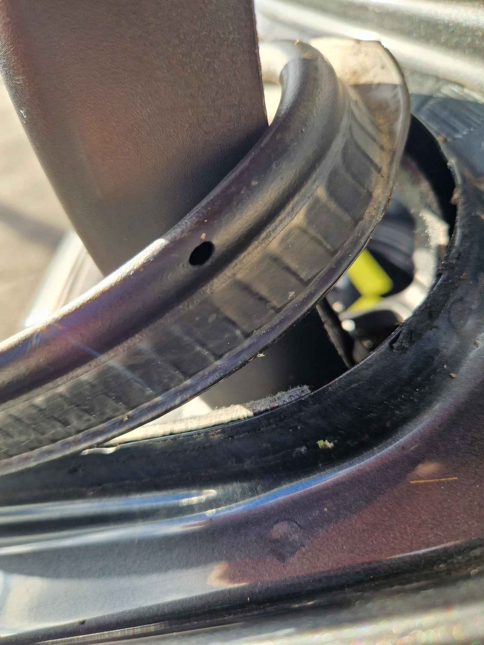

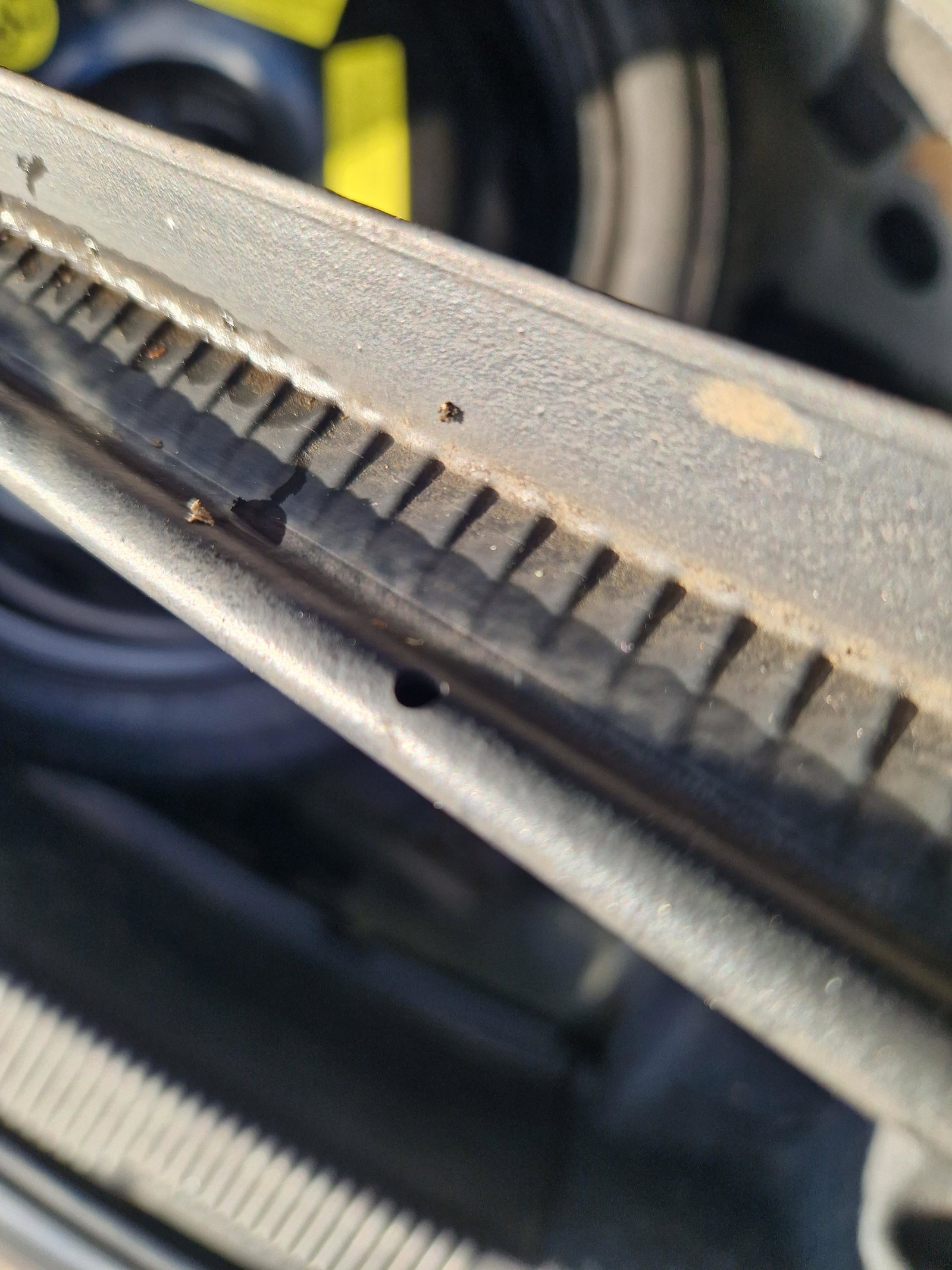

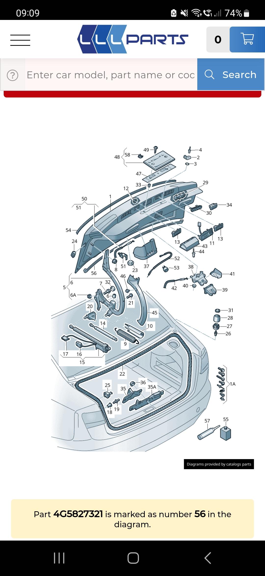

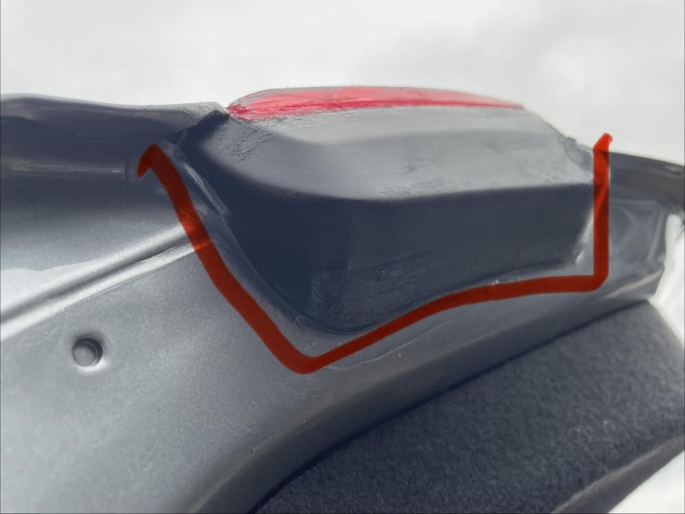

IWalt Posted April 21 Share Posted April 21 The latest on water in the boot cavity. I have found that you can buy a gasket to attach to the edge of the boot lid, see photo. I purchased it from the local Audi dealer for £21.88. and fitted it in about 15 minutes. Making sure that the paint surface was cleaned and dried using white spirit. The part number is 4G5827321 Gasket. I also purchased two Bumpers 4H0827589B which I thought I might need. Only 59p each but found that the gasket already comes with its own. The gasket arrived broken in two which helped when fitting the gasket to the boot lid. Not sure how hard it would be to fit the gasket in one long section. A warning if you decide to fit this gasket, once the adhesive strip touches the bodywork, it sticks, fast and very strong. And you will have trouble moving it. I did this fitting by myself, but it may be wise to get someone to help. Anyway, after all that I am now waiting for a good downpour to see it works. Will post an update ASAP. (I wonder if this is an upgrade fitted to later A6’s) Regards Ian 1 Quote Link to comment Share on other sites More sharing options...
