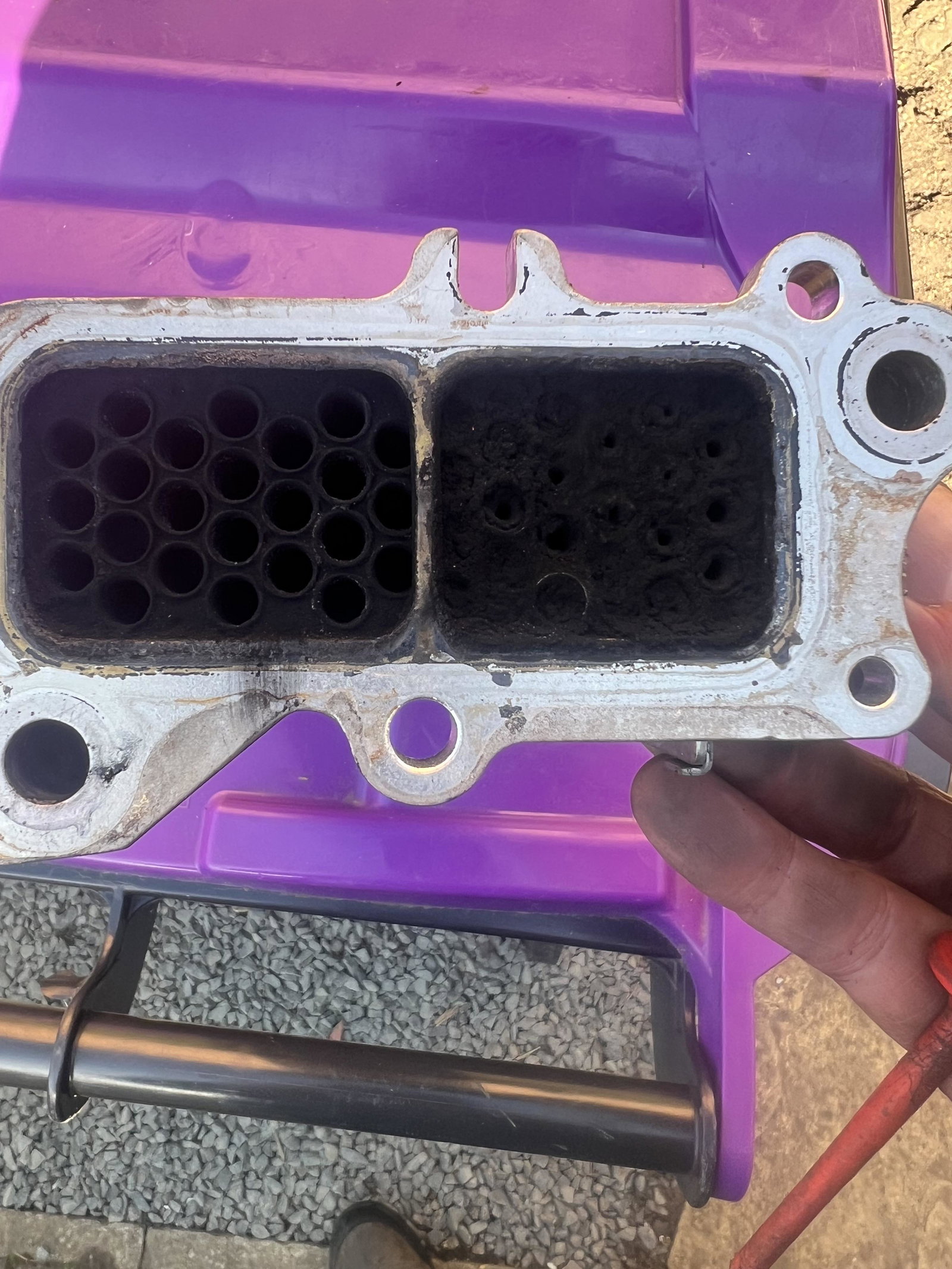

I have had similar on a 2013 2.0d with 180000 miles.
it was a combination of two things, slow response due to carbon deposits in the variable vanes of the turbo. This did not require a turbo rebuild, if you remove the turbo and split it the variable vanes are in front if you, a good clean off with carb cleaner & petrol got rid of a real notchiness.
it still however came up with turbocharger/supercharger under pressure error. The EGR cooler was blocked solid. The valve body and valve was fine unfortunately you cannot buy just the cooler. Replacing this (good luck with the mount bolts, they are a nightmare) - error now gone.
an occasional bottle of turbo / diesel system cleaner in the fuel tank keeps it clear.
