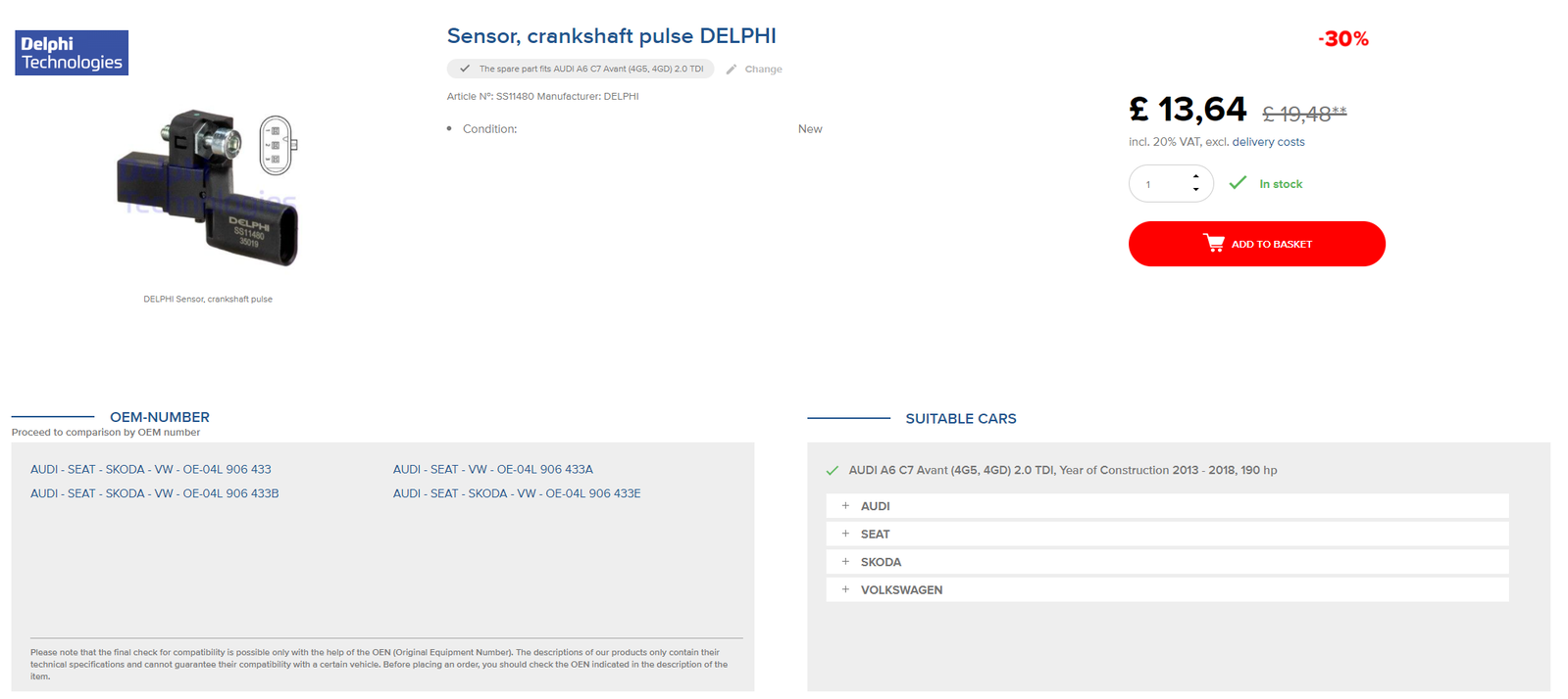

So, after trawling the net I think I have found the sensor I requir (G40) for a cheaper price than Audi quoted, I just need to locate the old one to compare the OEM number and visual elements
Link to post
