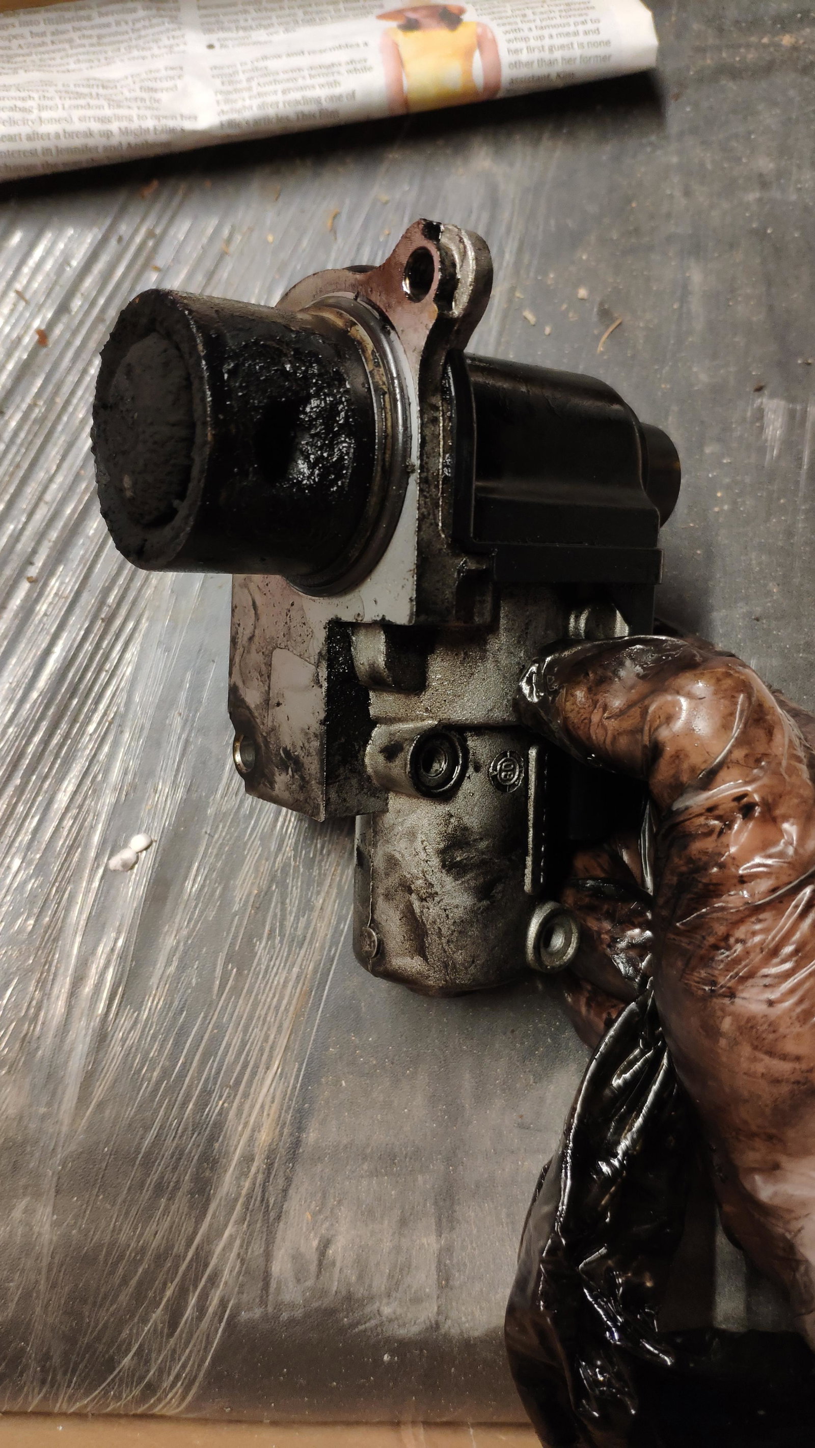

So with my own self made adapter tool took off the throttle thing, then managed to get the EGR valve off. took a bit of time loosening it but wd40 did the trick along side gentle nudging for 10 mins!
Will clean the throttle valve today and install the new EGR valve and also sensor.
Wont be able to ADAPT any of those but hoping car will start and run and can adapt later. Lots of reading on net some suggest car self adapts etc.

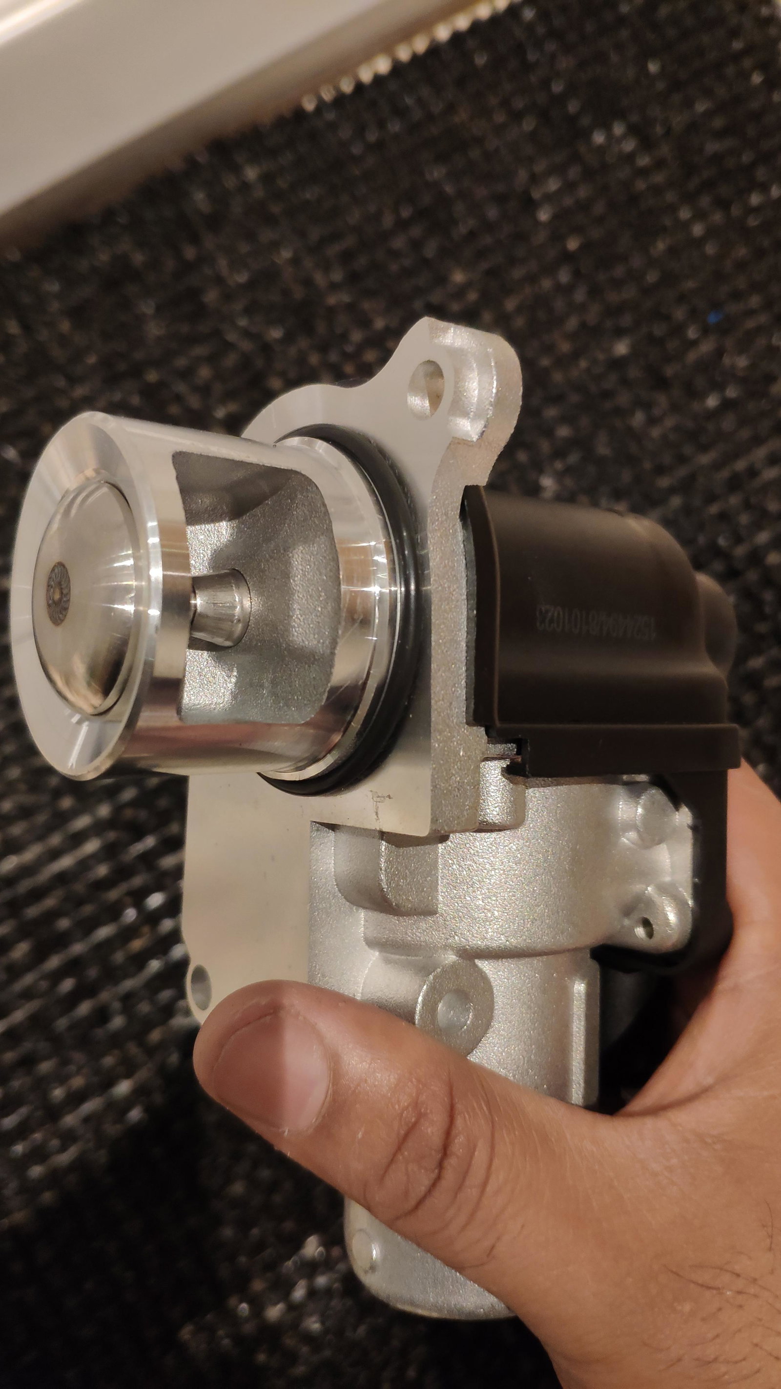

The EGR valve compared to the new one was about 85% blocked. Just had a pencil hole gap in it. Hoping this is the issue.
