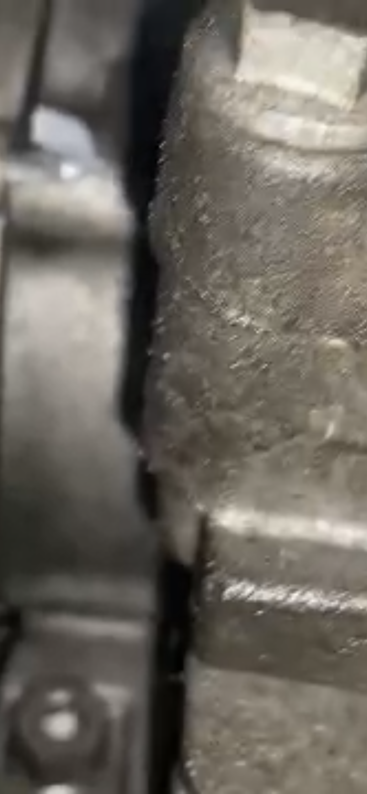

Hi. My wife’s 2009 TTRS 62000 mls decided it didn’t want to go forwards or backwards anymore then a foot or so.  Manual Gearbox fine. Clutch feels fine.  Brakes not stuck on and the car rolls freely,
 we had it into our local dealership today and they’ve sent us a video showing a cracked bevel box.  Never heard of anything like that before.   Is this common?
audi are quoting £3.5 k.
I managed to get a 35k miles one for £1200.  Getting it fitted on Tuesday for £400 at VRS Northampton.  Very helpful and knowledgeable local tuning company, let’s hope the box is good.
Cheers.  All done.
£1200 second hand box
got it fitted.  Also got VRS Northampton to do a haldex service.  Engine oil and filter service, rear dif oil and seals, as well as realignment of the engine as it mustn’t have been put back in place properly ( maybe the cause of the box failure ) after having a clutch fitted by a previous owner
can’t fault them
£1071:00
The wife says it’s driving great now
