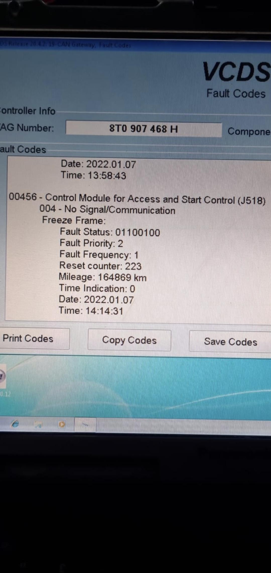

Some progress my mechanic got communication with the ecu and got fault code 00456

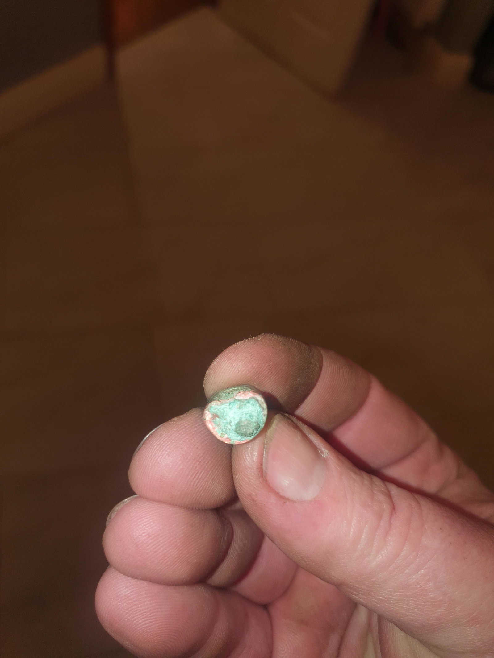

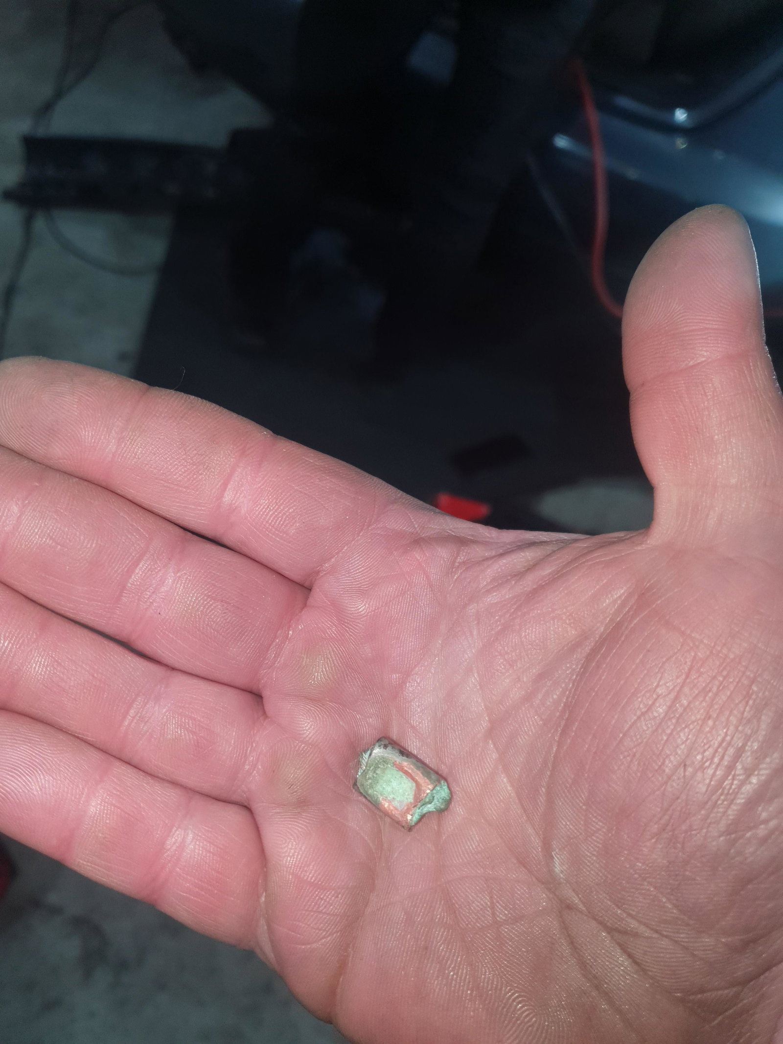

It looks like my power issues and no communication issue to CAN were all related to corroded wiring in the drivers side trunk area, we found the wiring to be literally crumbling once moved which was possibly as a result of a leak 18months ago. Once the wires were trimmed back and connected all power was restored. I still have my original elrctronic brake issue but that should be easily resolved now the car has power and is starting 😃 below is the link I found that lead me to the source of the issue and hopefully is will save someone else a lot of effort and time if they have the same or similar issues

That's all that's left of the crimp, the cabling actually just crumbled away and had to be cut back 3cm to get to good wire
