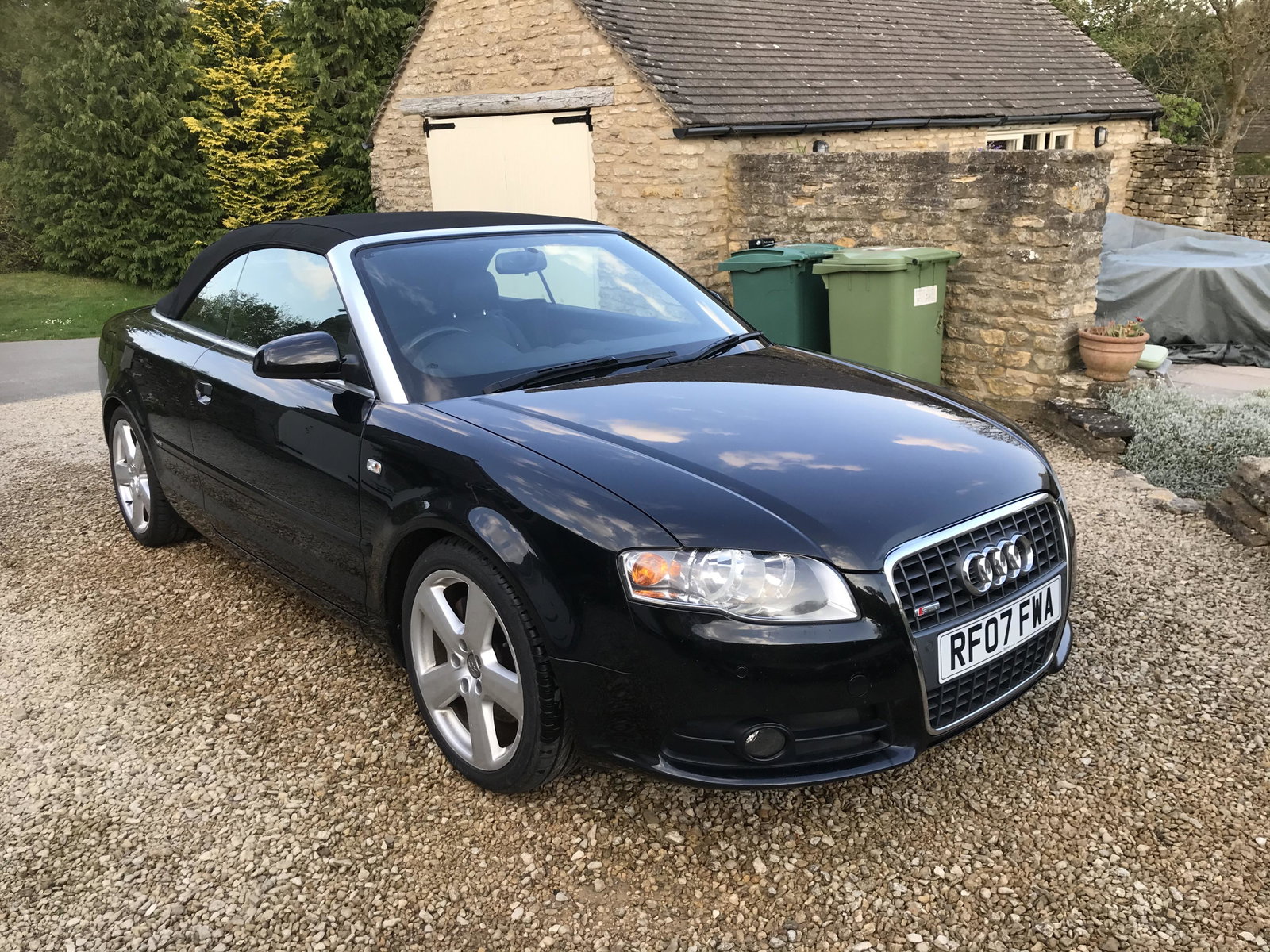

Hi Guys I have a lovely 2007 A4 Convertible however it seems like the roof is not 100% wind proof ie leaks around windows etc ..wind noise....and in the cold weather there is a huge amount of condensation on the interior windows ( especially the rear roof window ) in the mornings. Can the roof be adjusted to fit better. The car was standing for approx 4 years when the previous owner  became very ill.
