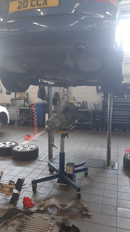

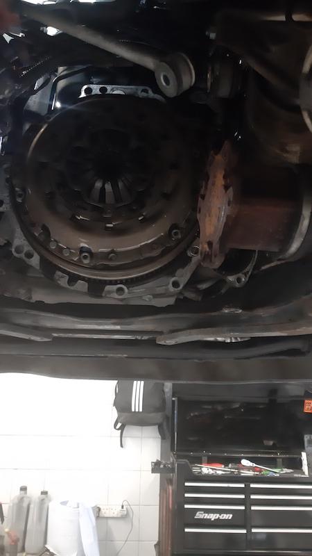

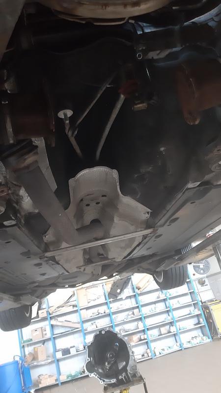

gsmdo Posted May 17 Author Report Share Posted May 17 I dropped the convertible into Norwich Audi late yesterday (when I could get a lift back), and told them I was happy for them to have it for a couple of days if needed. My buddy Kev has just sent me the following pics, and tells me the jobs are going well...🤞😃 1 Quote Link to comment Share on other sites More sharing options...
Steve Q Posted May 17 Report Share Posted May 17 31 minutes ago, gsmdo said: I dropped the convertible into Norwich Audi late yesterday (when I could get a lift back), and told them I was happy for them to have it for a couple of days if needed. My buddy Kev has just sent me the following pics, and tells me the jobs are going well...🤞😃 That's great to hear 😊 always nice when no other problems arise. Quote Link to comment Share on other sites More sharing options...
