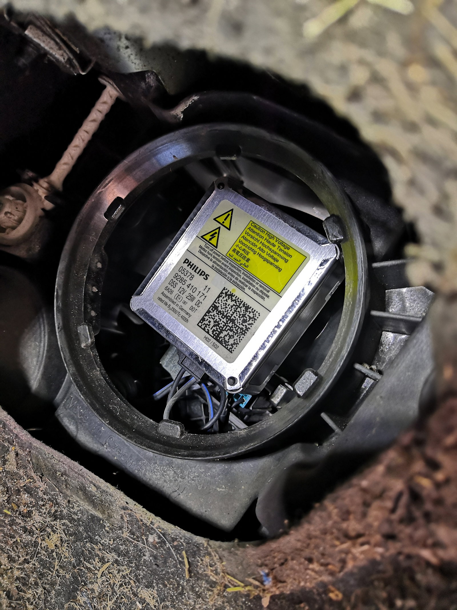

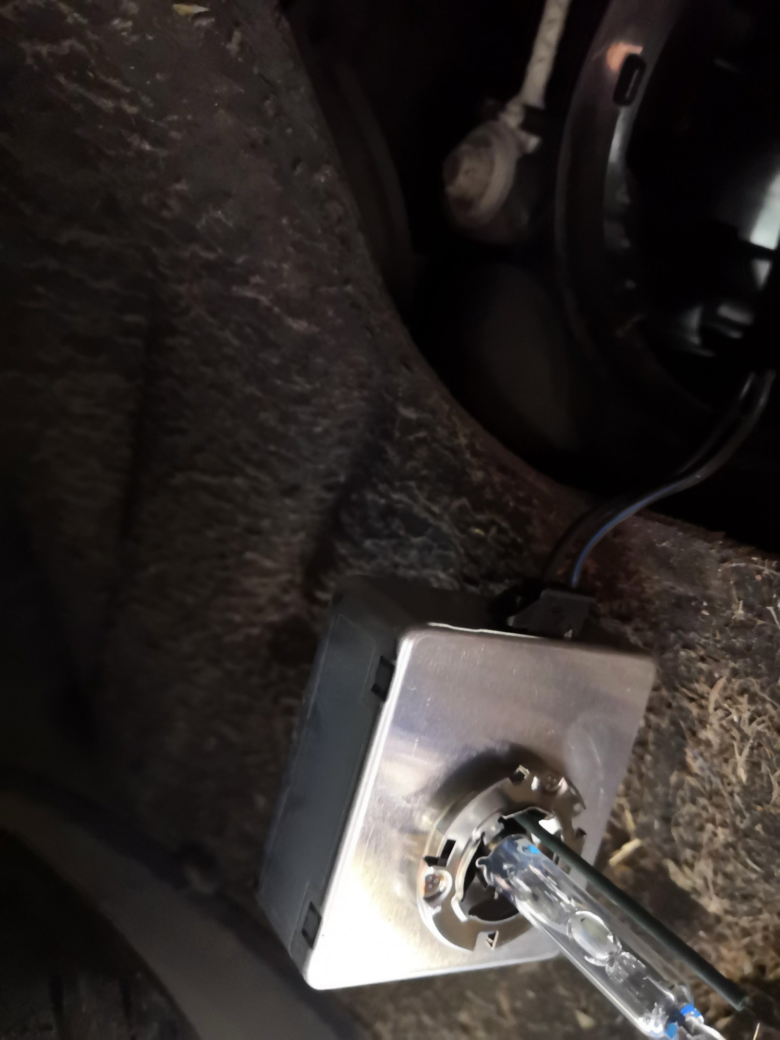

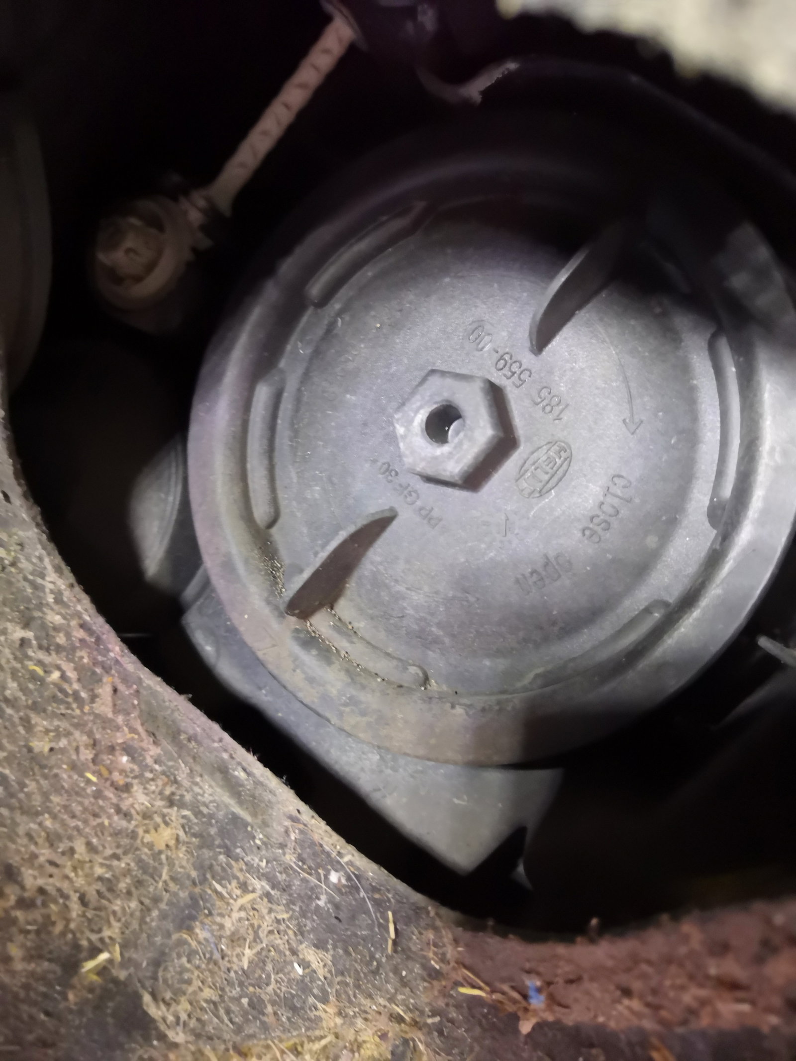

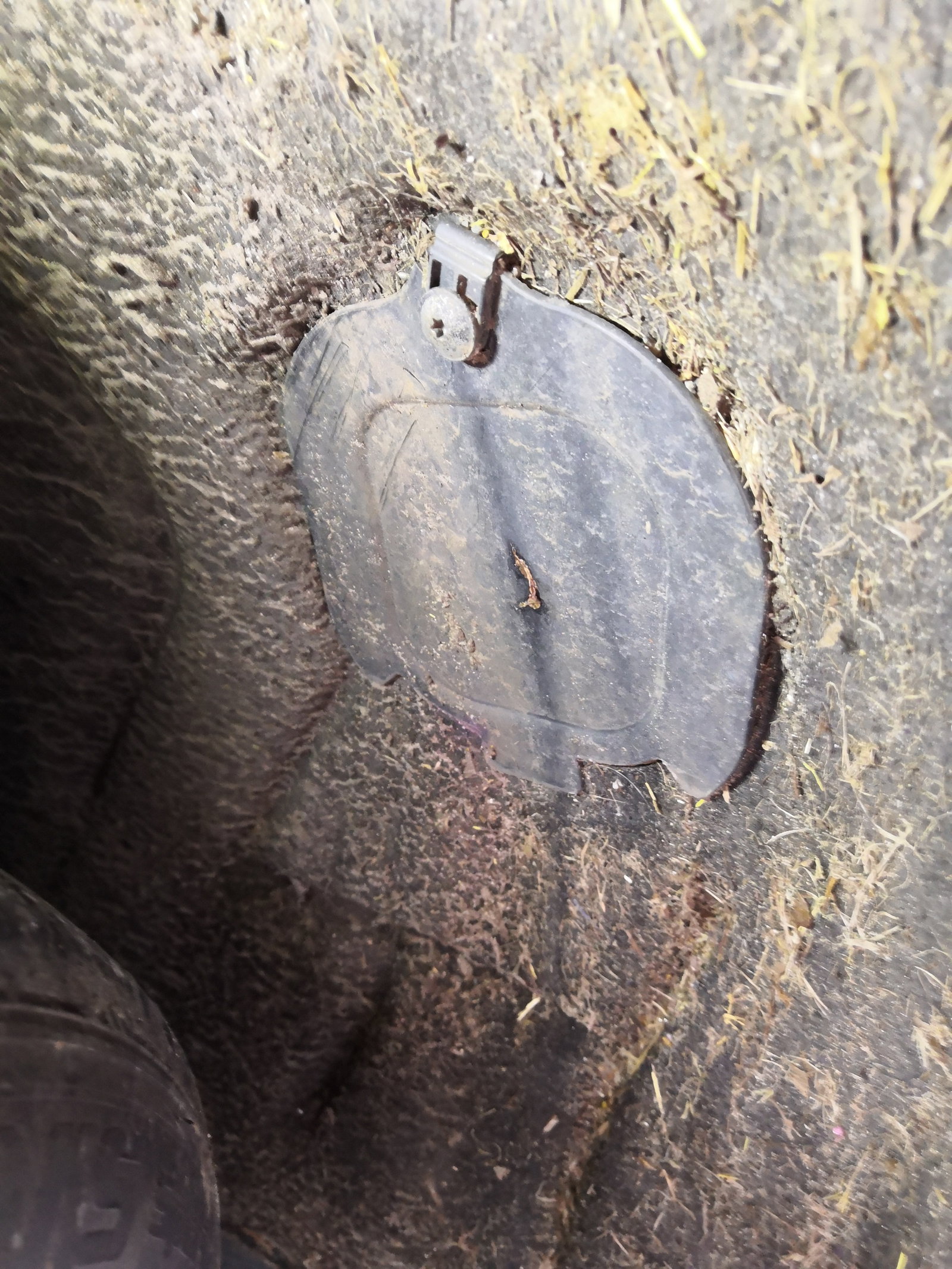

Hi if it has the fish eye projector lenses they are what is known as shuttered beam headlamps there is a metal plate that moves electrically to cut the light output for dipped beam and when it is moved down by the solenoid thats main beam, the access is via the port under the wheel arch and with the wheel off/on is fairly easy to get at and depending on what type of bulb D5s just twist out and D3s will have a plastic Collar which is a bit more of a faff but twists out as well.
