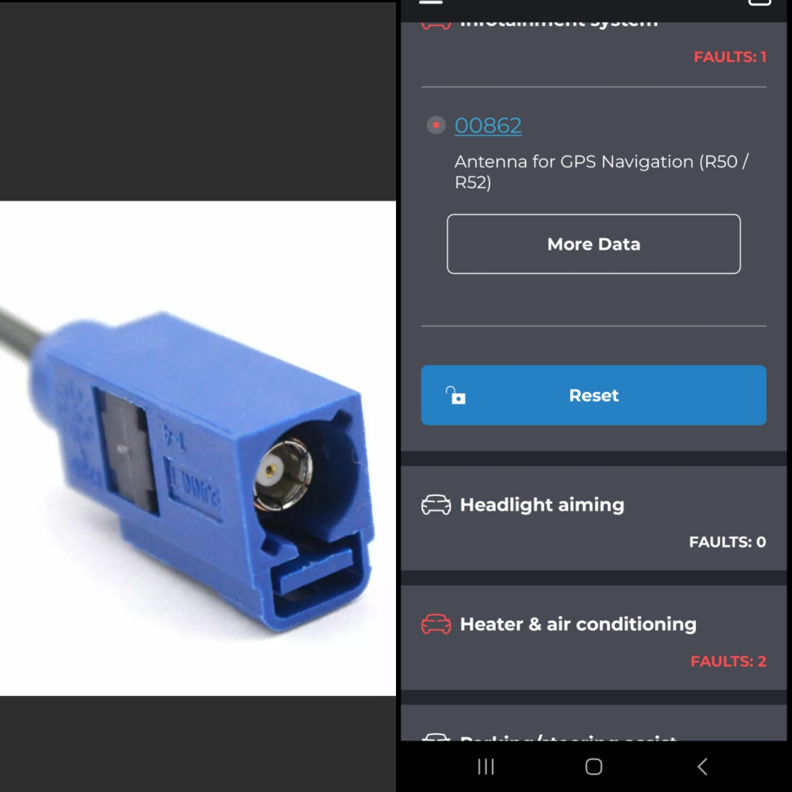

a6blacked007 Posted March 28 Share Posted March 28 Will probably be gps antenna mines knackered too 2013 common fault apparently. Quote Link to comment Share on other sites More sharing options...
a6blacked007 Posted May 3 Share Posted May 3 https://www.ebay.co.uk/itm/185551737107?mkcid=16&mkevt=1&mkrid=711-127632-2357-0&ssspo=r_uccv0-tkm&sssrc=2349624&ssuid=fkCuma5CT1u&var=&widget_ver=artemis&media=COPY This fixed mine perfectly @ £4 am confident it's yous problem too. Just remove mmi unit & remove blue plug behind insert new blue gps plug stick gps unit under dash Refit mmi unit and your done. 1 Quote Link to comment Share on other sites More sharing options...
