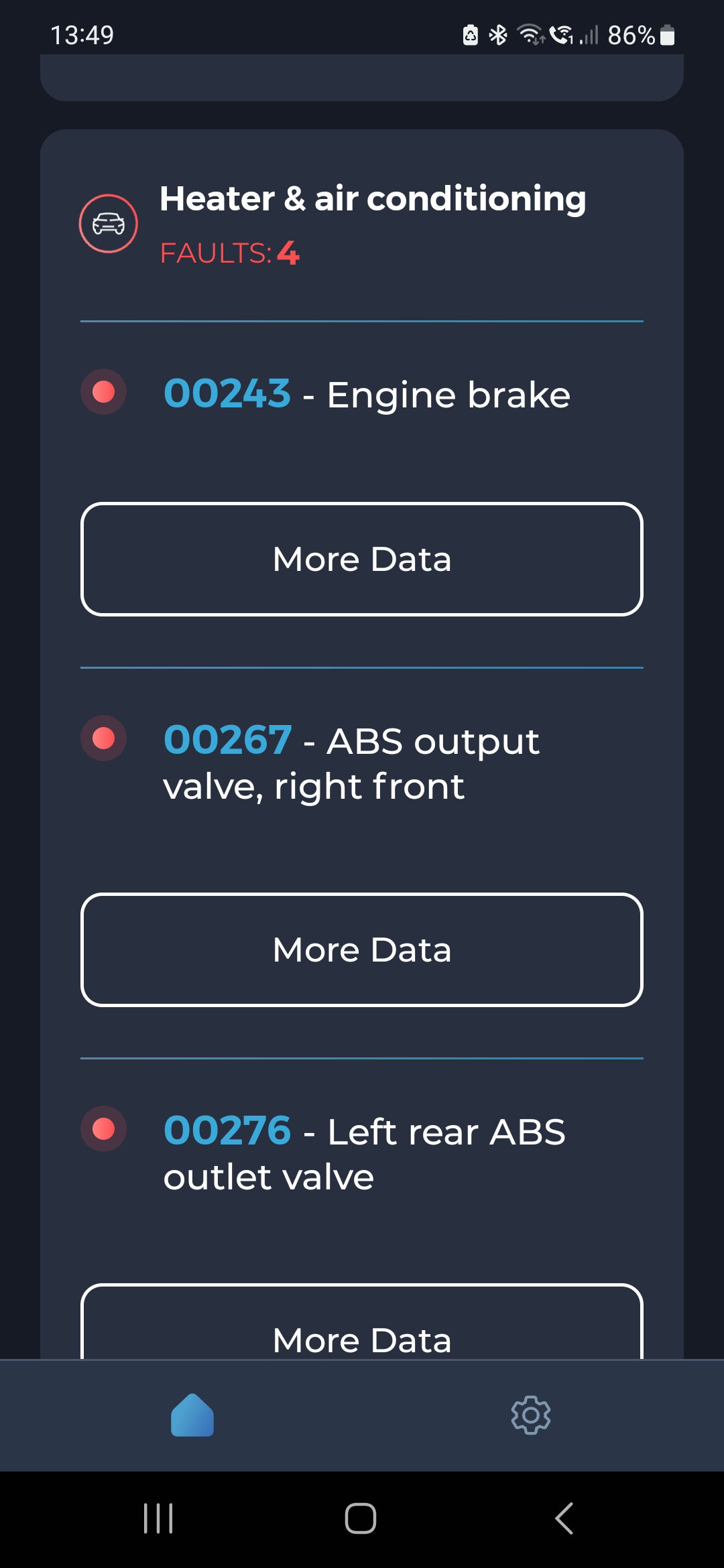

Just to chip in all of my abs flat tyre message's arrived back yesterday.
I was changing the gps antenna for a ebay cheaper unit successfully 🫡 all my wires behind mmi and air con were disconnected immediately got all abs errors connected all back up and just left air bag light on removing that with carista bit of a long shot but could that have been my issue or yours all errors gone again will report back if they arise again.
All errors have cleared ...
Must be some sort of wiring issue
