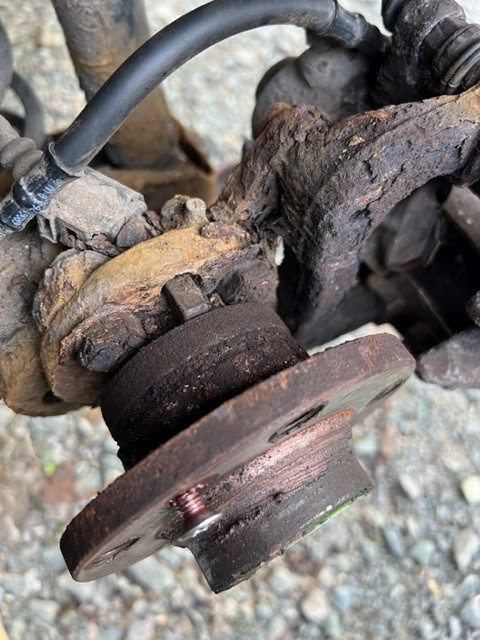

Pigsfoot Posted May 20 Author Share Posted May 20 Thanks @Stevey Y, that's what i thought originally but i have the disk and caliper removed at the moment. I can see the mounting bolts for the plate behind the hub and they seem pretty long as you can see the back of them. The gap between the hub and bolt head is to small to remove the bolt completely so no idea how you would get them out. Only thing i can think of is as you undo the bolts the hub becomes loose and you have to undo each bolt as much as possible so you can pull the hub forward and then undo the bolts further. Seems like a lot of work just to replace a dust plate? I have attached a photo to show you, the caliper is just loosely attached at the moment so it doesn't hang off the pipes. I also pulled the dust plate off so i coudl see further as it was rusted through anyway. Quote Link to comment Share on other sites More sharing options...
Magnet Posted May 20 Share Posted May 20 As far as I’m aware Rod, the hub normally has to come off so that you can get at the mounting bolts and remove them completely. Looks like you are going to need some new mounting bolts as well. Pessimistic maybe, but removing the current ones could be a bit of a challenge for Releaseoil. Kind regards, Gareth. Quote Link to comment Share on other sites More sharing options...
Pigsfoot Posted May 20 Author Share Posted May 20 27 minutes ago, Magnet said: As far as I’m aware Rod, the hub normally has to come off so that you can get at the mounting bolts and remove them completely. Looks like you are going to need some new mounting bolts as well. Pessimistic maybe, but removing the current ones could be a bit of a challenge for Releaseoil. Kind regards, Gareth. Based on all the other bolts I have removed I would 100% agree Gareth, any idea on how to remove the hub though Quote Link to comment Share on other sites More sharing options...

Magnet Posted May 21 Share Posted May 21 Many thanks Stephen, I’m estimating £217 at Audi equates to no more than 1.5 hours, so probably not rated as a big job - with the right tools and no rusty bolts! Hello Rod, You be lucky to get away with removing hub without a good hub puller, but you could be lucky and it will tap off with a good non-metal mallet if ( in caps) you can get behind the flange. Kind regards, Gareth. Quote Link to comment Share on other sites More sharing options...
Stevey Y Posted May 22 Share Posted May 22 On 5/20/2023 at 8:03 PM, Pigsfoot said: Thanks @Stevey Y, that's what i thought originally but i have the disk and caliper removed at the moment. I can see the mounting bolts for the plate behind the hub and they seem pretty long as you can see the back of them. The gap between the hub and bolt head is to small to remove the bolt completely so no idea how you would get them out. Only thing i can think of is as you undo the bolts the hub becomes loose and you have to undo each bolt as much as possible so you can pull the hub forward and then undo the bolts further. Seems like a lot of work just to replace a dust plate? I have attached a photo to show you, the caliper is just loosely attached at the moment so it doesn't hang off the pipes. I also pulled the dust plate off so i coudl see further as it was rusted through anyway. Hi the hub is a one piece unit get the speed sensor out and brush the crud off of the ends of the bolt threads and soak the threads with plus gas if you leave it for an hour it should penetrate use a good quality ring spanner and once loose work the bolts loose and then back and forth while hosing down the threaded bit with release agent, failing that heat the threaded end housing with a blowtorch then try, if you use a puller you will annihilate the bearing as they are pressed on to the hub at the factory, the bearing will follow the hub as it comes off. Steve 1 Quote Link to comment Share on other sites More sharing options...
