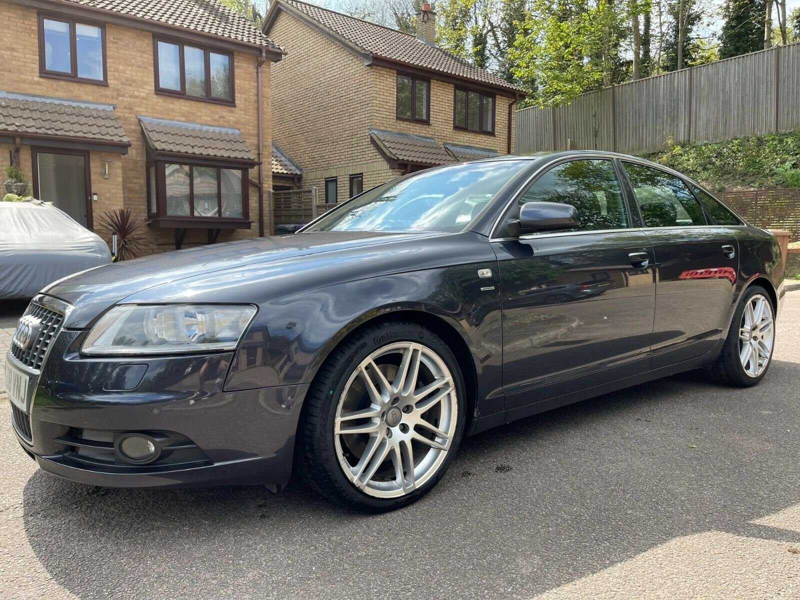

had to take the bumper off today to remove and refit a new air con condenser and found a dead bird up along side my headlight, its broken the fixing lug, iv'e looked on line but there seems to be so may different types, can anyone help at all?

Hi is that so many different types of bird or lugs?, if you strip the front scuttle panel that runs across the front of the radiator the part number should be on the top of the headlight, plumb that in and the fact you need a lug repair kit and based on the right part number a kit should appear.
Have ordered a lug repair kit, seems to be a lot cheaper.

Well done Tony, the older repair kits are cheaper as the market for them is diminishing and no parts supplier wants a few hundred of the kits for garden ornaments.
