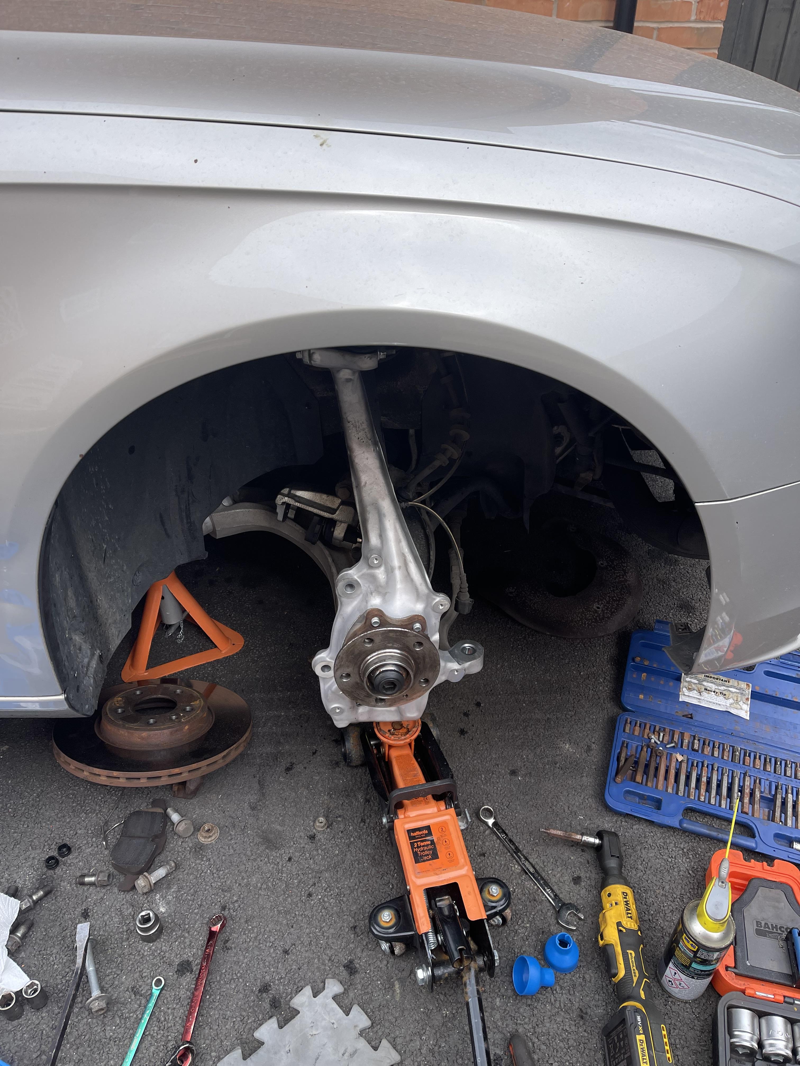

And that’s what’s throwing me the noise is the same regardless of road surface, straight, left or right hand bends etc. the garage thinks it’s the drivers bearing. I span both and could only hear anything in passenger so changed that.
I’ve just fitted a new bearing in the new drivers knuckle I have (the bolts seized in my top arms and has been on my list a short while - I don’t have facilities to heat or burn the bolt out)
so tomorrow AM when it’s hopefully not too warm I’ll swap it over and do all the arms and ARB link at same time (another needed job) and if nothing else I’ll have replaced everything on drivers side too but will keep fingers crossed it’s the bearing….
That would be my next normally but all new, well less than 2000 miles. I’ve not noticed lumps or bumps in them when I did the other bearing and no jilting of the wheel….
hopefully it’s the drivers bearing and I just couldn’t spin it up on the drive quick enough. I should’ve jacked it and spun it with the engine although that wouldn’t eliminate the gearbox but at least I could isolate sides…
Road tested and was bearing. I’m still baffled in honesty, nothing in the bearing spun by hand and feels lovely and smooth - never had a bearing like that in 20+ years but pleased its not the gearbox or not yet.
new knuckle (couldn’t get the bolt out) all new arms, ARB link which all needed doing.
the photo is the bearing from pass side which I fitted around 10k ago (I only had one new one which went on pass side around a week ago while trying to track the noise. I don’t like fitting a used bearing back but it was for proving purposes and have ordered a new new one to pop in next week.
Tracking tomorrow
