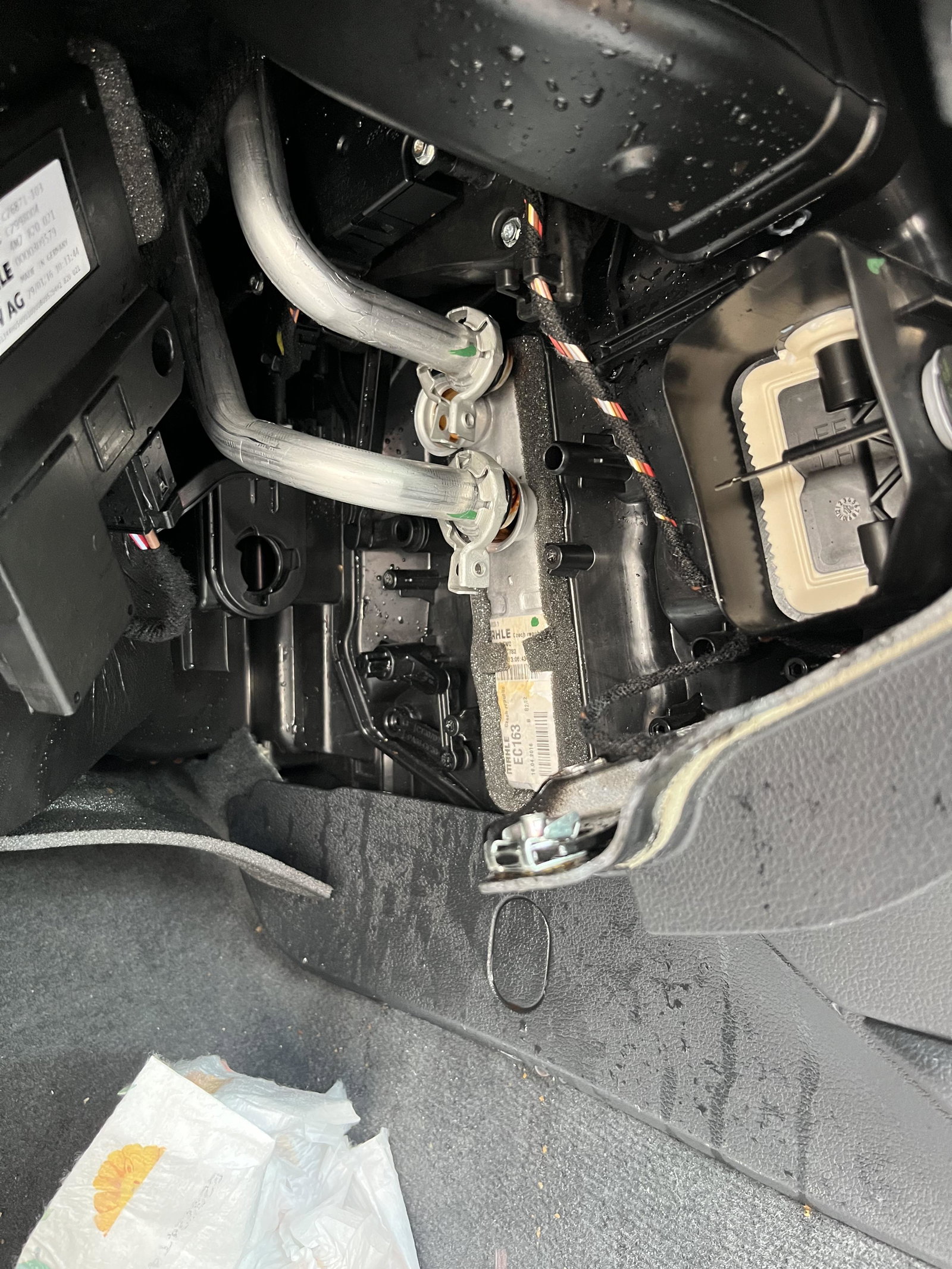

Hi,

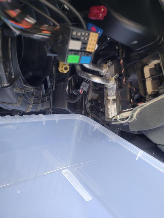

currently trying to replace blocked heater core.
so far have only got under glovebox and realised I can’t actually slide the heater core out due to another part blocking its path out.
anyone else done this and have any ideas?
do I just need to start removing the rest of the part(s) under the glovebox?
picture attached - the part I’m talking about is the black box to the left of the heater core.
thanks

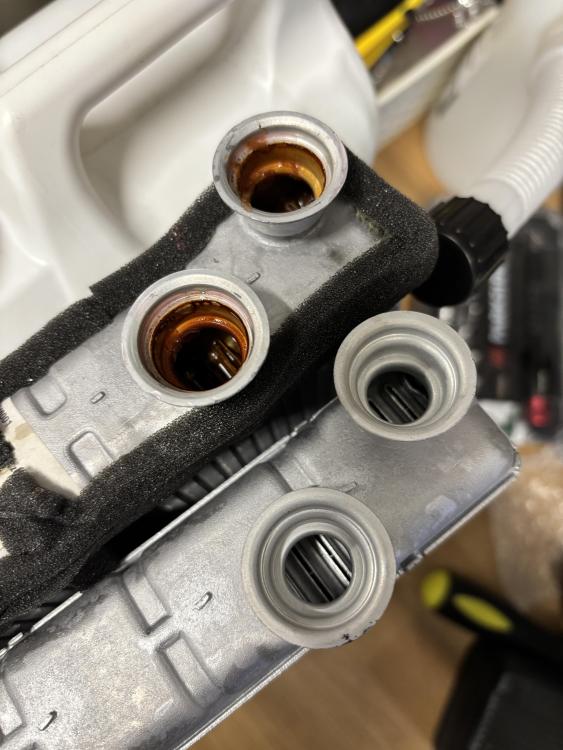

  • Hi,  I had very little knowledge or experience with cars, so the steps I mentioned earlier were as far as I could manage on my own. Fortunately, I found a mechanic who was able to assist. I’m not
  • So i have done the Heater core matrix change and it was not difficult without any mechanical knowledge, however would recommend to have someone to help you as at some stages it looks like you need ano
  • I originally had intermittent heat, this then became no heat. I just googled around to see what the issue could be. That pointed me to some coolant “bag” issues some people were having.  this relate
Posted Images

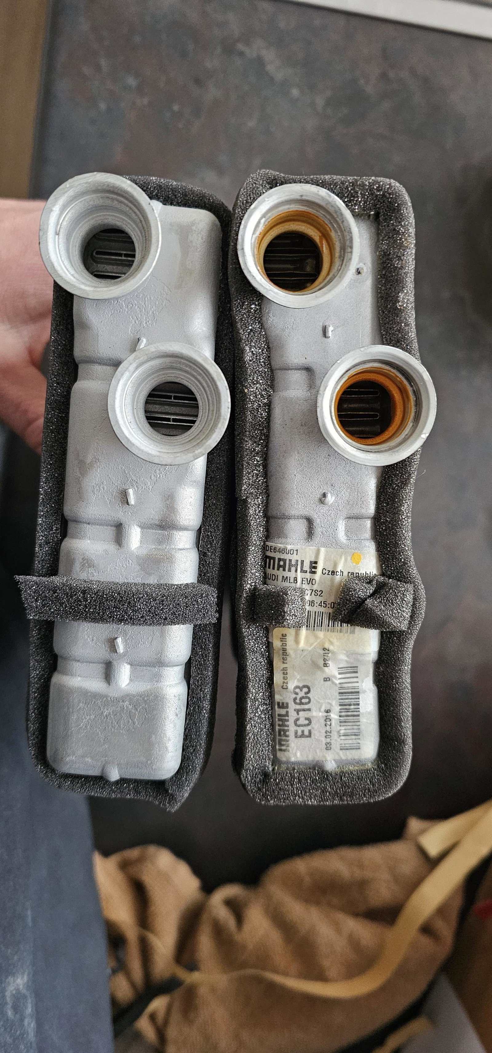

this related to there being silica bags that would burst and cause a blockage in the heater core which in turn would lead to limited or no heat.
if you have a helpful garage close by you could ask them to flush the heater core for you. Or there are videos online if you’re confident with trying this yourself.

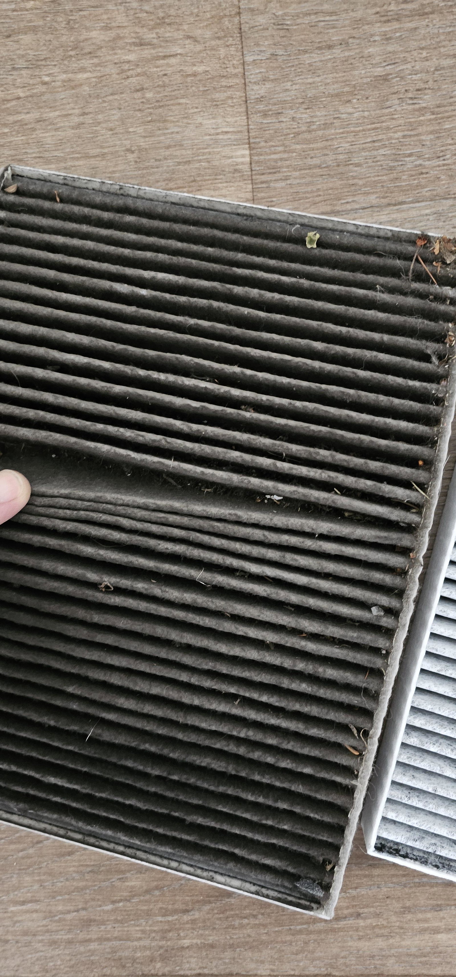

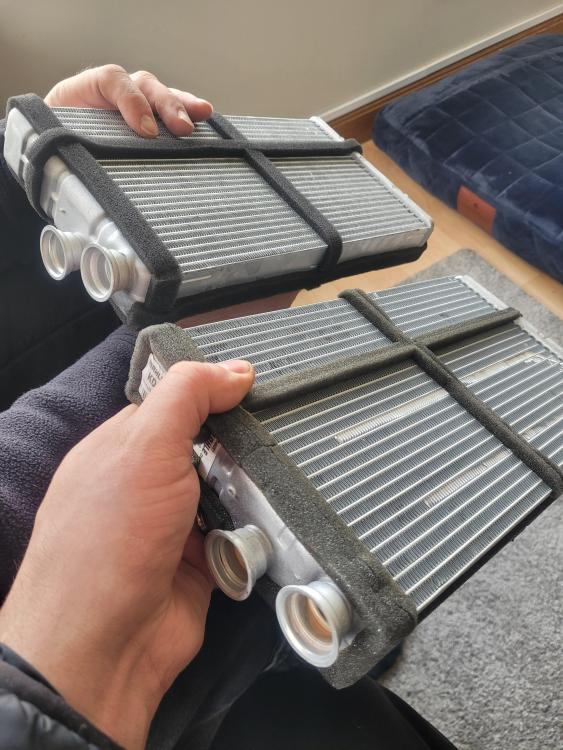

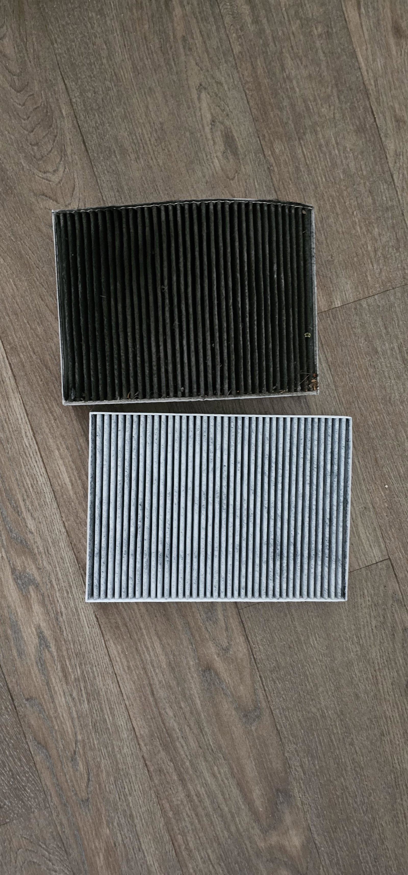

RESULT!!!

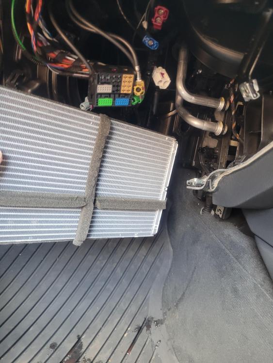

So I finally got round to swapping out the heater core and it's done the job! It took me a total of 2 hrs and I'm not a mechanic!
Every garage I took it too either didn't want to do it or said it would be £1500 and 2 days to do it. I'd say give it ago your self, it's fairly straightforward. There's 2 things I'd change if I had to do it again... number 1 don't get drunk the night before 🤢 spent way to much time upside down for that! And 2. Get a flexi drill bit to get in the small spaces.. there's so many screws!!!
I'd recommend whilst your there changing your pollen filter.. mine was disgusting!
Also disconnect the battery first, for when your unplugging the air bags.
Other than that the only additional thing I had to take off was the blower motor on the back of the pollen filter, this gives enough room to slide the core out, in turn of this undo the 2 bolts on the media unit and slide it forward an inch. It just helps with the room

It didn't come with new seals and fittings so you'd need to buy new. I shamefully used the old ones because I didn't realise it didn't come with them.
The foam comes with the radiator you just need to stick it on your self, I just copied the old one like for like.
So I'd already had 2 flushes on the system before this to see if it would solve the issues. Obviously it didn't, however the coolant I got out of the pipes at the core was clean! So I'm not worried of any deposits left in.
Hope this helps

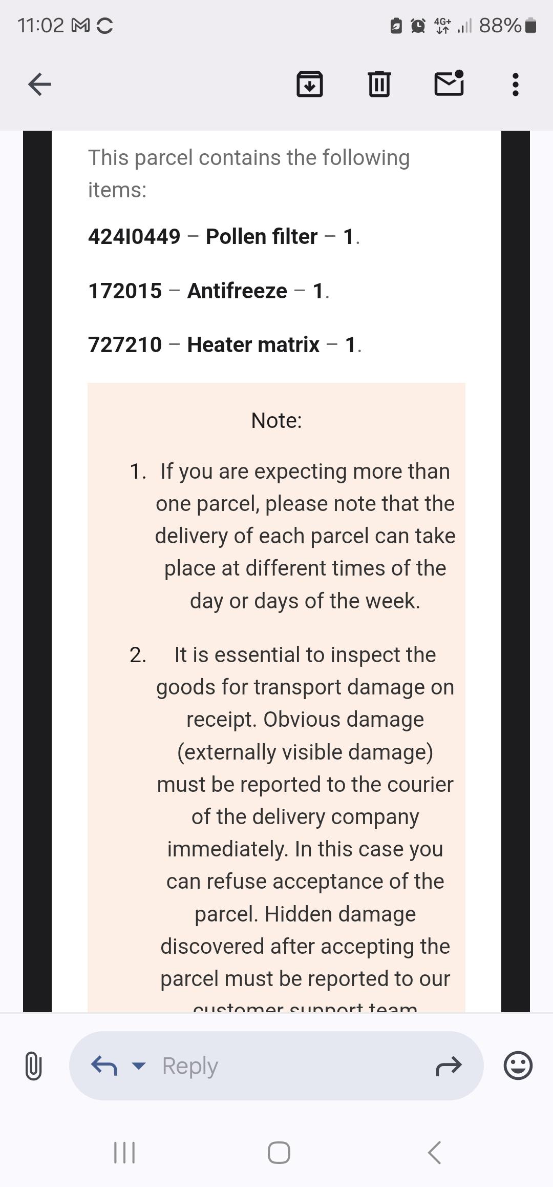

I've posted a screenshot further up the chat of the Heatercore I bought on Autodoc.com.
1 hour ago, squish14 said:
Yeah that's the exact same scenario I had from the 1st 2 garage mate.
Sounds promising then; I’ll buy tonight.
The number on your order (727210) is for OEM part number 8w0898037, which is the same number I found…so that’s good. Can’t seem to find one from the UK though, so Germany it is!!
