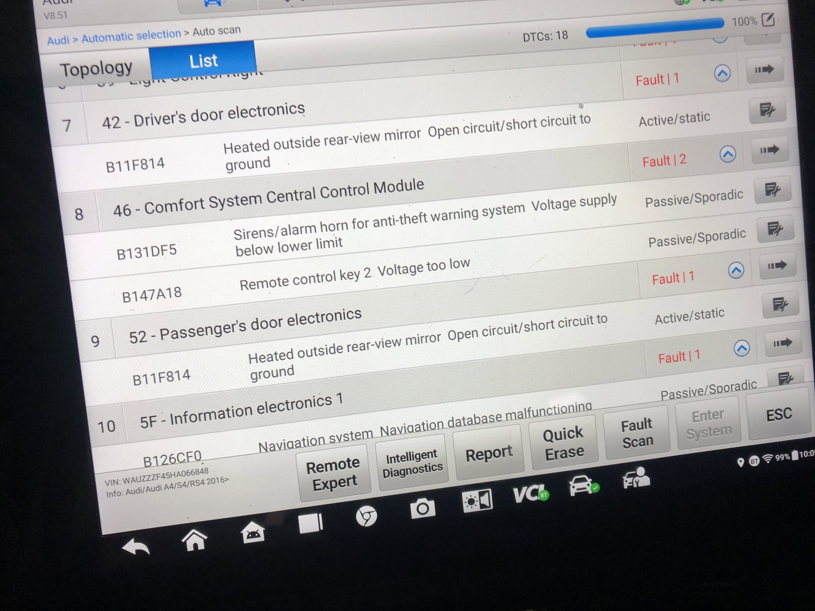

My car alarm has been going off all night. When we switch it off it then goes off again. I took it to local garage and they plugged it in and said voltage below limit. Only way is to take it to the dealer. Leave it unlocked! Rang dealership and they are so busy they will call back and just to call RAC!
looks like a month before I can book it in. That leaves my car unusable until it goes into the dealer. They still haven’t called back. Tried clearing leaves shutting doors and pressing button on inside driver door. Nothing working. Tried everything (non mechanical) suggested on here as I haven’t a clue. Is there any way of locking it without alarm until Audi can do it please? I’ve tried all I can see on utube. If I leave it open it’ll be stolen. Someone please help I’m desperate. Attached the report when garage plugged it in. It’s A4 avant S line 66 plate. I’m demented with no sleep.

Hi, assuming you have tried using the actual key (not remote fob) to lock the car?  I thought doing that doesn't enable the alarm?  Correct me if i'm wrong anyone.
Generally, how long have you had the car?  Service history, etc.  Just wondered, as there are a number of faults from the scan?  18?
Thanks, Joe
Hi no I haven’t tried that but I will if it goes off again tonight in the storm forecasted. It’s a 66 plate and i usually have it serviced and MOT locally not at the dealership. I’ve been told it needs updates but didn’t realise there’s 18 faults. Omg
i don't know if it is 18 faults, it is just what i see in your snapshot.  It wasn't to worry you.  7 and 9 seem to be the same sort of fault.
I don't know what other fault finders do when they find fault codes from a scan, but i would (and have) cleared all faults codes, then run the car as you would do, and then do another scan.  I there is a problem, my thought is that the code would come up again.  Not sure if that is the correct way, but anyone is happy to correct me.

Yhe garage who fault checked it this morning tried to clear the faults but they came back on! I’m just losing the will to live with it and just now want to find a way to stop it going off until Thursday then I guess I’ll need a mortgage to get it fixed. I’m grateful for all input. Just seen we could have a tornado coming on the south coast. Thanks just want to know if I don’t lock it will the alarm stay off.
