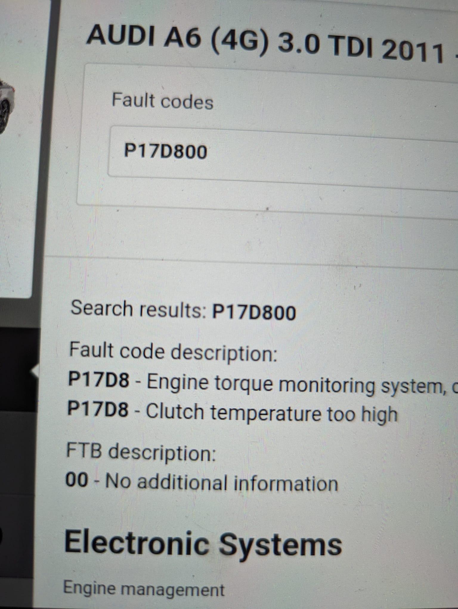

Byron1247 Posted November 24, 2023 Share Posted November 24, 2023 Hi i have an Audi A6 3.0 V6 TDI Avant 2011, it has 160,000 miles, I have recently had a warning on dashboard coming up saying: Gearbox overheating please adapt driving style I have plugged a diagnostic in and coming up with the below code Code: P17D800 (please see picture) reduced tourque due to clutch temperature. Warning comes and goes randomly and stays on for a couple of seconds and goes off. Is anyone able to help with what could be causing the issue ? Quote Link to comment Share on other sites More sharing options...
