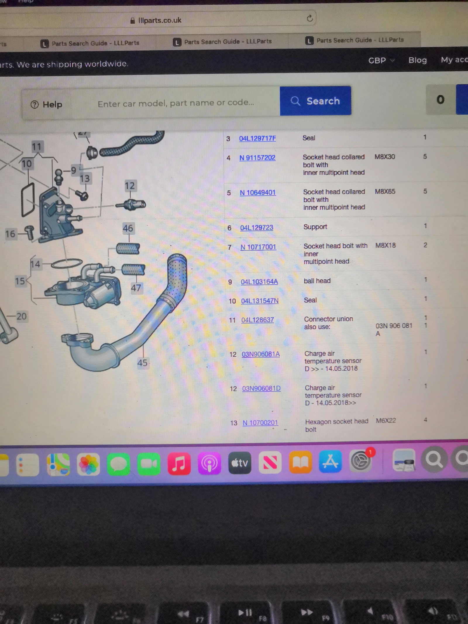

Hi the AIT sensor is bolted in to the throttle body and is a different element completely the map sensor wont measure temperature, but you could try taking the AIT sensor out and cleaning it as they do get coated and wont read properly
Steve I was advised that was the charge air temperature sensor but apparently the intake air temperature sensor is integrated into the MAP sensor on the end of the rubber tube. Have other issues too….changed my heater support pump but still getting an error. Runs fine when you test it on output tests but think it’s something else locking it up….when you look at the data intake air temperature on one is showing 44C!
Hi the MAP sensor has no facilities to measure air temperature as it is the same as the DPF sensors it measures barometric pressures, the two air temperature readings come from the MAF and the Air charge temp sensor, these compare the air temperature going in, the MAF, and the temperature of the air going in to the manifold  as the compressed air from the turbo is somewhat hotter than the air going into the MAF between the two they work out what is acceptable within the boundaries of its strategy limits, as for the pump is it the aluminium one to the R/H side of the engine bay, if you could post a picture that would be helpful, only one other question when you replaced the MAF was it an oe Bosch unit as I tried two much cheaper aftermarket MAFs and both failed in short order, ended up buying Bosch again and that cured my problems.
