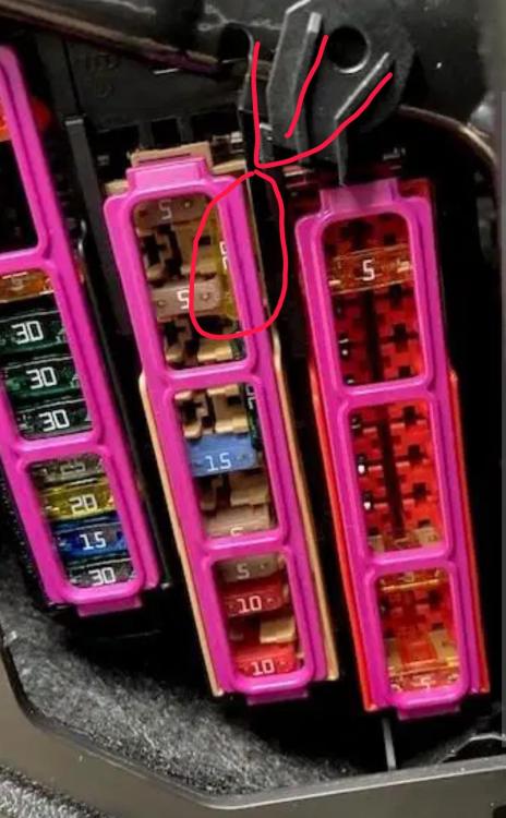

The cigarette lighter has stopped working and I am struggling to locate the fuse.  It's a 2017 A1 1.4TFSi.
The manual suggests the fuse is a 20A fuse located in the end of the dashboard (RHD drivers side).
When looking at where this fuse should be there is no fuse there and no wiring going to where it is stated it should be.
Any body else had this problem and knows where the fuse is located please?
photo shows the fuses. should be a 20A fuse below the 40A fuse (position no.3)
Thanks
Rob

Bank 2 (brown) slot 14, vertical yellow on your photo :)
Found it in original manual
Thanks
