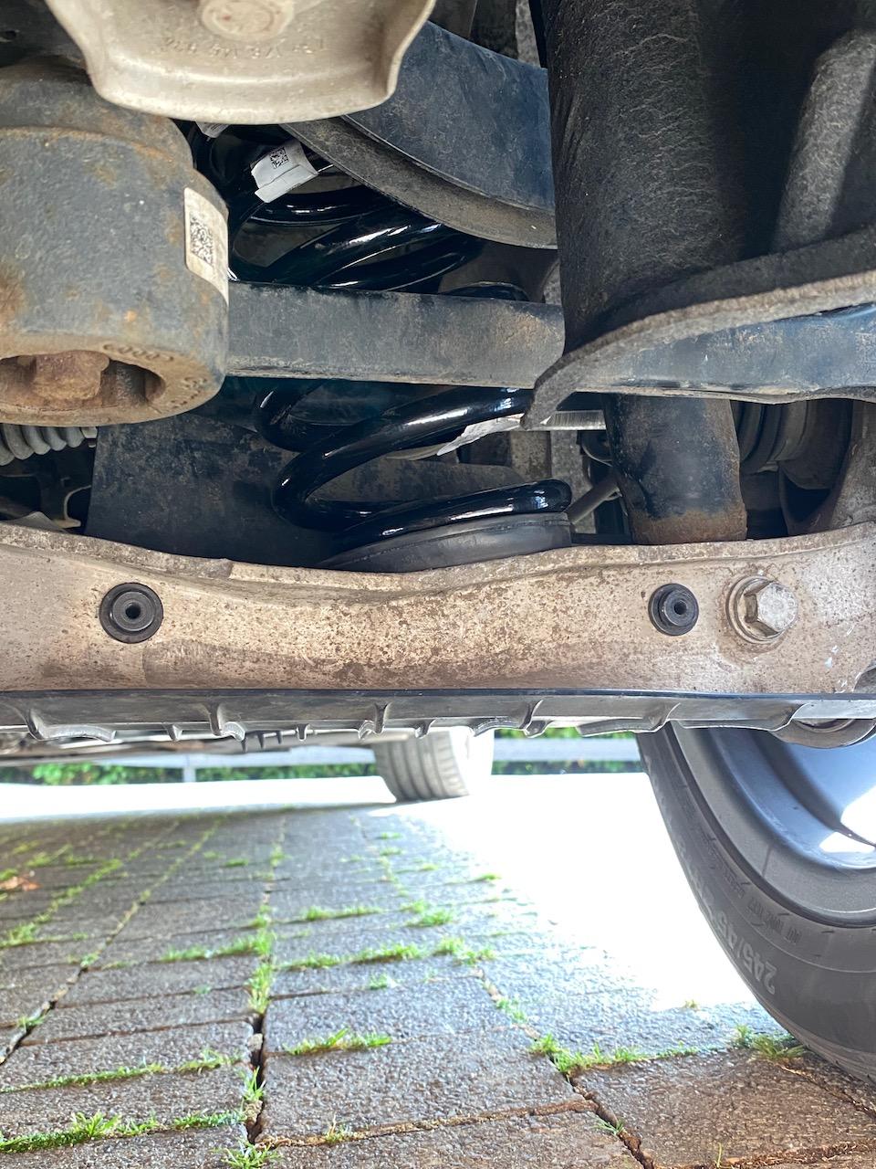

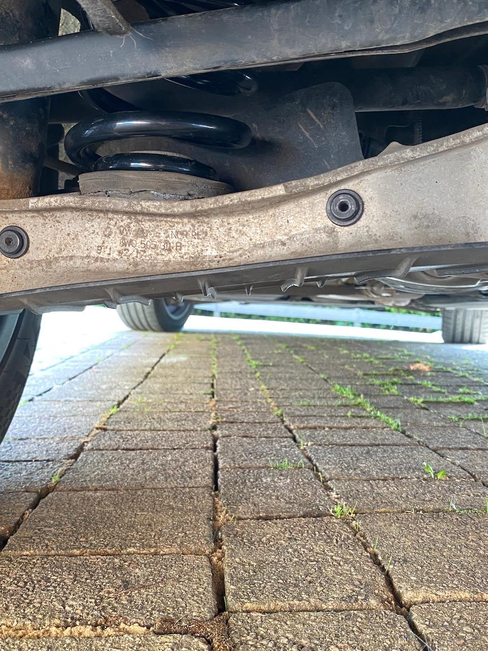

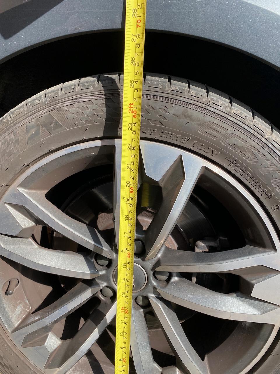

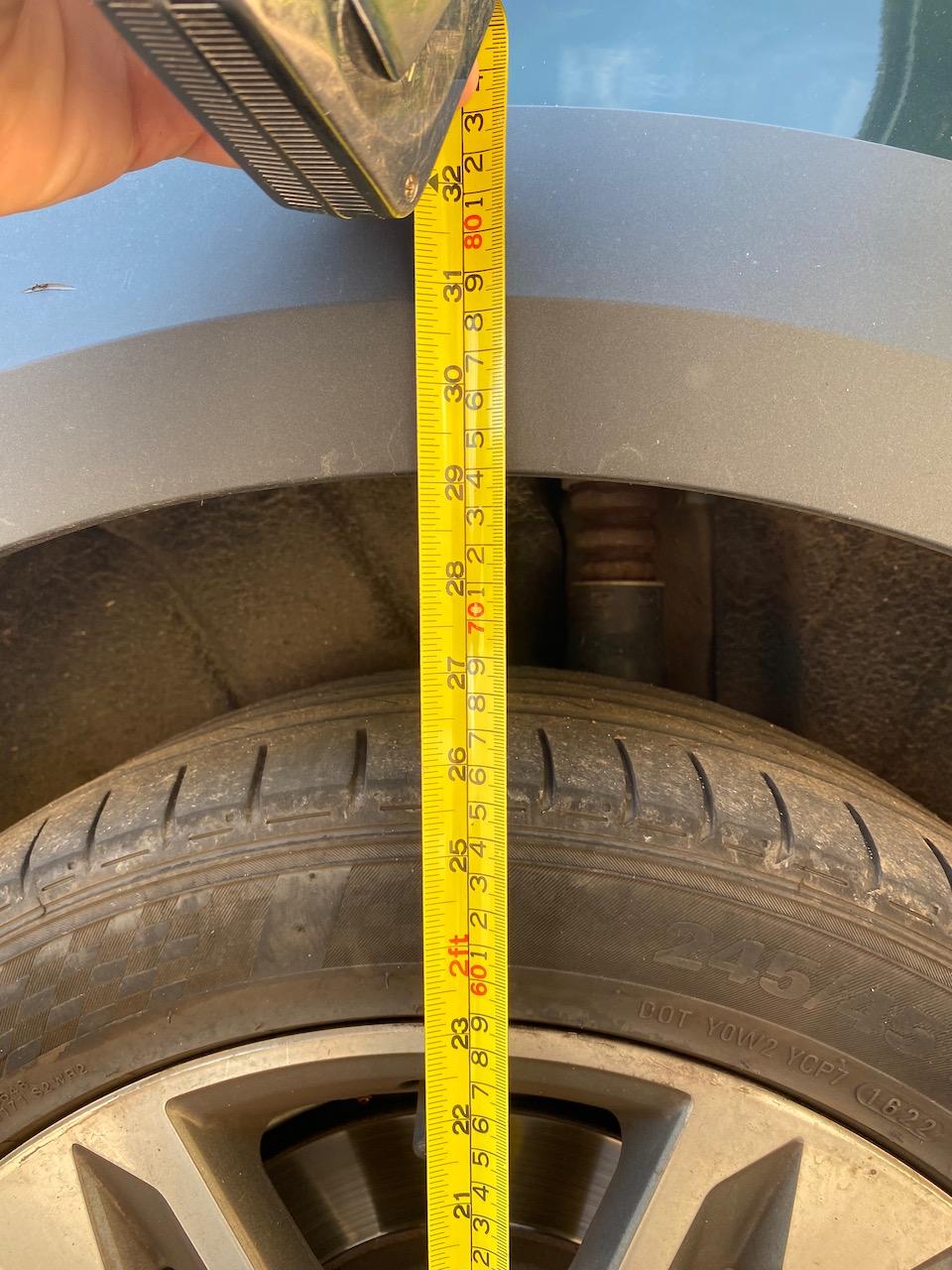

Hi have a 2017 Audi A4 AllRoad (petrol) I have been having problems with my suspension. It failed an MOT due to a crack in the rear offside coil spring and a new one was fitted. After the fitting I noticed the ride height on the drivers side rear was much lower and as a result I have recently had that coil spring replaced as well. This does not seem to have had the desired effect and the drivers side rear is STILL over 4cm lower than its opposite side. I carry quite a lot of weight in the car as I do record fairs and use my car as the transport. Im attaching pics of both sides plus photos showing the difference in heights. Any advice would be welcome, also is this still safe to drive? Thanks SimonJX

p.s. classic wrong way to measure ride height Simon!
Always measure from wheel centre to underside of wheel arch lip - never from ground. Always do measurements on level ground though.

Hi, Simon,
looks to me as if your n/s/r lower spring mounting
rubber is on it's way out as well. by my observation.
if you are going to replace both springs, now would
be the time to replace that as well.
(only trying to help)
Brian.
