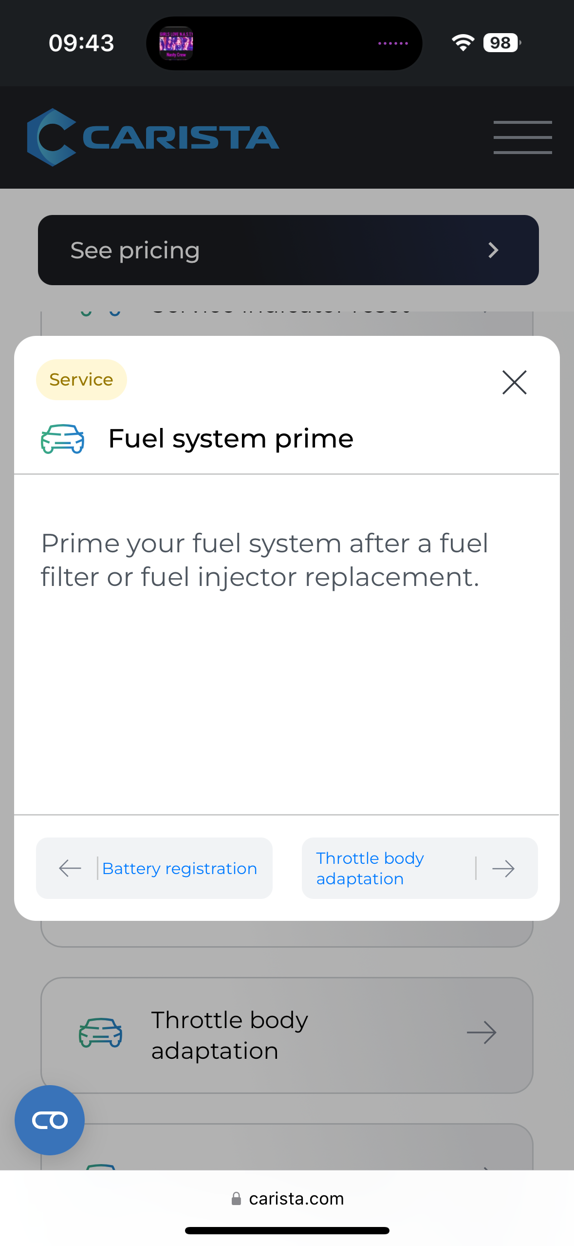

I have Carista and it shows that you can prime the fuel system on their website (see below)
however I’ve seen a few posts floating around the internet saying it can only do it with the C6!
has anyone actually used this feature on Carista on a c7 tdi and can tell me if it worked?
I don’t want to strip the filter off and out the new one on only to find I can’t prime it with what I have. (I do have Carista premium).

  • Solution
Just for some clarity and n this, Carista does indeed do fuel promo by, aswell as gearbox configuration for after changing the oil and pretty much anything else you could need
