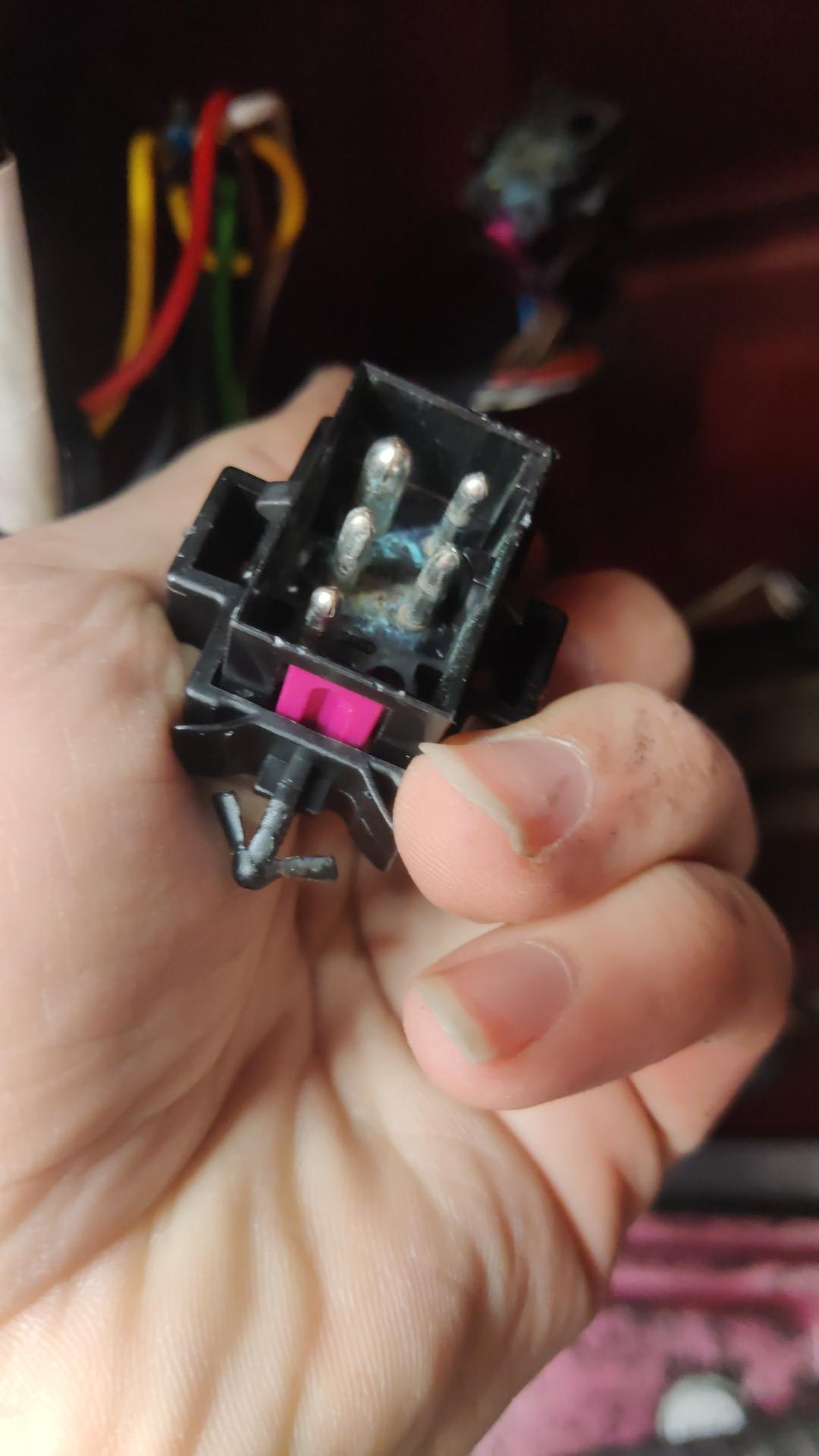

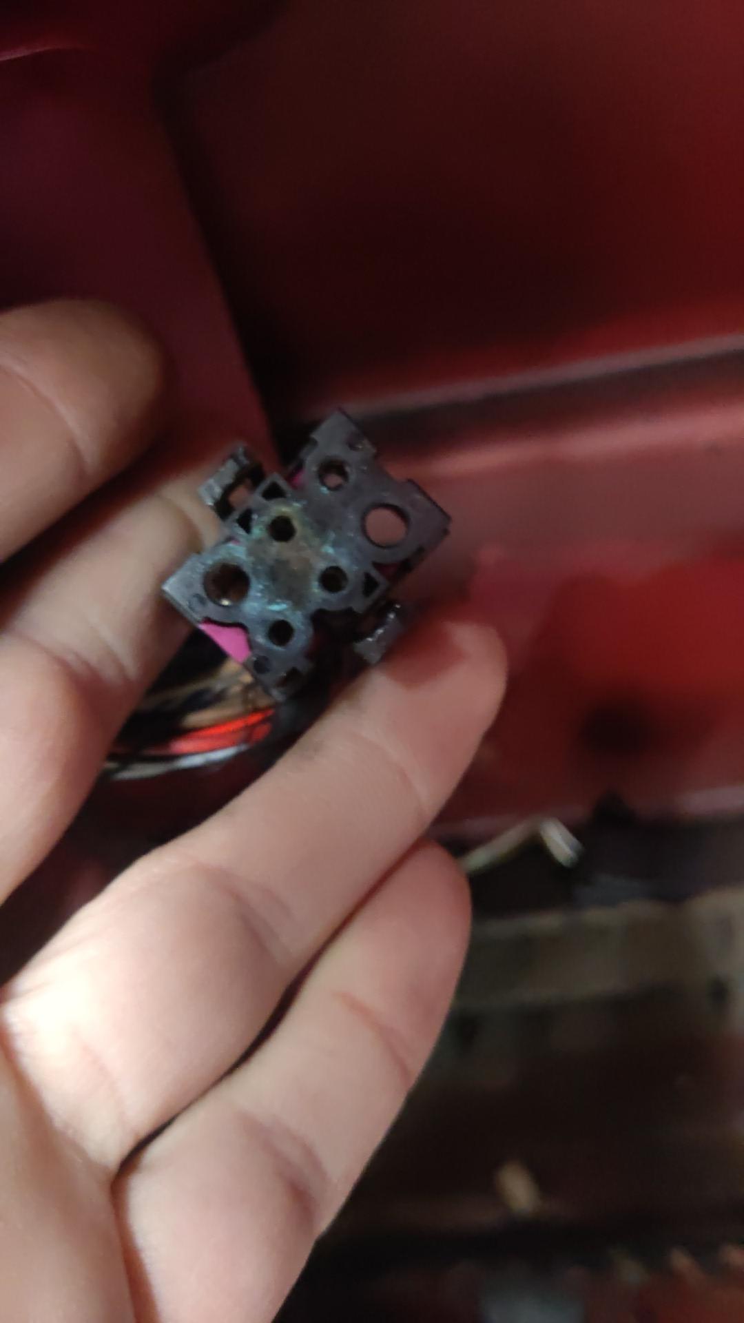

Well the issue might have been found in the boot loom connector. Unfortunately i do not have time to fix it now but i will see in the comig days.

Damn. Was not the connector.
