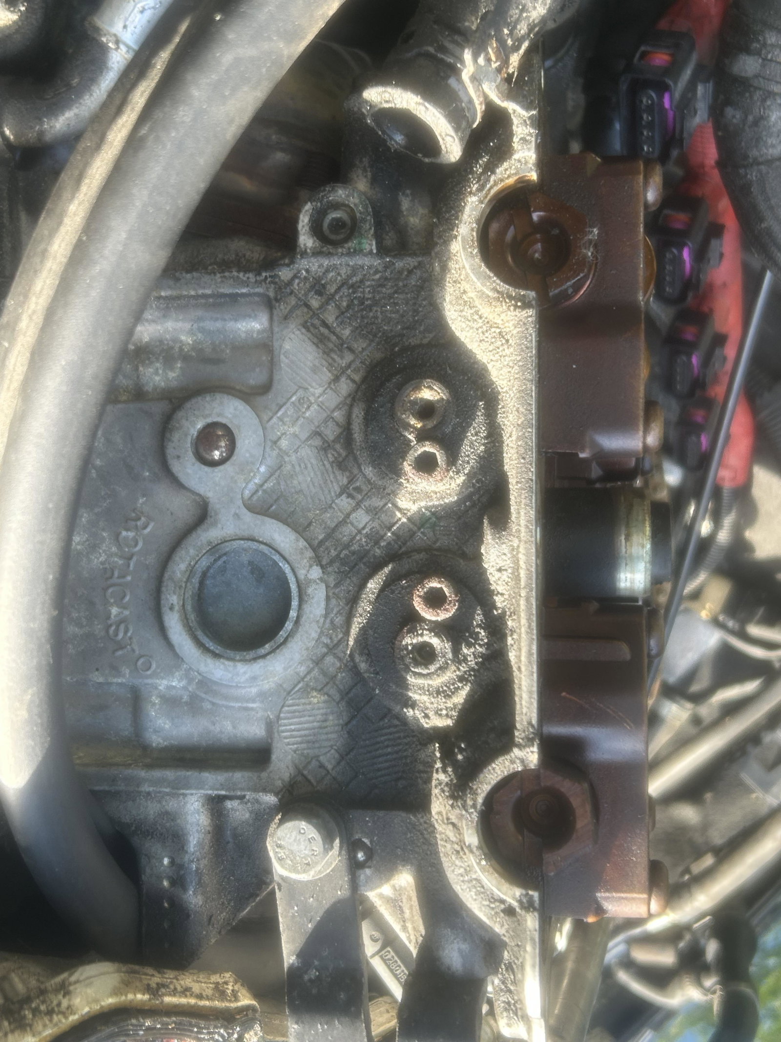

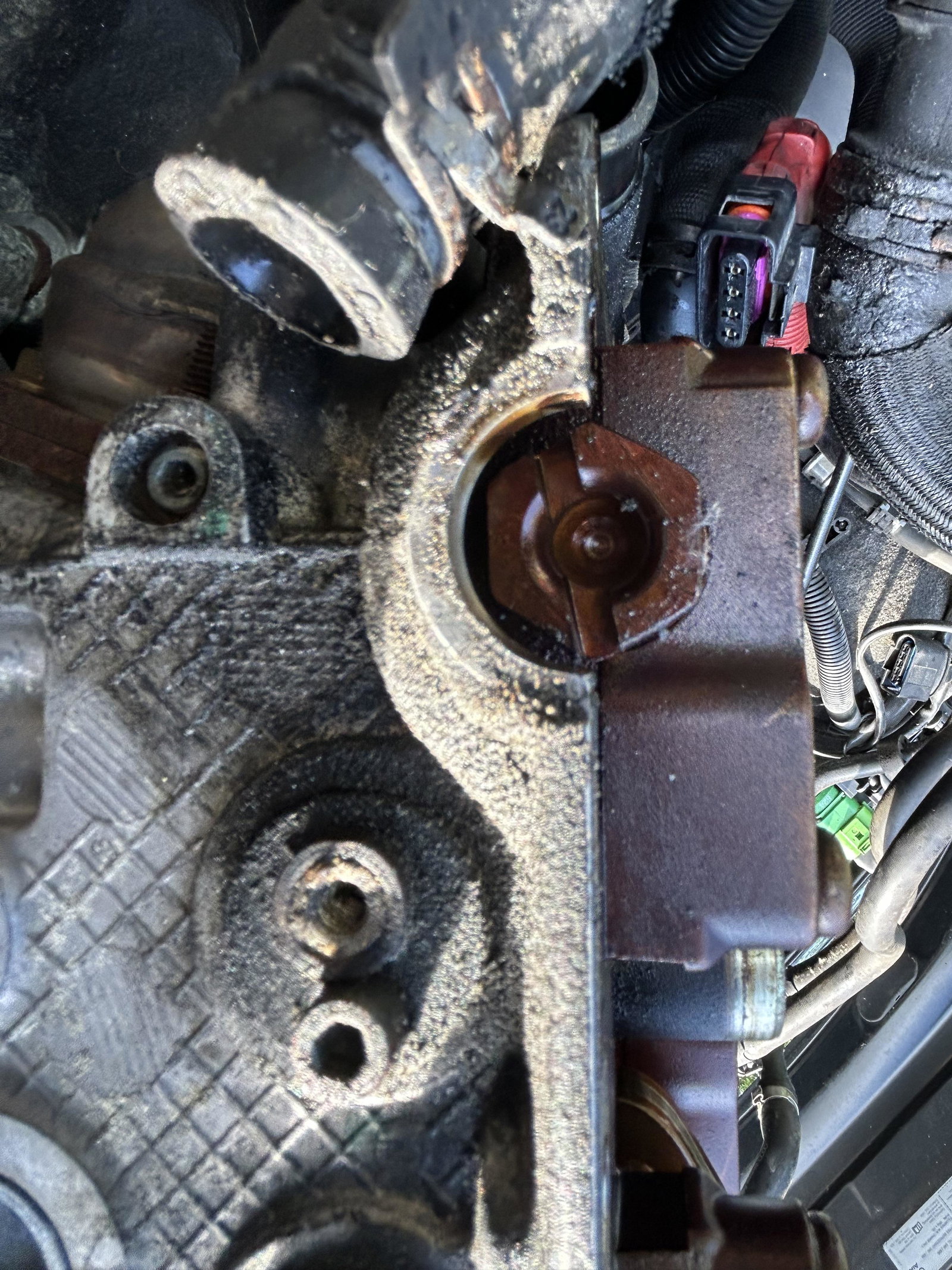

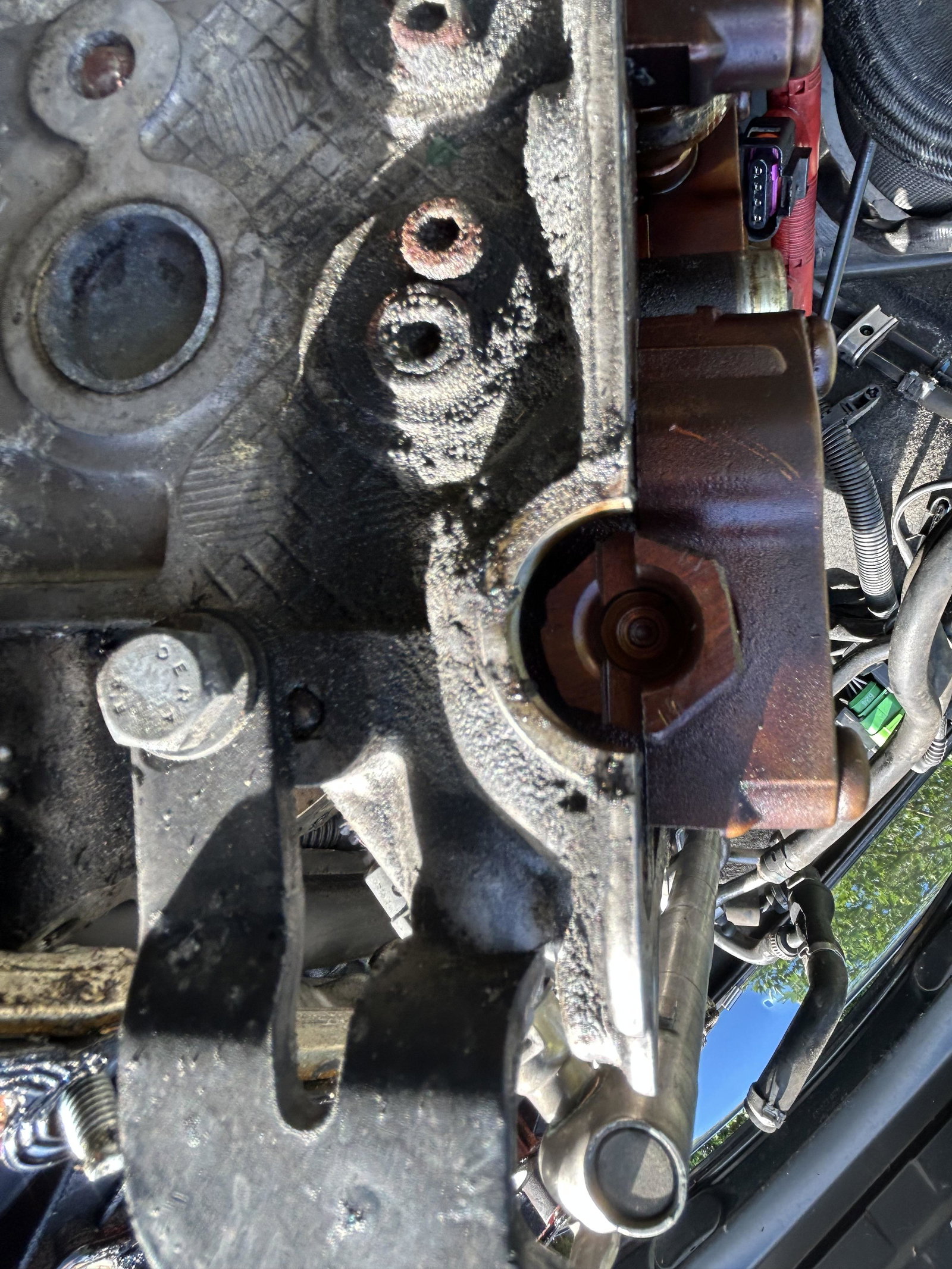

Moz18 Posted 4 hours ago Posted 4 hours ago (edited) Hi guys new here! Love the site and I am looking forward to getting to know you guys! so…. I have an Audi S4 4.2 B6 that has a severe issue 😔 car had random misfire on both bank and a camshaft fault. Confident it was timing chain I decided to do a compression test… all cylinder came back around 195 psi apart from cylinder 2 & 8 which were both 0! I have pulled the intake manifold so i could see the intake valves and on both cylinder 2 & 8 it appears 1 valve on each stays open a tiny bit? Any ideas what could be the cause? Here is a couple of photos of bank 1 cam shafts which seems out of time abit if im correct? thanks in advance!! Edited 4 hours ago by Moz18

cliffcoggin Posted 4 hours ago Posted 4 hours ago The timing chain has jumped a sprocket tooth as a result of stretching or collapse of its tensioner. When that happened at least two valves hit the piston crowns and bent the stems, hence they will not retract fully. As if that's not bad enough there is a chance that the conrods have also been bent by impact with the valves, so you could have a very expensive repair bill ahead of you. Timing chains don't fail abruptly. They give plenty of warning by way of chain slap before something serious happens, so I believe the growing problem has been ignored for a long time.

Magnet Posted 3 hours ago Posted 3 hours ago So it’s head off then, and replace at least 2 valves - they don’t stick if they aren’t slightly bent. New timing chain and associated components. Refit everything and keep fingers crossed that the work and expense has resulted in some sort of rectification. How do you value this 20 year old car Mark, when you have it back in reasonable working order?
