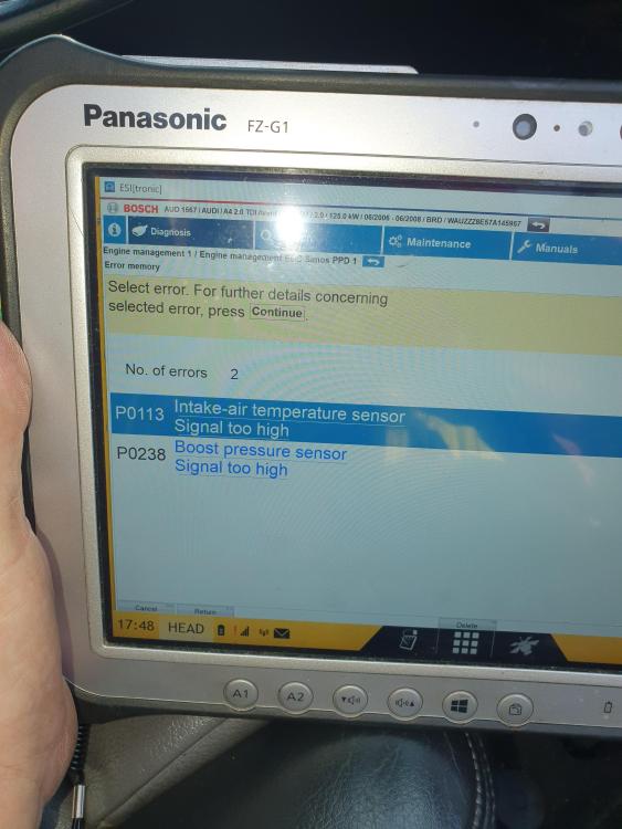

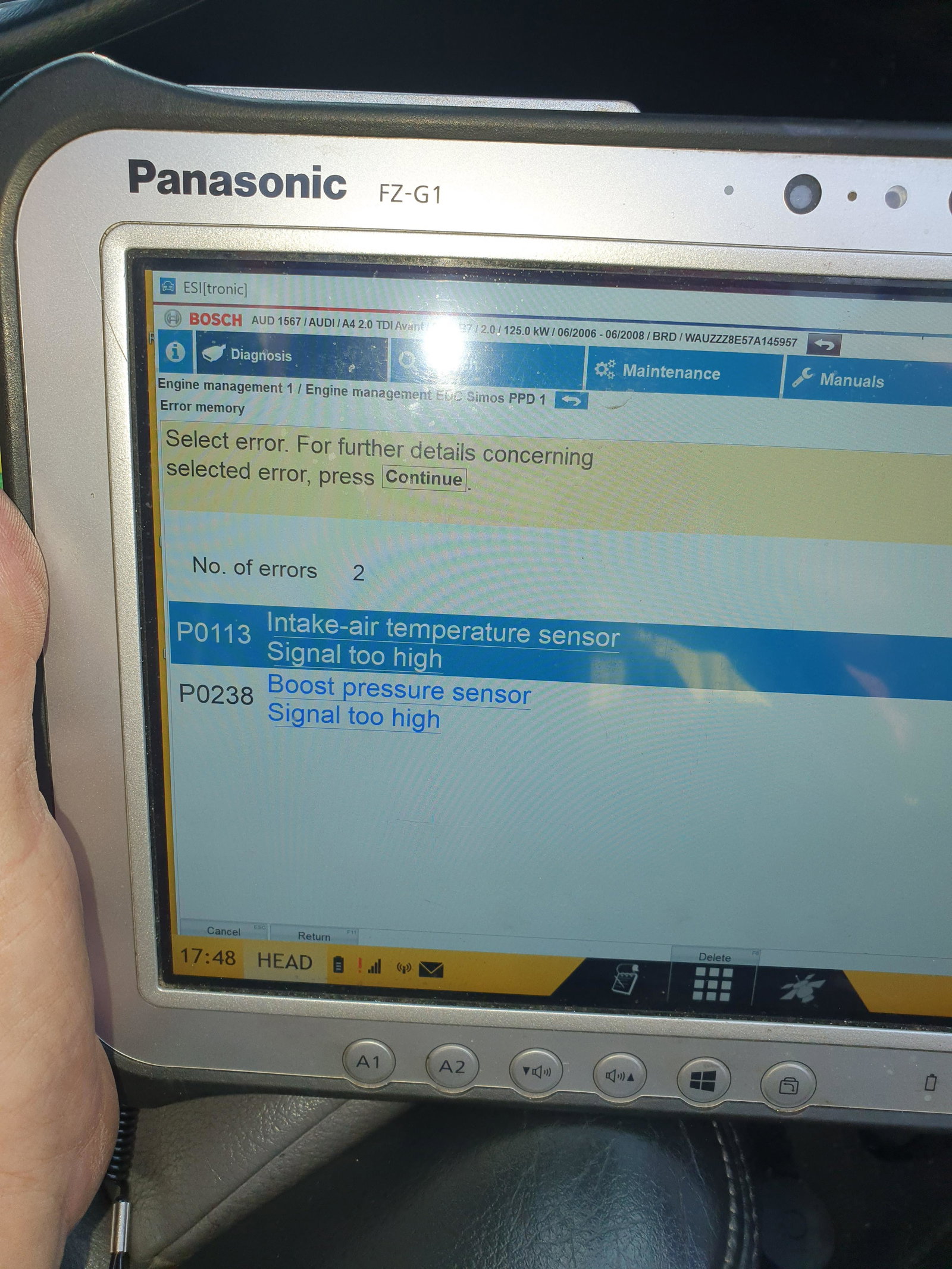

Had it plugged in numerous times only fault code that shows is P0113 intake air temperature signal too high and P0238 boost pressure sensor signal too high hence changing MAF and Map sensor.
Clear codes runs the same with no faults showing untill we start unplugging again.

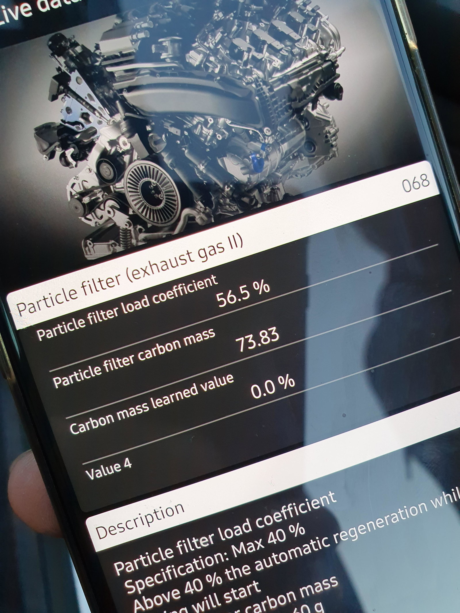

Just took it for a good thrashing with fresh fuel down the motorway.  DPF light came on so thought I'd try clear it. Usually goes within 15 minutes at 2500rpm yet this time stayed on for 30 mins at least. Gave it some welly off the slip road and boom started running fine with low rpm now back to how it was. DPF light still on so carried on but can't get it too clear.
The car was intermittent going good to bad throughout this (approx 60mins) found when I floored it it would pick up again yet DPF light still wouldn't clear.
Got home plugged it in and the readings are as follows in picture. Now I had garage check the DPF and they said it was fine and didn't need a forced regen yet OBD eleven is saying max capacity at 60% yet mine is high 70's. Not too clued up on DPF's but could this be an issue of loss of power and would it be intermittent? Going to get my local DPF cleaner to look at it tomorrow. No other known faults showing so hoping uts a case of a clean or delete and job done. Will keep you posted
Thought I'd drop an update just incase it helps anyone else in the future.
Final cause was the DPF. Wasn't showing any fault codes but was blocked solid.
New DPF and temp sensor, a good Italian tune up to blow all the !Removed! out of exhaust and it seems good for now.
Will keep updating but as far as now its 100% DPF.
Current cost is £1250 with a the parts I've fitted so fingers crossed its good for a few years yet.
