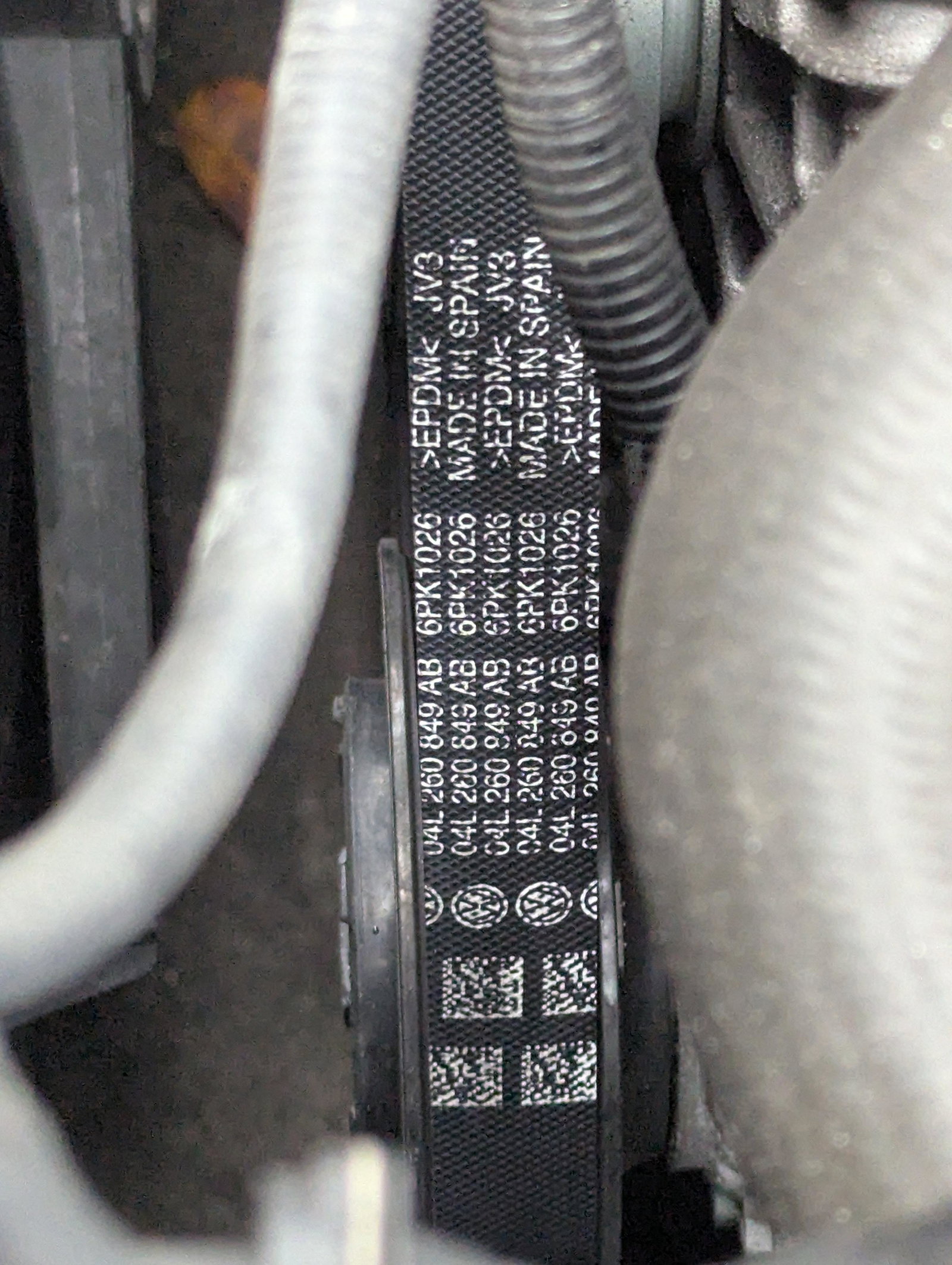

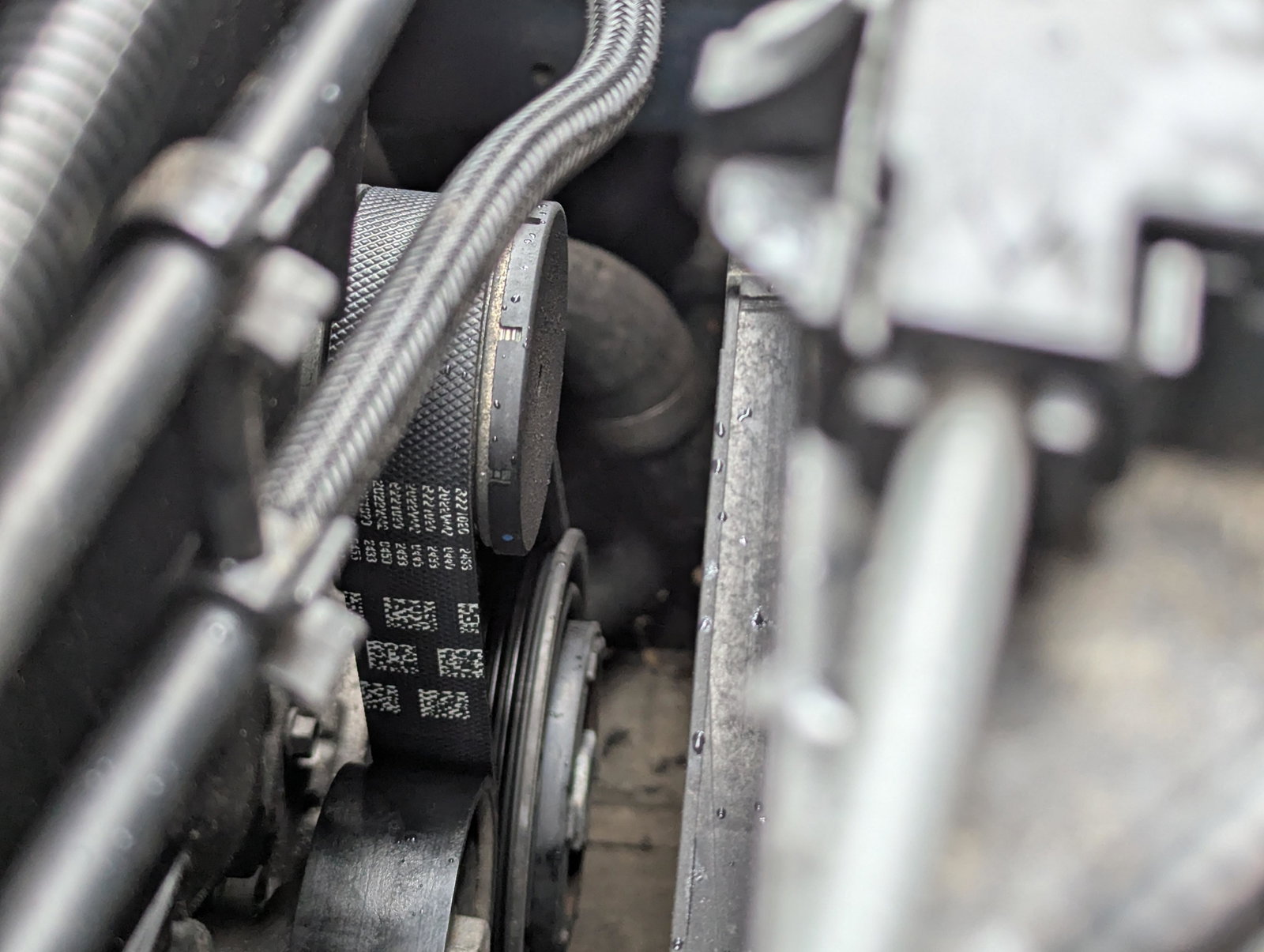

Was working through my service history from my recently purchased 2017 A5 when I discovered that the VIN number the on the invoice and mileage did not match my car. The works that were carried out in this invoice included a timing belt and water pump change in mid 2023
The independent dealer has assured me this is just an error on the Audi invoice. Are you able to help me identify if this timing belt is the original when the car was manufactured in 2017 or a new belt changed in 2023. Thanks in advance

Hello Matthew,
The prefix number 6PK is used by Gates, but maybe used by other ‘aftermarket’ suppliers as well. If it is Gates, then it’s a reputable make. The problem is that Audi were/are? using Gates belts at the factory, and also in their replacement kits bought from the main dealers. The the answer to you question remains difficult since it could well be the original belt, or it could be a replacement Gates belt fitted to replace the original!
Having said that, it does look newish from the photo, but….?
Does your independent have access to record onto the VAG computerised service system? If so, what is recorded there?

p.s. Gates often has a use-by date on the box included in the VAG kit (usually 4 years on) so if all fails, it might be worth passing this passed Gates Technical for an opinion.

Thanks, the car has only 40k miles on it so it's hard to know if the belt looks new because it is new or just hasn't been used that much with the low mileage on the car. I see that there is now no time limit on replacement on belts so it might not be that big an issue anyway. Thanks
