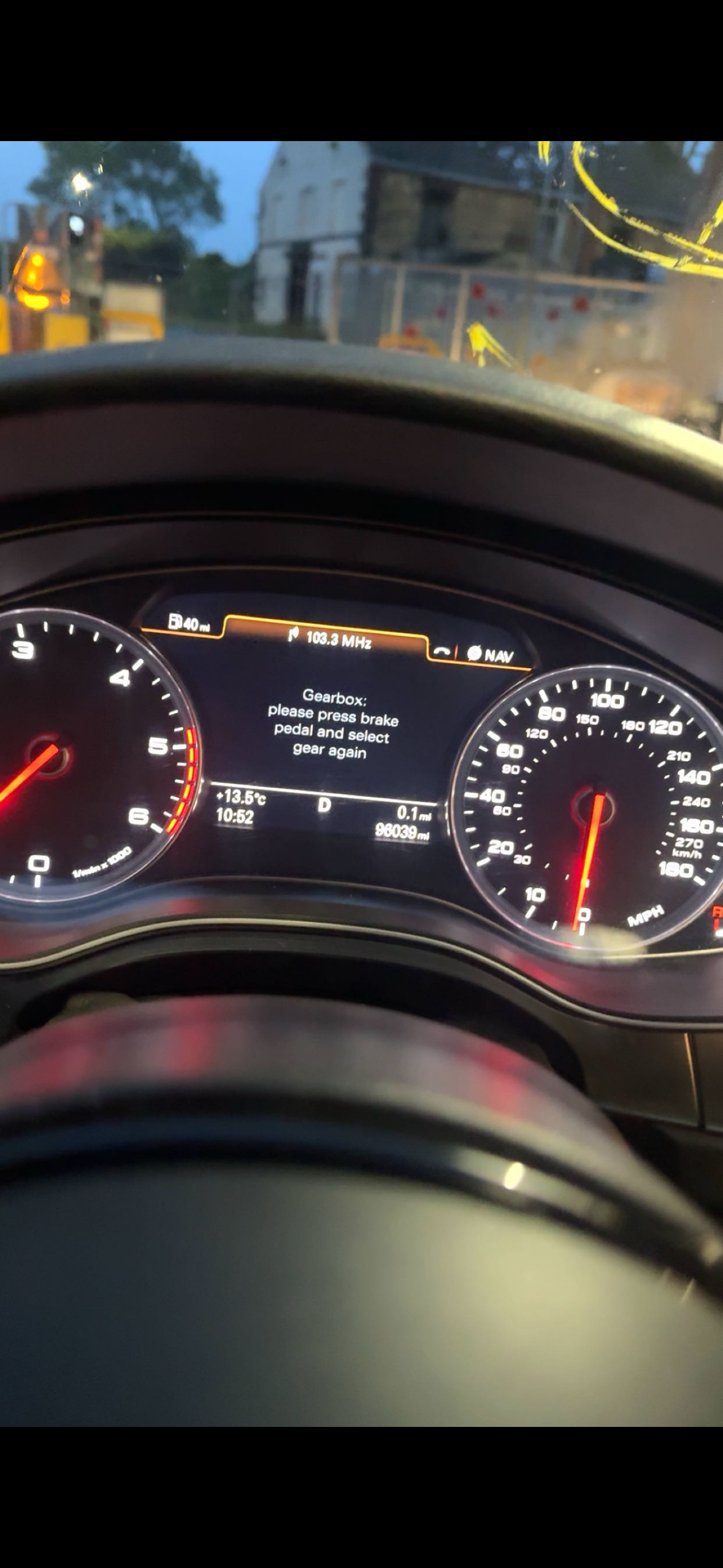

Hi I have recently purchased a Audi a6 (c7) 8 speed automatic, when I drive the car it will stop and a message comes up and says press the brake and select gear again it only does it when driving slow but drives normally after 15mph could anyone help me or give me some advice on what the issue could be

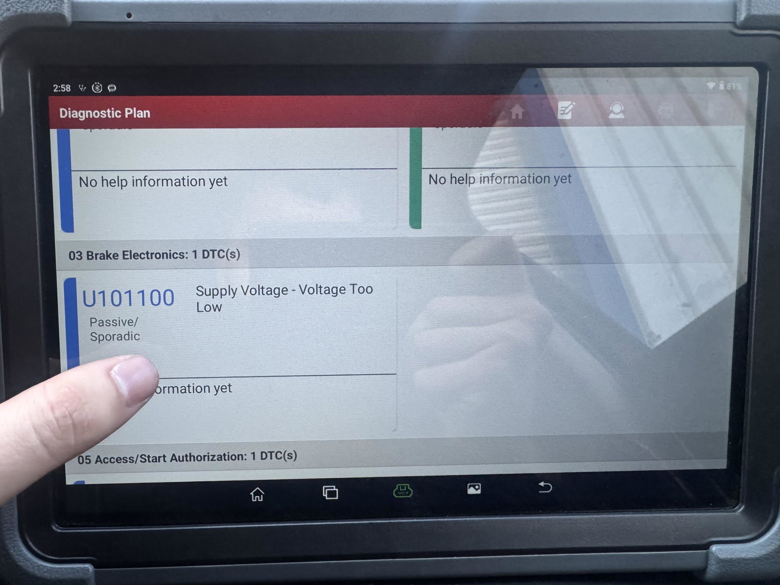

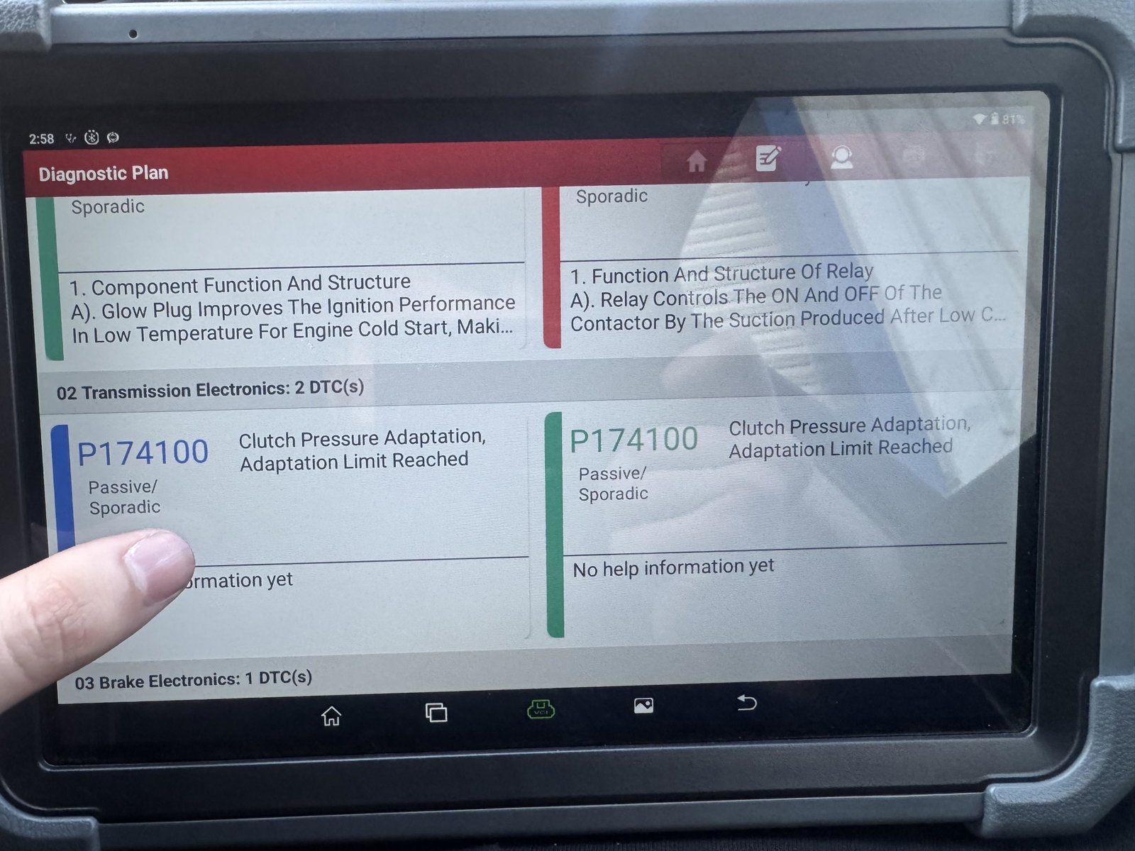

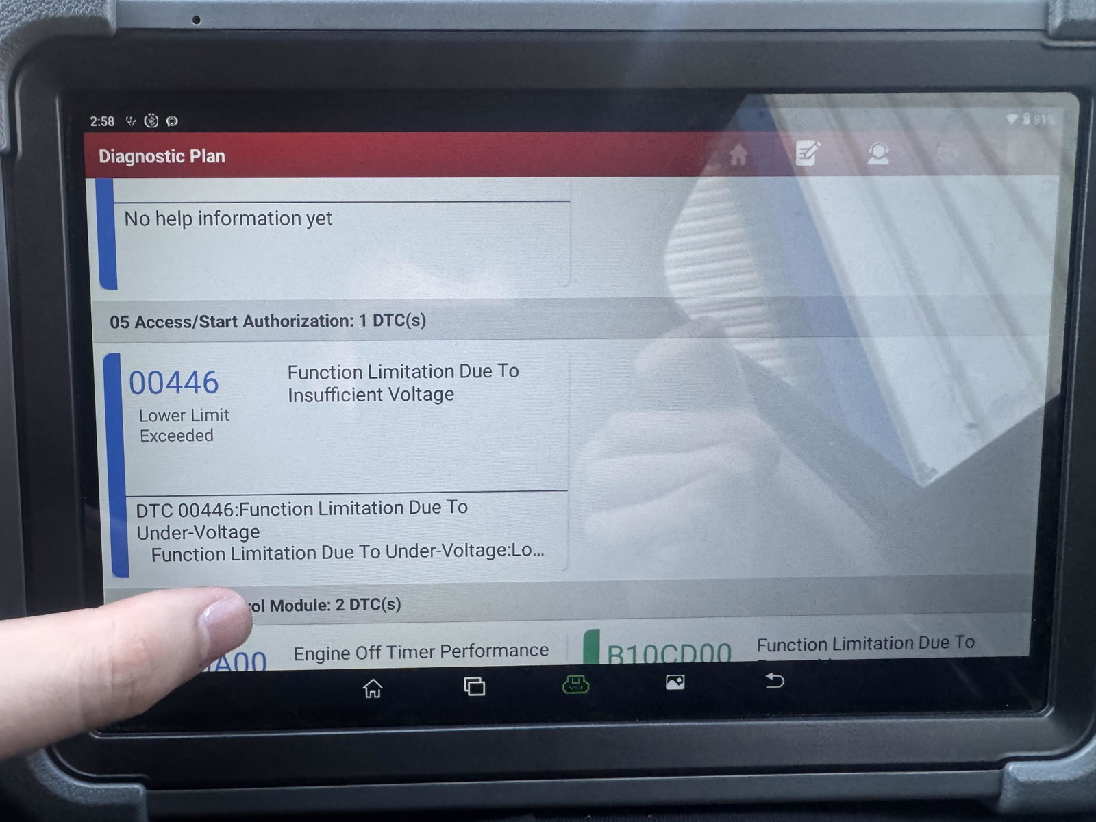

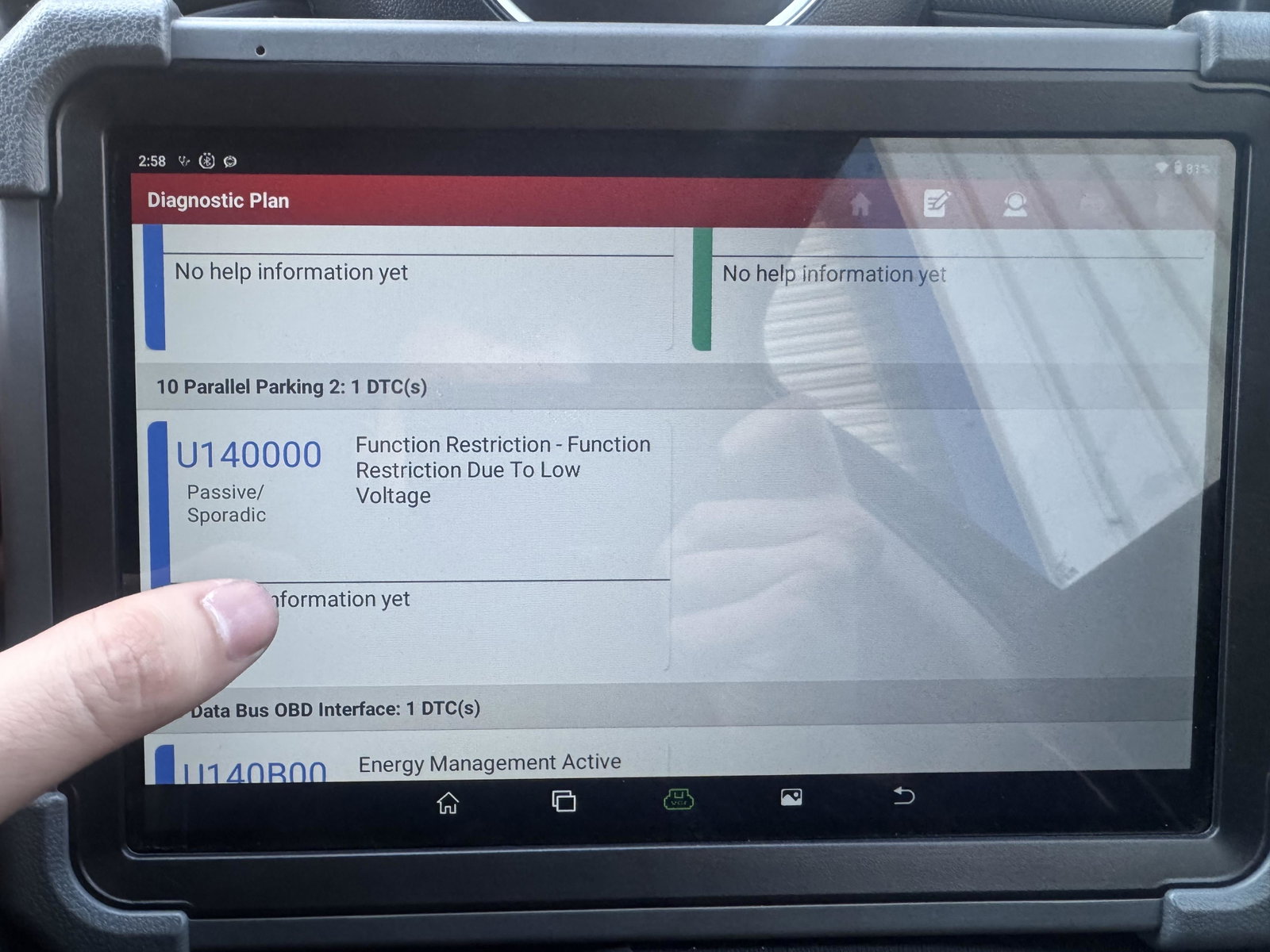

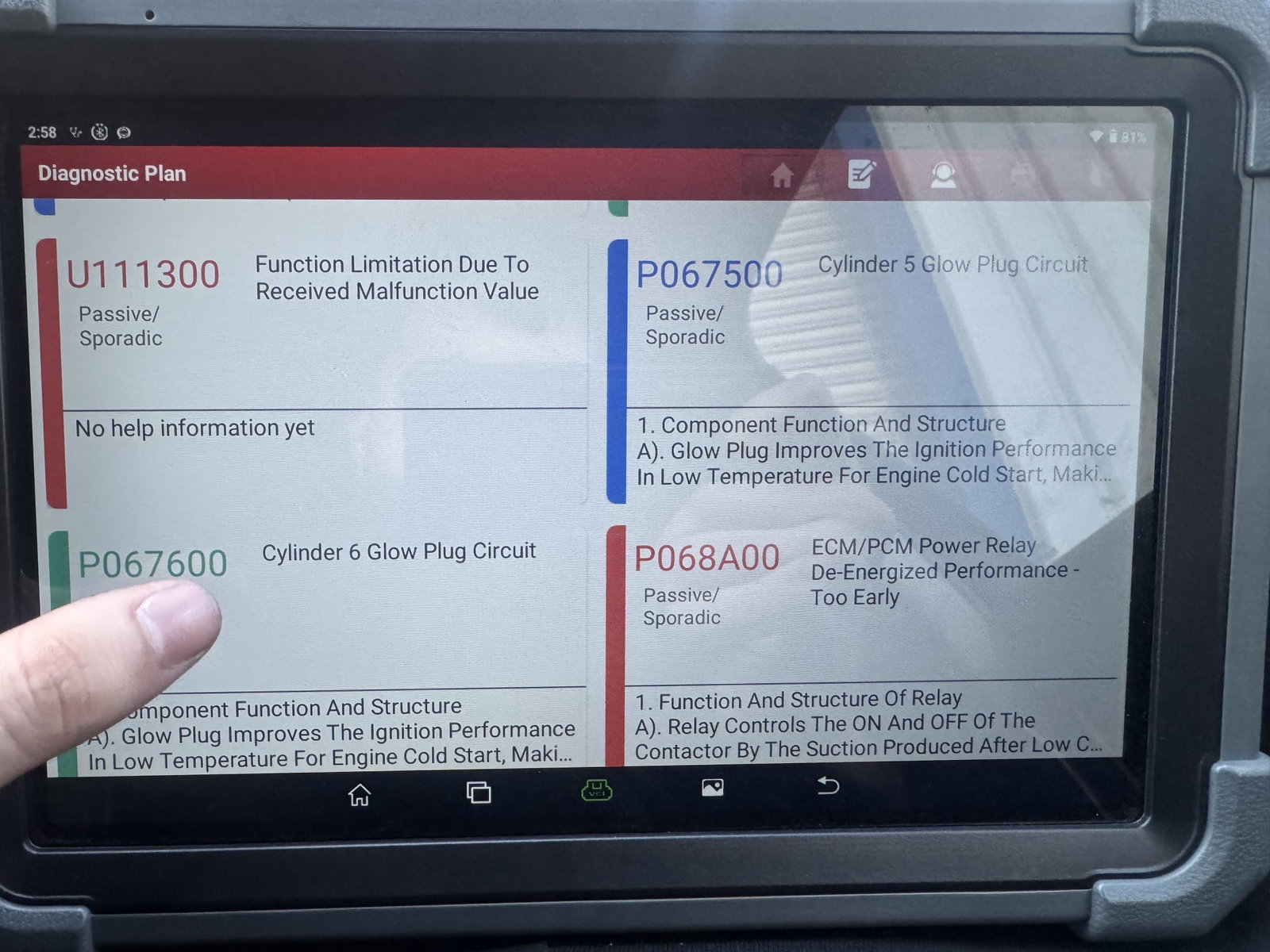

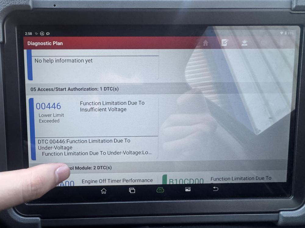

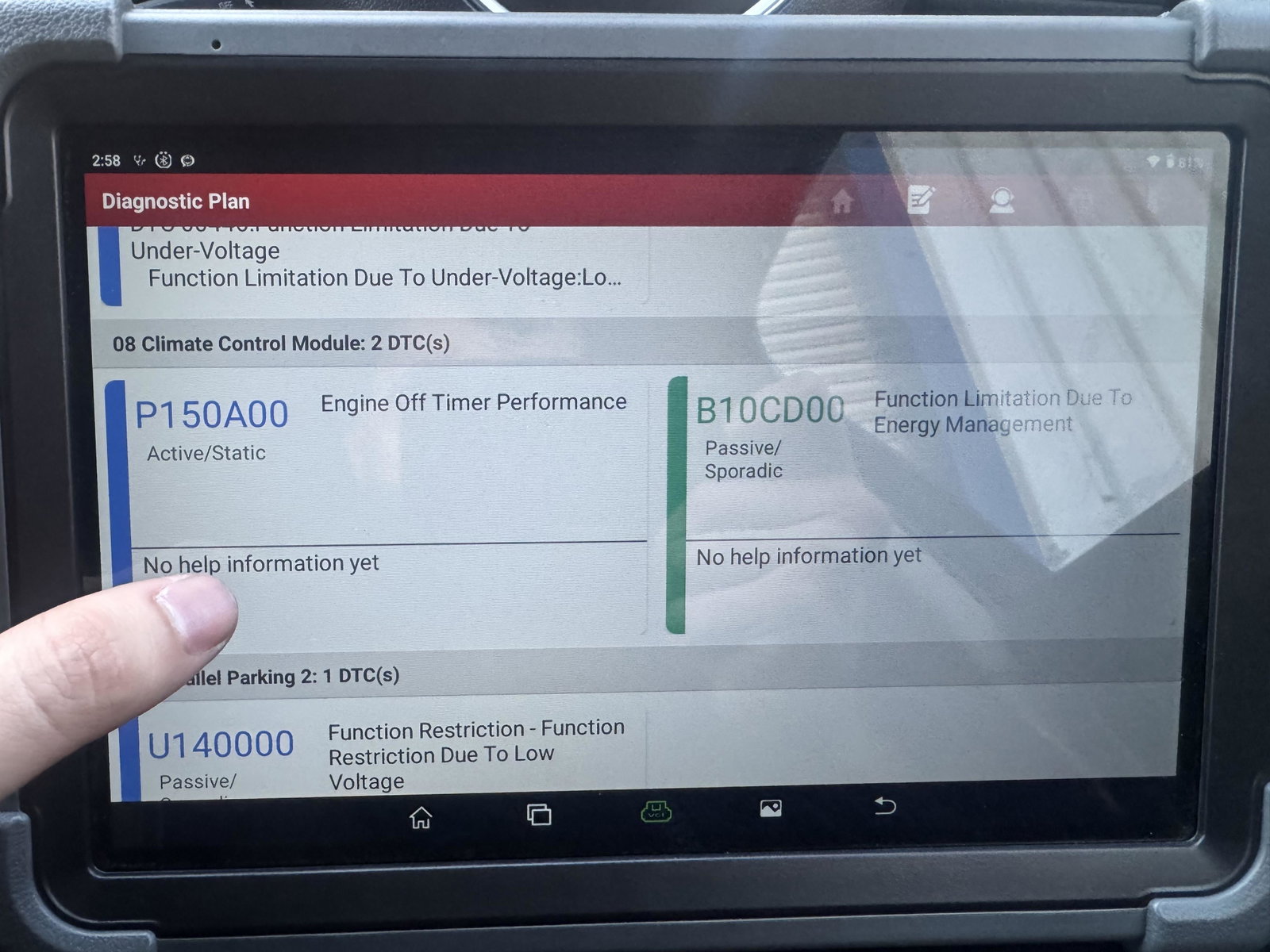

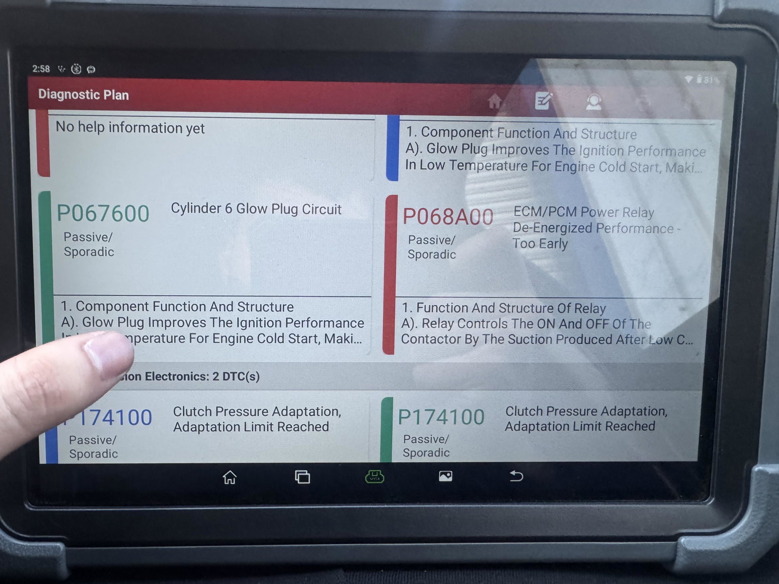

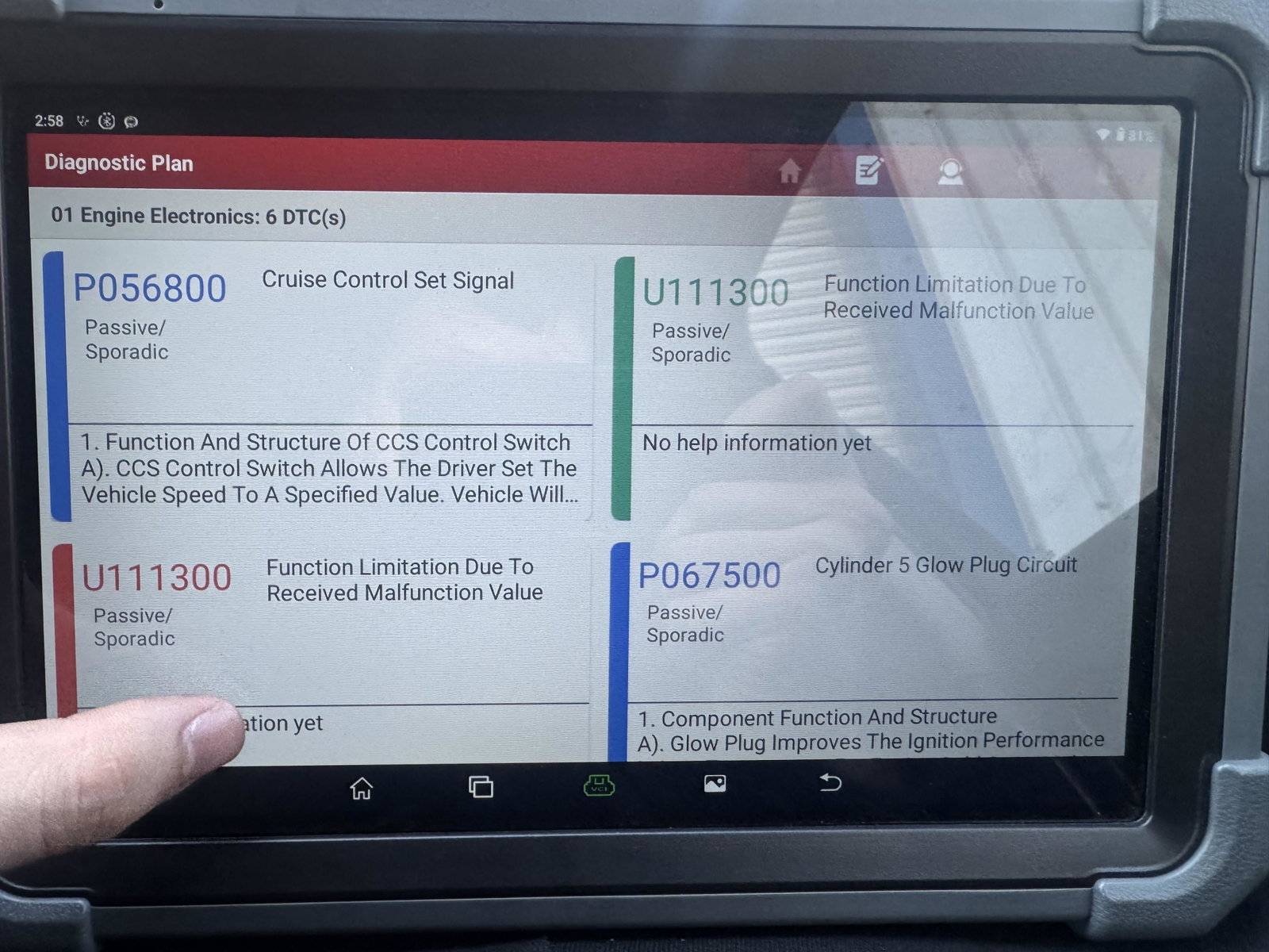

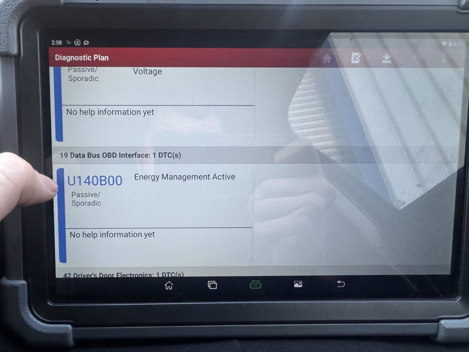

That’s the codes I’m getting
