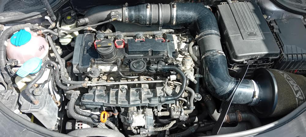

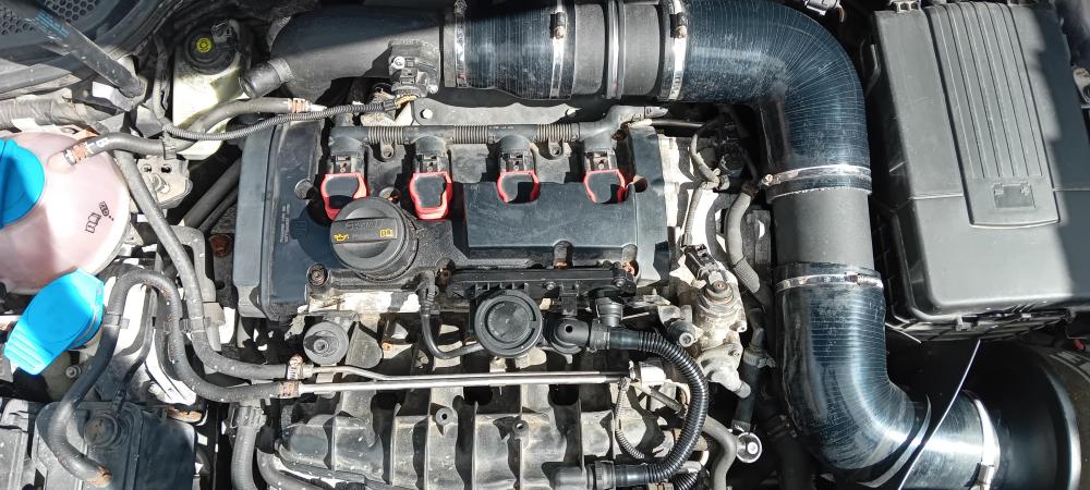

Hi Guys,
Any ideas on where i can find the oil switch sensors on this engine i must be going blind
Pic 2
