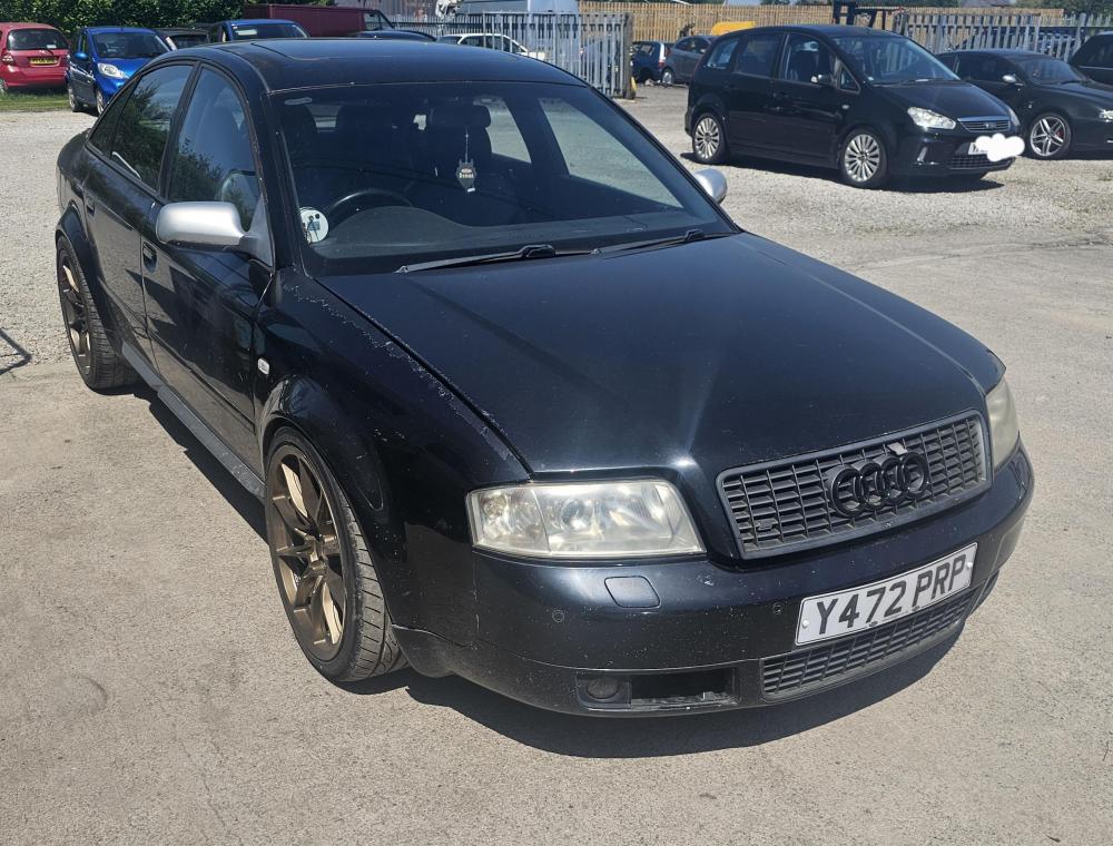

Audi S6 track car build
Ok, after completing the gearbox swap and driving the car for a few months, things have started to fail. The speedo doesn't work, even after putting in a speedo pickup in the gearbox, sensor and repairing the wiring. The electric windows all stopped working. The central locking won't work. The airbag and abs light work as they please.

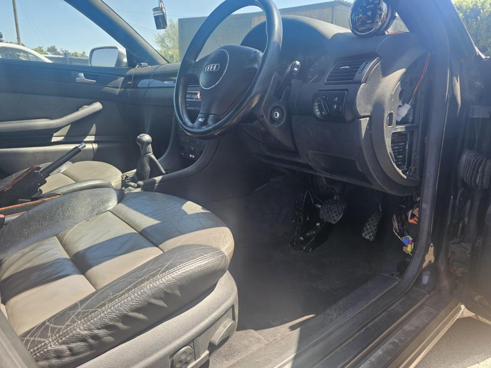

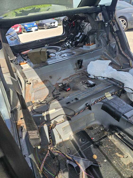

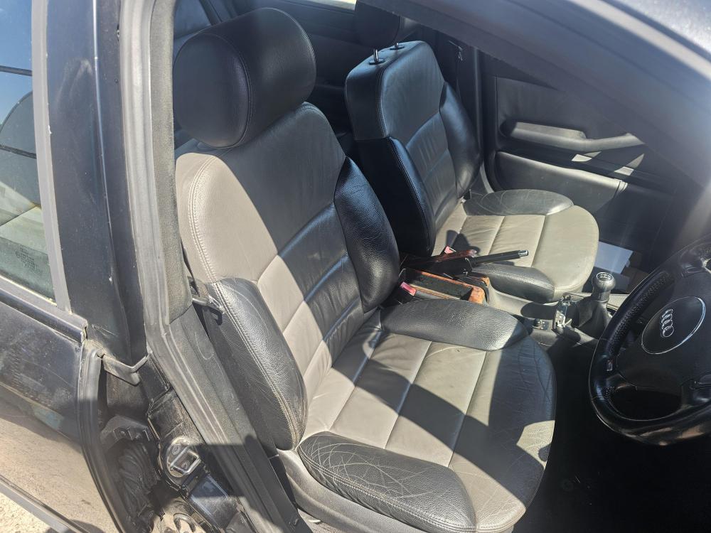

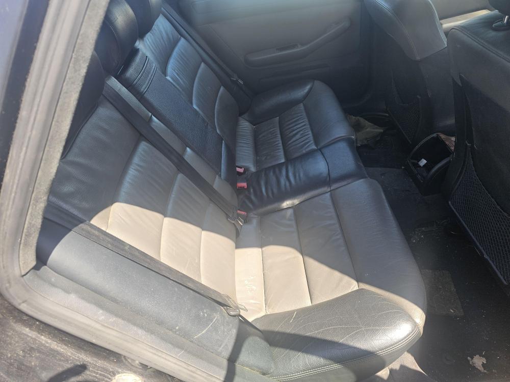

My next step is to strip it and turn it into a track car. I know they are not known for being great on a track, but I will try anyway. The seats are very heavy, so they were first to go, followed by the carpet and now the wiring is being stripped back to bare essential wiring only.

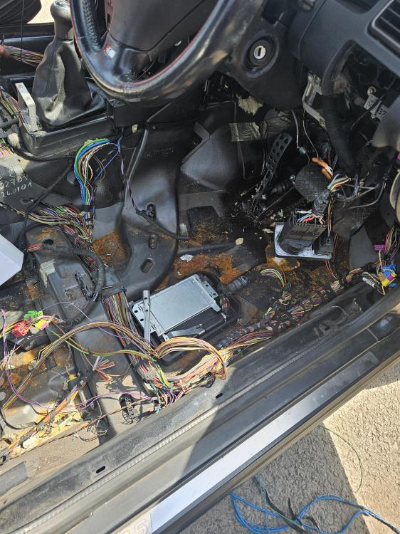

More interior removed, it still starts too, dash out next to remove unwanted wires and control units. On a plus side, the original issue has been found, a corroded plug behind the dash probably caused its issues.
The ccm is out, all wiring will be removed and start from scratch. The windows will be ordered next week, the ecu will be ordered next week.

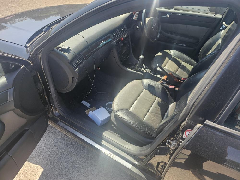

Just a small update, while waiting for the ecu to arrive, nearly all wiring that is not required has been removed. The ecu will go behind the glovebox as thats where the engine wiring will come through. The column switches will probably be removed, as the new switches will be on the new steering wheel.

It's interesting to see behind the dash of a c5. Great work so far! Who's the supplier for your stand alone ECU? And how will hat affect the imobilser?
The ecu will be a haltech if it arrives, the immobiliser will not be there, as its not got one in the ecu.

So the seats look like they're from an allroad. The wood is darker than mine. Sorry to hear the ECU is missing. Hope it's found soon!
